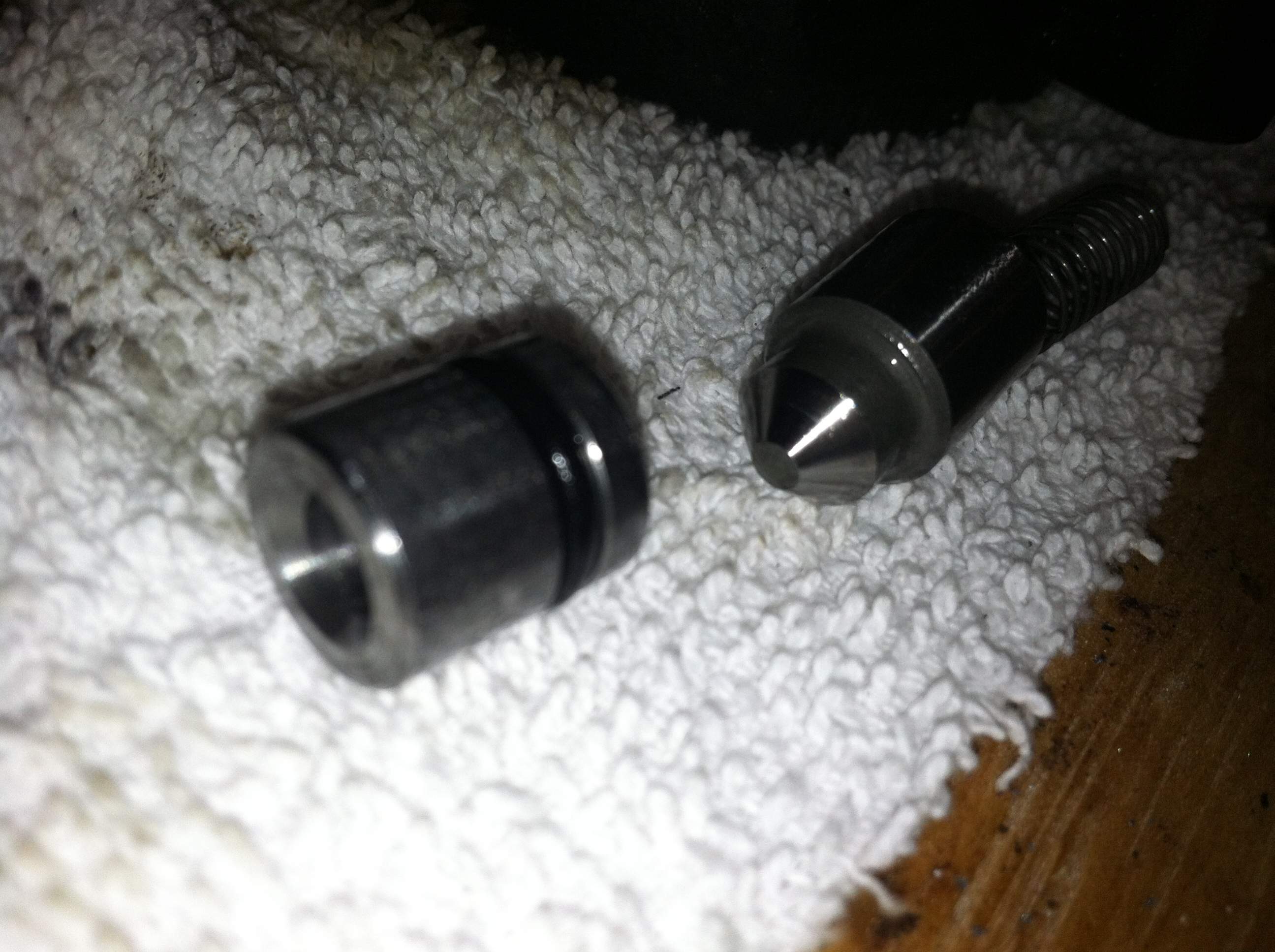

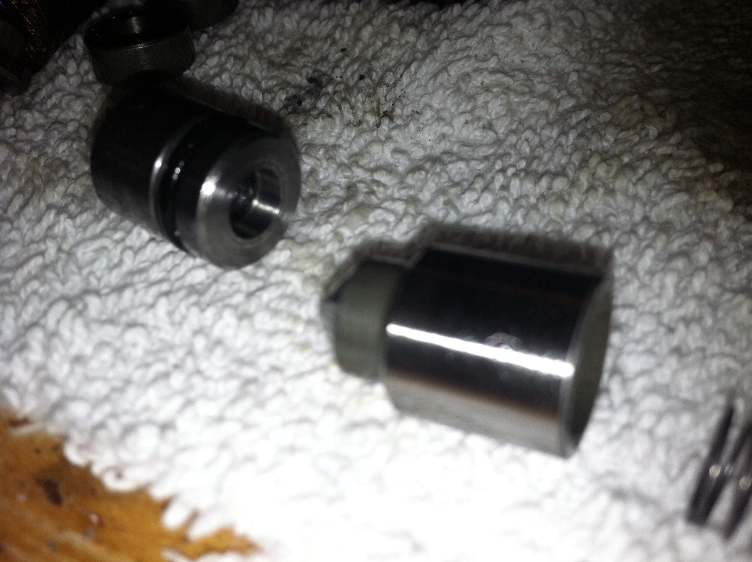

I removed my MLS valve and tore it down according to the shop manual. I didn't really find anything in it. It's just clean oil in there. I did notice the following things that I attached pictures of:
1. the first picture is of the pilot spool. In the manual it says "orientation of balancing passage in one end of the spool is very important. This balancing passage must be assembled facing towards the cap of spool valve"
I removed the spool just like you see it in the pictures. It looks to me like the holes in the side of the spool may be a "balancing passage" and that the spool is in backwards? But that wouldn't explain why it would quit working all of a sudden.
2. the next two pictures are of the valve seat and pilot valve. It looks to me like the valve seat has the machined angled face machined on the wrong side of the seat. The valve is conical and sits on top of a spring in the bore. The seat has an oring that has to go oring first into the bore or the oring won't seal anything. Then the end plate holds it in there. The surface where the valve seats against is a square edged hole that isn't really machined, just drilled through the seat. The other side of the seat that sticks out of the valve and nothing at all seats against it is a machined angled face that fits the valve angled face perfectly although when assembled they don't touch. Look at the pictures carefully. That's how they came out of the valve. It looks like the seat has the seat face machined on the wrong side or the oring groove is machined on the wrong end. One or the other. But that doesn't really explain why it quit working all of a sudden either.
Any help? I must have done something because after slipping that mls valve back in it doesn't do anything now.

The problem you described is normally foreign material in the MLS Valve. If you have loader control and Rear Remote Power, you really isolated the problem to the MLS Valve. Now that nothing works probably means you have something a little goofy when the valve was re-assembled. With these things, it's best to forget about what you think it should look like and re-assemble exactly the way it came apart. Since it worked fine until recently, you want it back together the way it came apart.
The Rear Remote is a selector valve in the tractor Power Beyond system. It selects between the 3-point MLS Valve and the Rear Plugs. If you have spec pressure at the rear remotes when you lever is engaged, then you will also have spec pressure at the MLS Valve when you selector lever is in neutral.
Carefully re-assemble the MLS Valve, making sure everything is clean and lightly oiled. It "sounds like" your spool is sticking.
