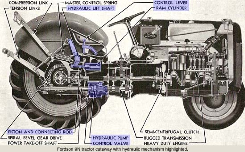

There is one hydraulic cylinder inside the transmission housing under your seat. It attaches to the rockshaft that moves the outside arms.

Yes it is hydraulic. A BIG piston that turns the rockshaft that lifts the arms. The lever on mine (JD) lifts arms to the selected point. Then there is a weird option of draft control (wish I Had). Making it even stranger acting.

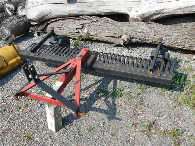

The three point hitch has no down presure, just lift. Seems to me that I saw another post about grading with a rear blade. It's pretty easy if you put adjustable gage wheels on your blade, also when using the gage wheels you can adjust the top link to fine tune the cut. Out for less and in for more. Will try and get some pics of my grading tools in here. I also turn the blade around and lower the casters to keep the blade just off the ground for plowing snow so as not to plow off all the gravel. Good luck.

No the piston doesn't have enough travel to come up thru the seat. Most tractors also have a relief system that trips when the piston reaches a pre- determined point, and stops the travel before the piston comes out of the cylinder.
   / 3 point lift--how does it work??? #9
   / 3 point lift--how does it work??? #10
Don't worry about your backside if the 3pt cylinder lets lose. I rebuilt the 3pt hydraulic pump and installed a new pressure relief valve on a 8n Ford I have and now I could really lift things. It worked good. So good, that the original 50 year old cylinder let lose with the end of the cylinder being completely blown off. It does wake you up. Sounds like a shotgun going off right under you. As mentioned, the piston has limited travel and with all the steel of the tractor case, your backside will be safe. No hospital visit required. Just a little, ah ****, and some more parts and work required.
