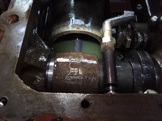

Another update, after about 5 hours I got the cover off. the cover was obviously put on before the cab..lol. I had to drill some holes in the cab to get some of the bolts up through.
So, here is what I figured out. Like i mentioned earlier I dont know much about hydraulics. With the cover off I moved the 3 point arms up and down and could see the rod moving in the piston. I put my hand in the cylinder and the rod was lying against the cylinder wall. At the end of the rod I could feel the end and it felt like there was a threaded hole there. Im not 100% sure on that but shouldnt it be connected to something? I will have to drain the rest of the fluid to see better I guess. I am hesitant to disassemble too much more at this point.
Any suggestions/ comments would be greatly appreciated. I will attach a pic.
   / 3 point lift not working #14
On 3 pt hitches the rods are never usually connected to the piston, there is usually just a ball on the end of the rod that sits in a socket on the piston, it allows the arms to float.

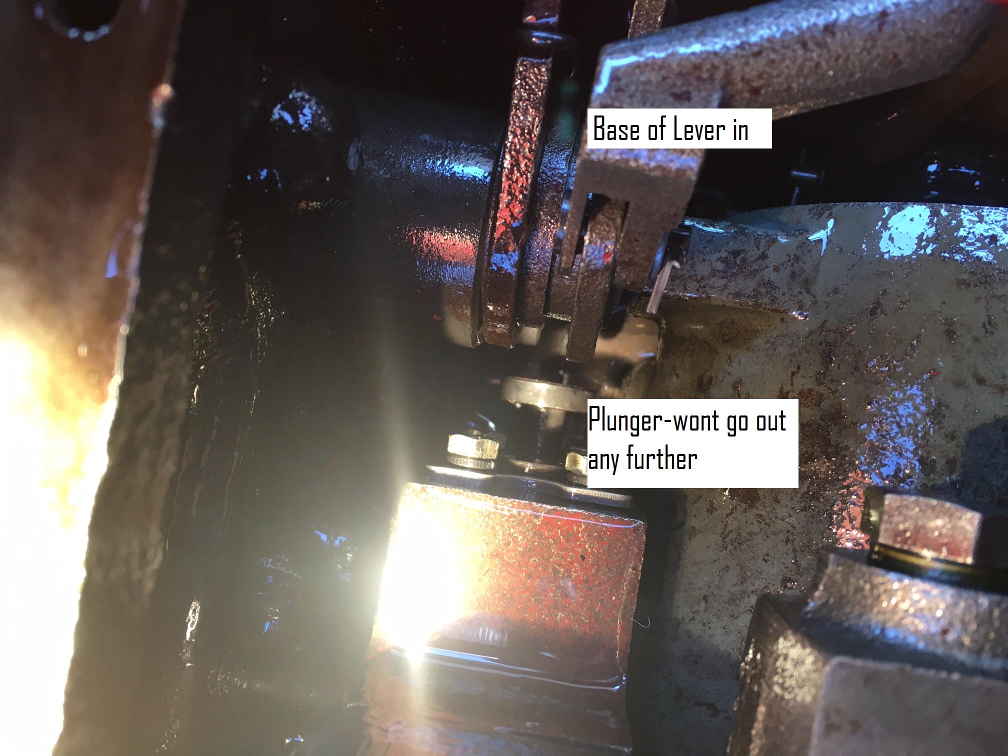

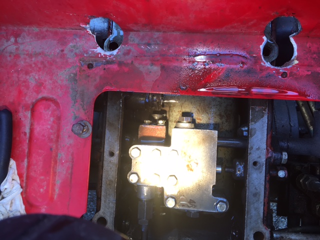

I would be willing to bet it is a control valve problem there is not much inside the 3pt hitch that can go wrong most times it is the valves or the tractor hydraulic system. Do you have a loader or any other point you can check hyd flow and pressure?

yes i have a loader so the pump is fine. Ken, from Asian tractor parts figures its probably a valve. He is really good to deal with! Gonna take it to get it checked out.

#20
I took a few pics just before I took it to a tractor mechanic. Once I drained all the oil out of it I could see that the lift lever when in the down position touches a plunger that goes in, in the full down position. When I put the lever in full lift position the plunger goes out half way. Basically from 3/4 to full lift position the lever isn't touching anything which I wondering if the plunger is stuck?? I am attaching a few pics.
