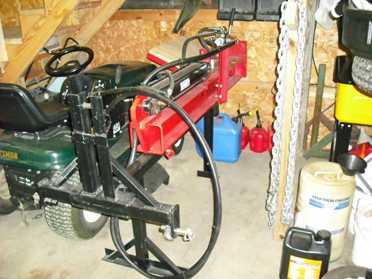

In January 2007 I built a 3pt splitter powered by a 22 gpm PTO pump. Here's a link to the writeup: http://www.tractorbynet.com/forums/...ower-take-off-3pt.html?highlight=log+splitter
I used it behing my B2910 Kubota without loader. I loved it. I'd suggest the PTO pump to gain speed.
I now use a pull behind monster splitter. It's way more powerful than my homemade splitter but the ram isn't as fast.
I see benefits to both methods. I never thought of the hours on the tractor as an issue, figured over the long haul it's cheaper than maintaining a second power source, but what do I know. :)

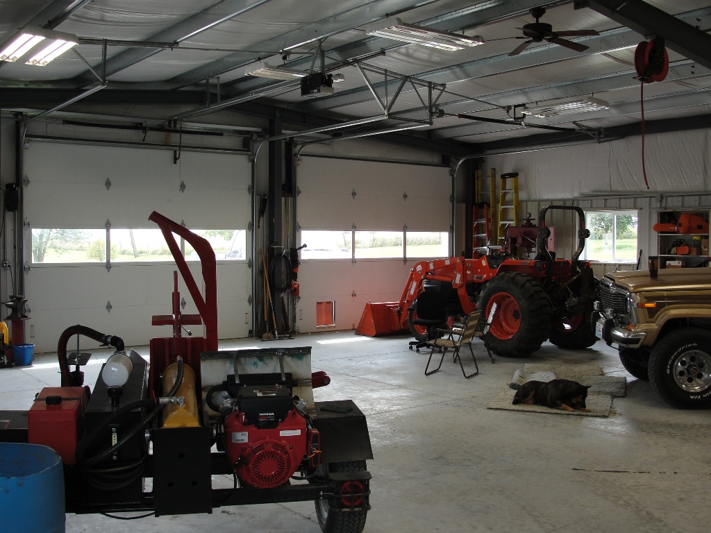

ovrszd,
Nice garage you have there, is that your personal garage or something you rent or use?
/ 3 point log splitter #27
ovrszd,

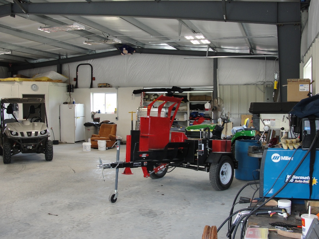

I'm very blessed with that shop in my back yard. I burned out of my old shop last winter and am getting the new one stocked. It's a Man Cave according to the wife. :)
/ 3 point log splitter #28
What was her first clue? The frig or the lazy boy? :) :) :)
/ 3 point log splitter #29
My old shop frig had a Beer tap in the side. Also had an old Koken Barber Chair. You can take some really nice naps in an old barber chair. I dreamed up a lot of great projects napping in that chair. :)

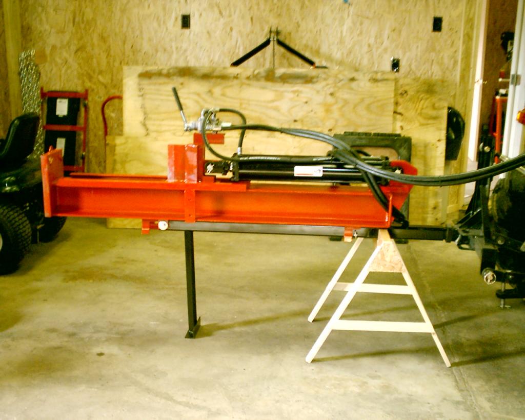

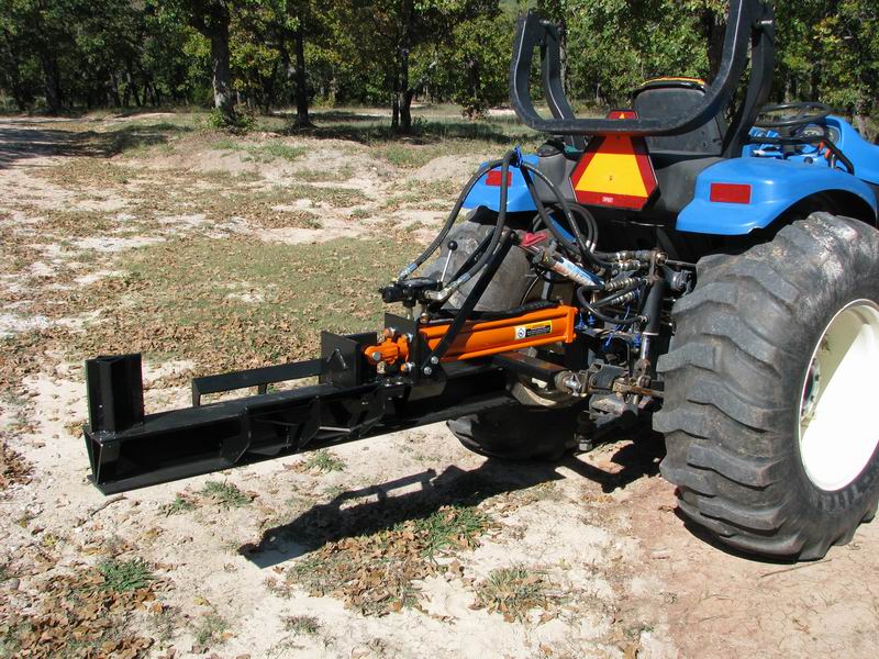

My 3 point splitter that I built myself using a 4"x24" cylinder has a 10 second cycle time. Its quicker than I can keep up with.
I made my splitter come off the tractor long ways because I usually split with a buddy and this allows unlimited access to the splitters work area. I built the whole splitter for $450 and a case of Coors Light.;) I also made a shop press adapter as you can see in one picture. You simply pull the pin on he wedge and stand up the cylinder vertically, pull the wedge, install the press adapter, and reinstall the pin.

Diamondpilot,
How many GPM are you sending to the log splitter, and is that a 4 in cyl, 2 in shaft?
/ 3 point log splitter #34
I think my tractor is 7gpm. I run the tractor at about 1200 rpm. The rod is either 1.5" or 2", not sure. Got the cylinder at Rural King for $99.
Chris

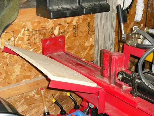

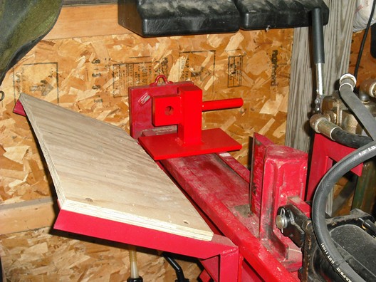

Chris, I'm old and slow and my HF 3PH splitter has no trouble outrunning me. My tractor has about 9gpm available, but I don't think I'm getting that much at the remotes even though I have 1/2" hoses. I am not an experienced splitter and when that hard blackjack oak or postoak pops as the wedge enters, it scares me a bit. I don't think I want it going much faster than it does.
My splitter has a driven/moving table attached to the ram whereas yours and most others have a driven/moving wedge. As a big round approaches my wedge, I can't see it. Also if you have a splitter that rotates vertically as yours, you have to have the table on the bottom and the wedge attached as yours is. My splitter would never work vertically without having it about 24" off the ground, negating the vertical benefit.:(

I had popping also till I sharpened my wedge. Do not use a grinder. The heat will ruin it. Use a file and take it slow. I could now cut a 4x4 sideways with the thing. Its as sharp as a buck knife and stays sharp with only a minor touch up each year after splitting about 10 ricks of wood.
Chris
