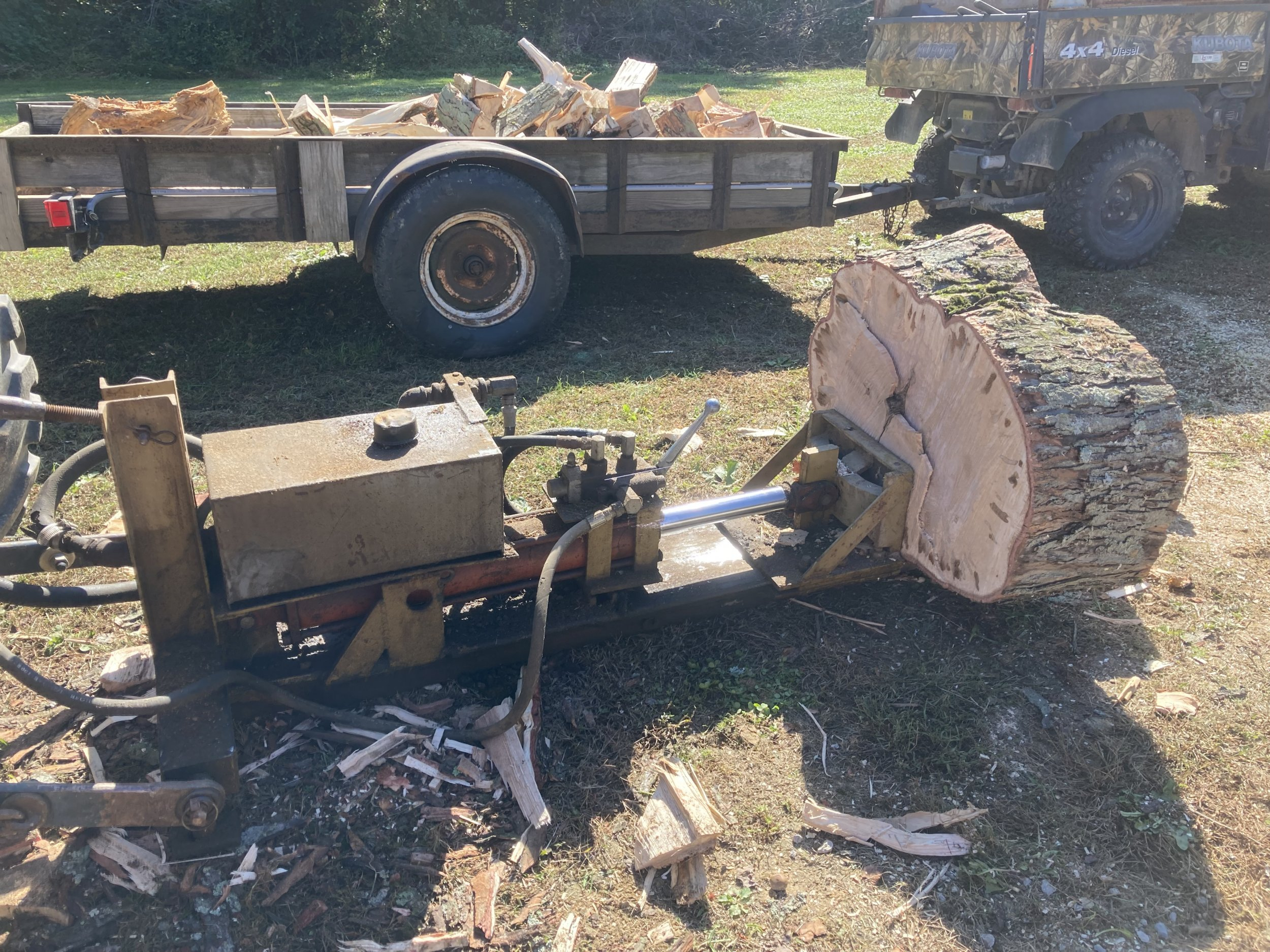

The three point splitter I made acts vertically with the "anvil" so to speak resting on the ground, or up on a cut log if I want. The reason being that if I need to split a log so large that I cannot lift it, I can walk it into position. I have split 28" diameter maple in it, It took a few passes, outer ring first then again inner ring, but it worked. I could have never lifted and positioned such a log by myself on a horizontal splitter. The other factor being that no matter how big I split, it does not fall anywhere, it's already on the ground. If my back is sore, and the logs are small, I set the anvil plate on a sawn log, so it's up off the ground 16".
I have seen commercial three point splitters which are hinged, so they would work either vertically or horizontally. If you will never split logs heavier than you can lift, horizontal splitting is not a problem...

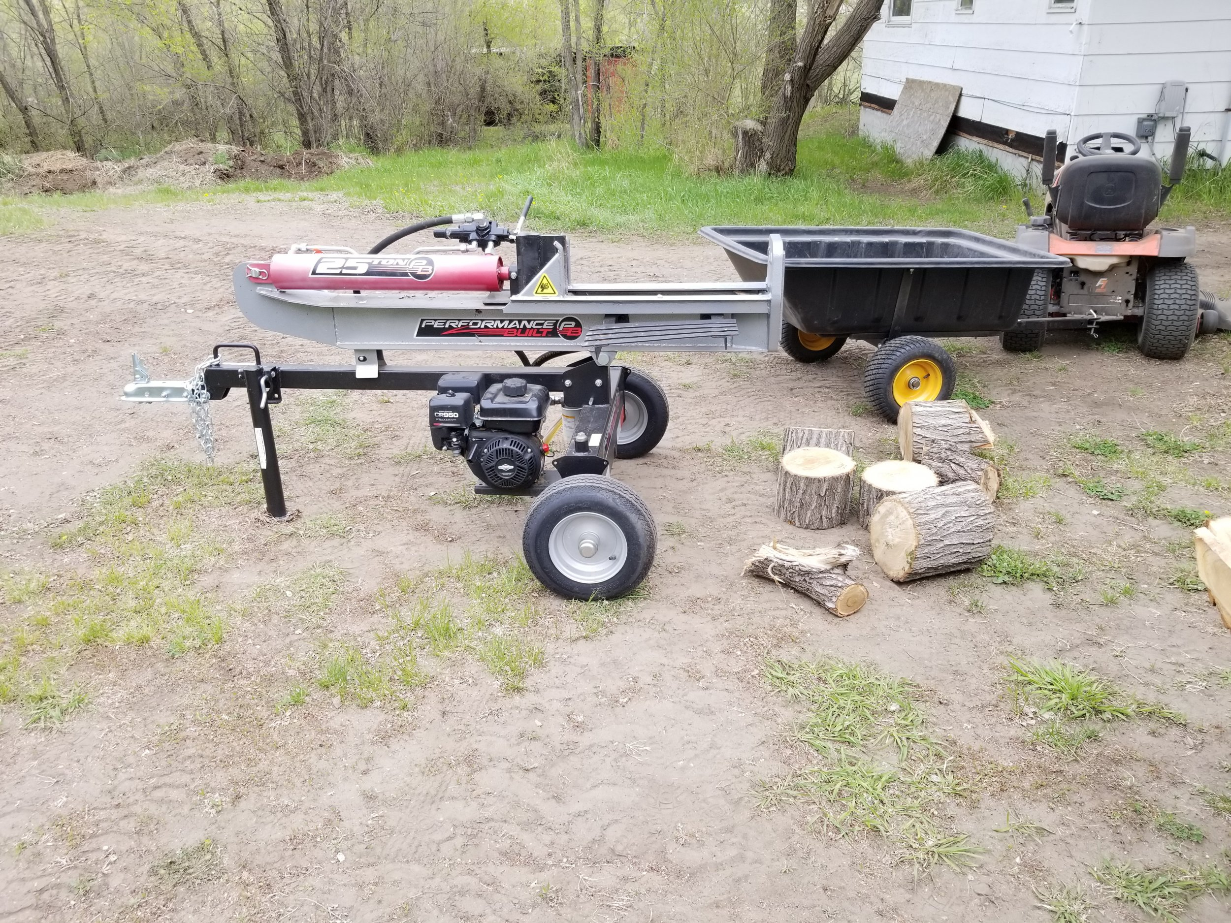

I avoided having my tractor tied up with splitter when I need to move up to 36 inch rounds into splitter (in vertical orientating) .... Bought a abused 22 ton splitter for $200 and it need carburetor for B&S engine and found out I could buy an new HF Predator (6.5 HP) engine for less ($139) than all carb parts needed for the B&S... So with new hoses and new engine and tires and using old frame and cylinder and control valve I have about $550 invested..... And I can replace motor several times cheaper than cost per hour/cheaper than the wear on tractor....
