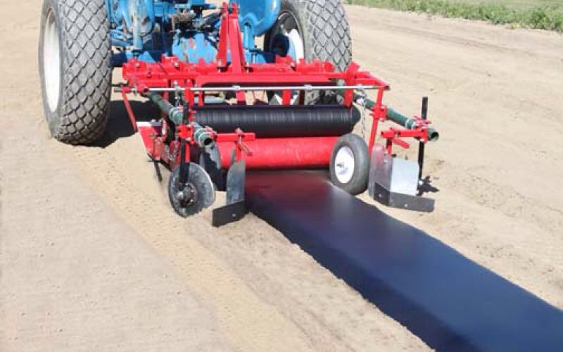

It's not lose mulch, or rubber mulch he is wanting to put down. A plastic mulch layer uses rolled plastic and makes a raised bed of dirt with the plastic laid down over it to produce a row, then you cut holes to plant your transplants. I've been debating on buying or building one also, a used one is hard to find at least around here, if you do a google search and use the images you will find all types of home built designs from simple to very elaborate ones. Here is a pic of one.

You can build a simple mulch layer and get the covering discs from an ag store on line. Agrisupply comes to mind. Just find a picture of a simple one and duplicate it. You'll spend $40 each for the covering discs and $50 each for the wheels and shanks. I've owned a few and they all were simple machines.
At auction they are sometimes hard to sell and generally don't bring a lot of money so keep an eye out. BTW, I've got a four ft wide roll of plastic for sale cheap since we sold our mulch layer as we got older.

Also make sure the distance between 2 beds is big enough so you can use a tractor in between. Or put some ground cover like strow..
Otherwise you'll have lots of work weeding between the beds by hand.. unless you spray..
The one that is used on our farm is built like follow :
- 2 potato hill disks
- 1 roll with plastic
- 1 roll irrigation tape
- 1 roll for the bed shape and guidance of plastic
- 2 wheels to hold the plastic under the dirt
- another set of potato hill disks to cover the plastic under the wheels.
Simple principle but once more.. you'll have to keep up the maintenance between the beds or you're even in a deeper mess :D
