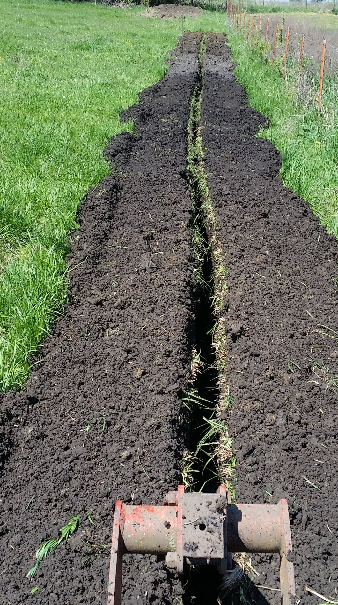

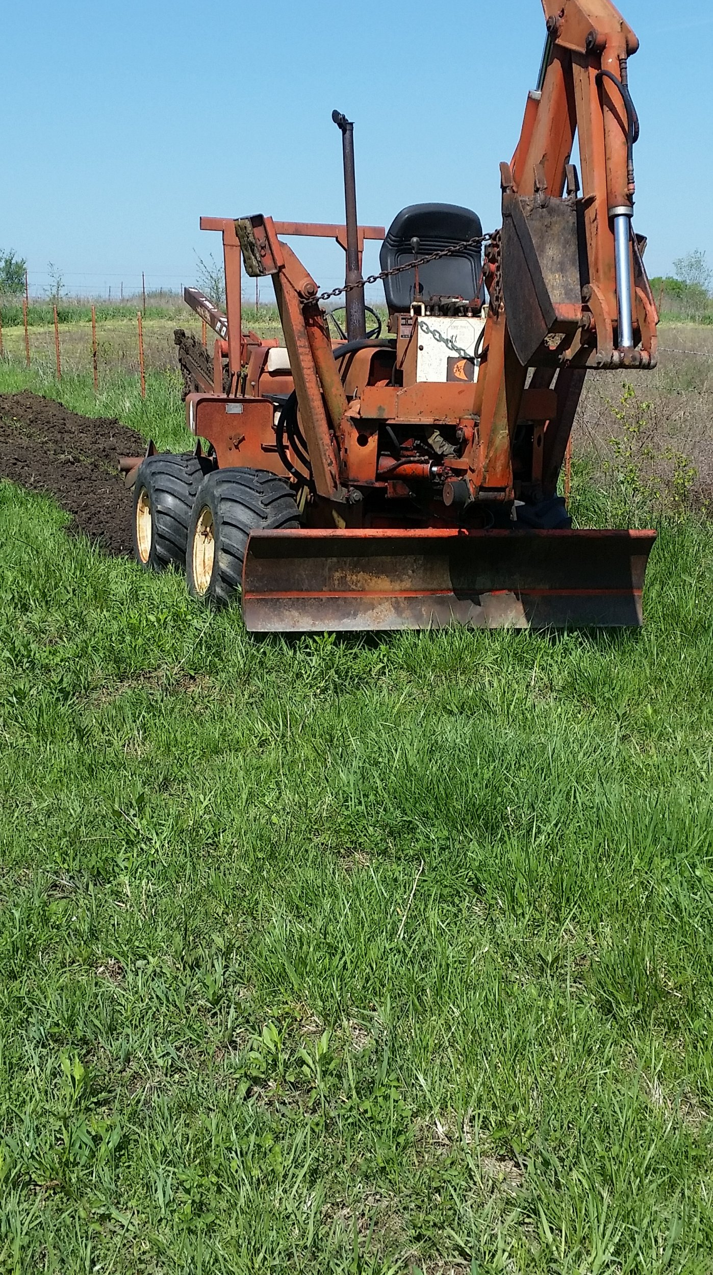

Might keep an eye open for an older trencher. I have a Ditch Witch R40 with backhoe and 6 way blade. Had a boom that would dig 6' but I shortened it because it wasn't needed. Too handy to ever part with.
I have seen a few of those for sale, prices vary depending on the shape.
That machine is on my short list.
