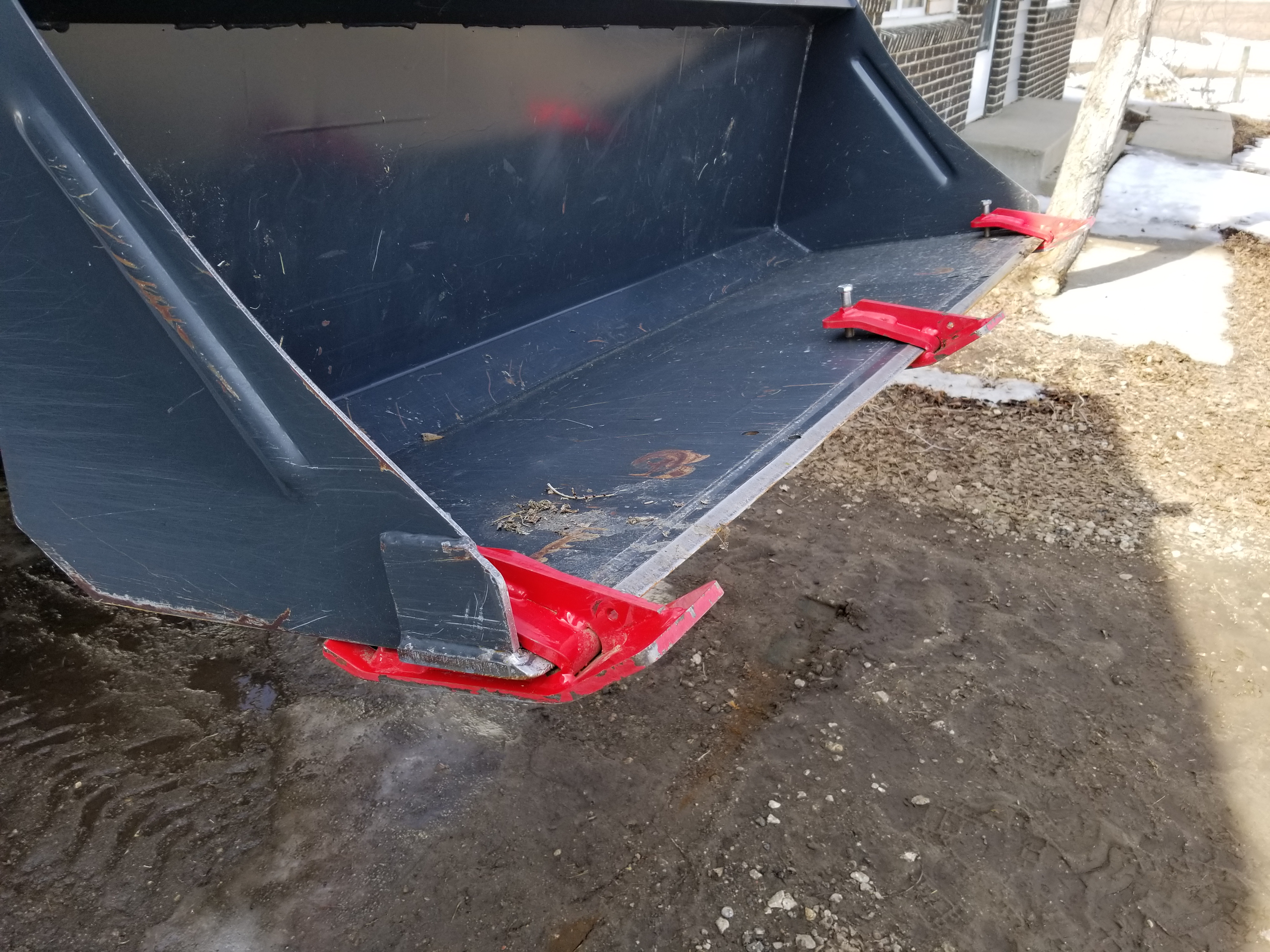

Thanks @RickB for the tips. And @ cdaigle430, what are the bucket edge tamers? I have the rest but am debating the chains. I have turfs so I壇 like to see how well they do.
These are Edge Tamers.
Here is the website to the manufacturer:
R2 Manufacturing - Home Of The Edge Tamer
The Edge Tamers allow you to run your bucket over ground that is still soft, or grass without digging in and tearing up the ground. I use them until winter freeze up freezes the ground hard here. Once our ground freezes up, it's hard as granite for the rest of the winter, and I take the Edge Tamers back off again, as they're no longer needed.

@slowpokeslim thanks for the pics of the edge tamers to clear that up.
