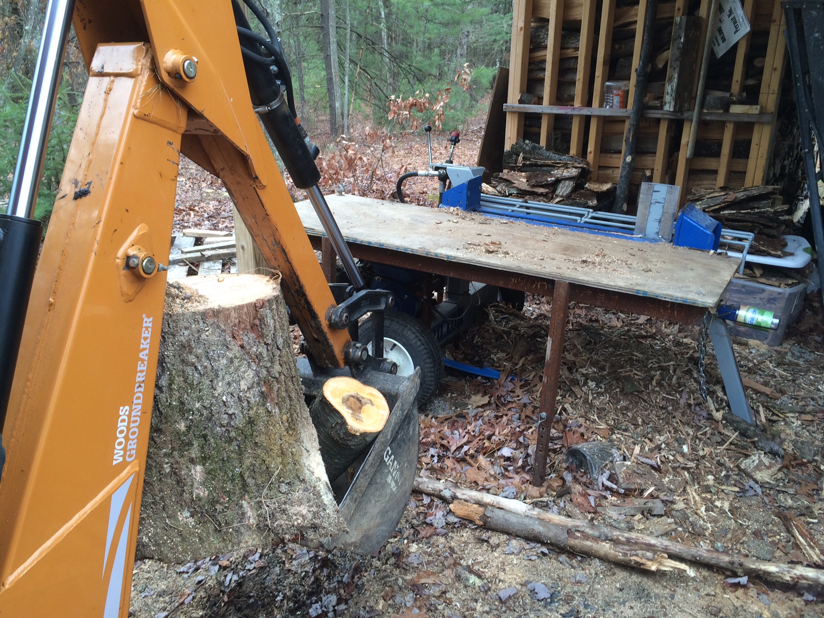

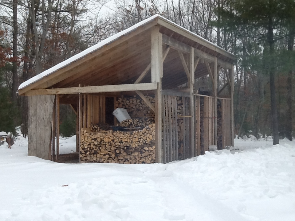

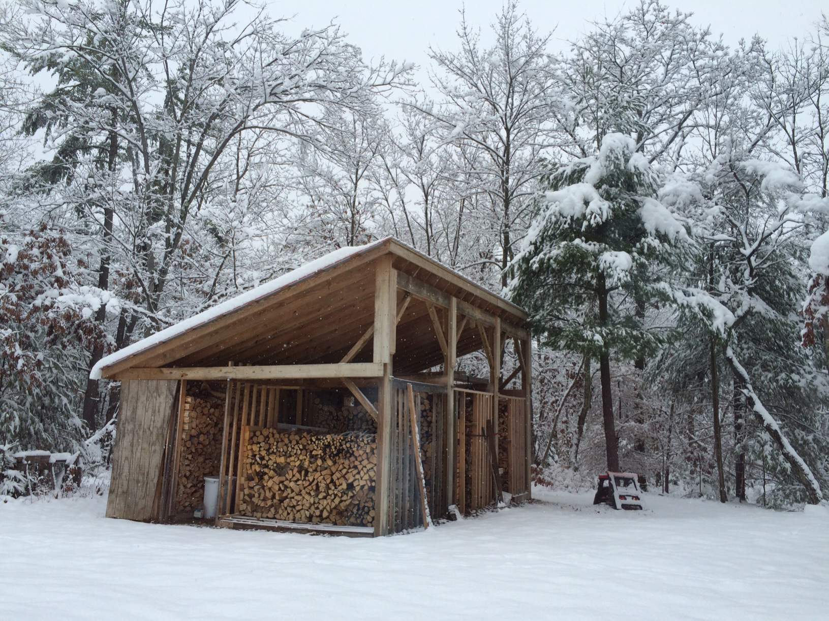

1. I designed an built a 12 by 24 pole barn/lean to wood shed sorting 3 years of wood of average burn about 30 feet away from the corner of my home where I have the stove facing du south.

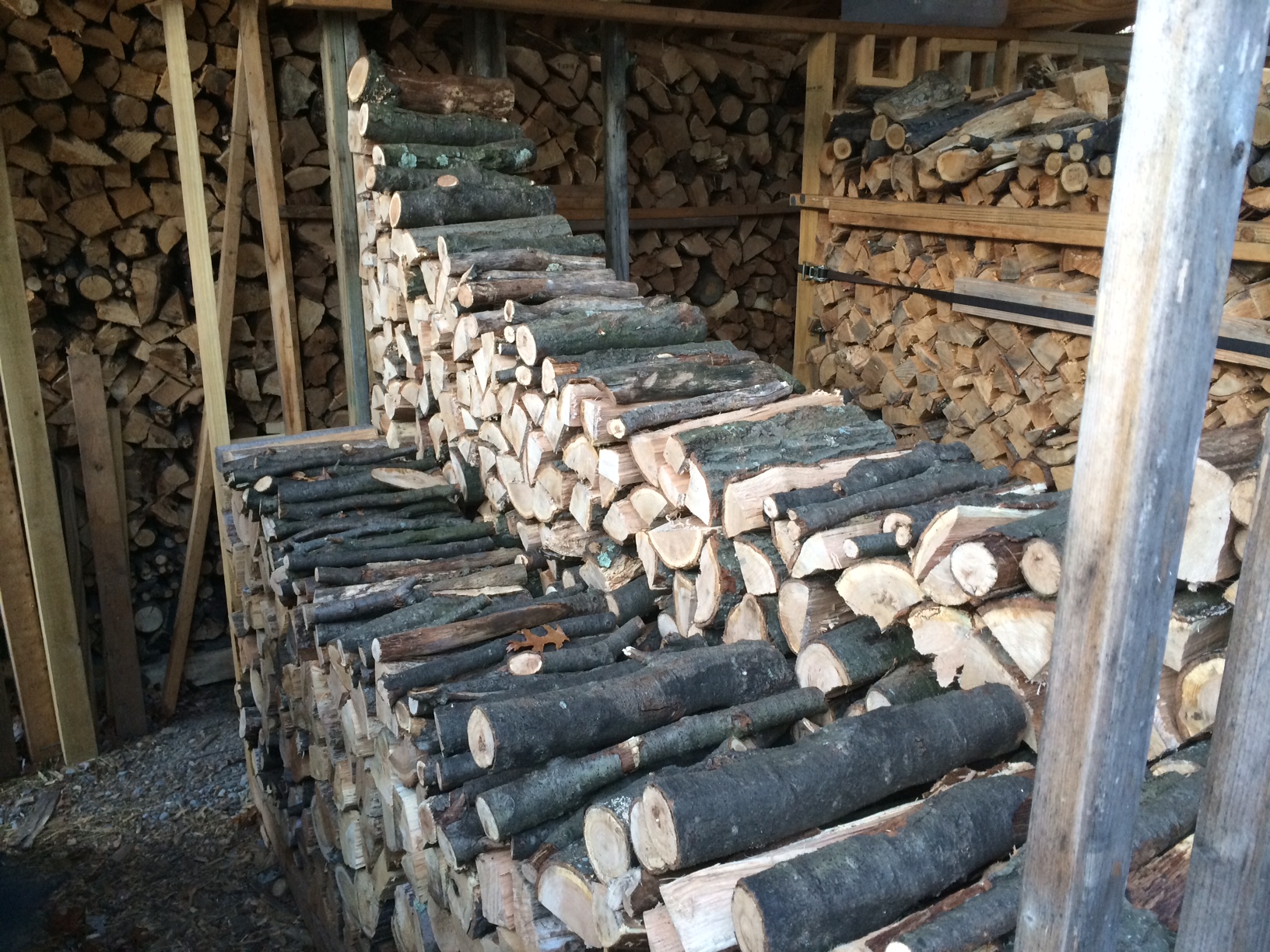

2. I divide the shed up into 7 areas basically. Six of the areas have 4' wide by 8+' long by 6.5+' high wood drying n storage cribs. Each crib is stand alone built off strong scrounged pallets placed on gravel floor. All cribs have ends/up rights of 2X4 that are screwed into the pallets frame than up to where normally would be the floor joists or ceiling rafters normally go. Each crib has a min of a two foot isle way to walk in and or promote air flow thru.

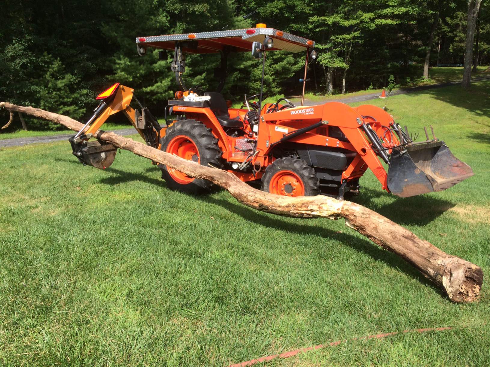

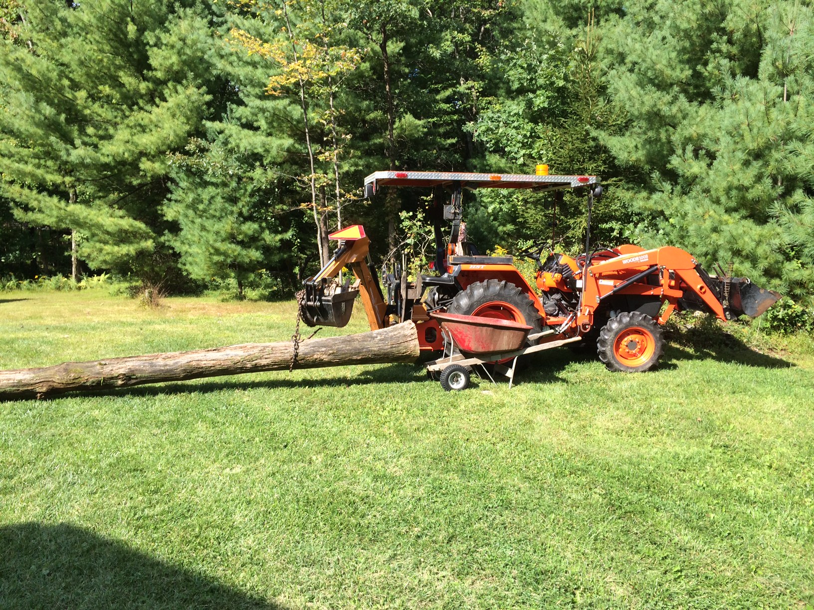

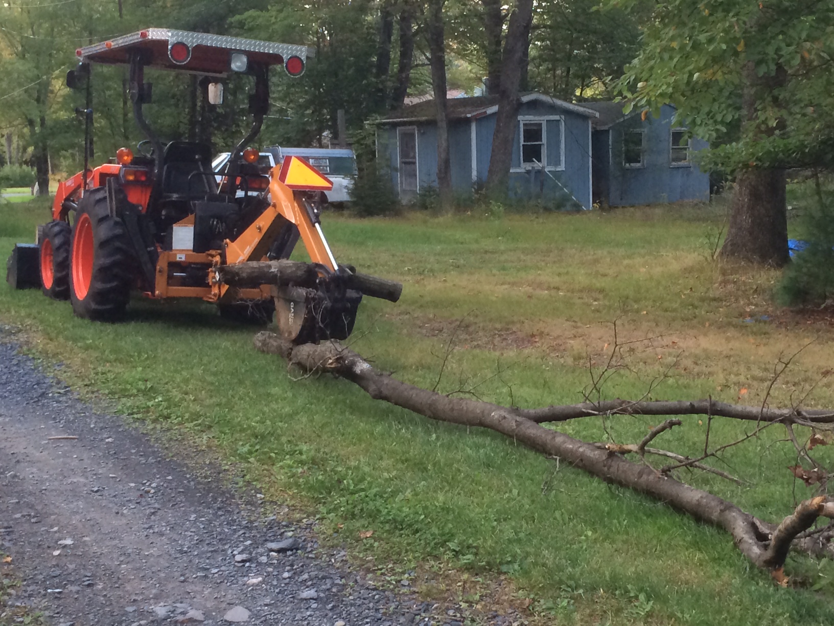

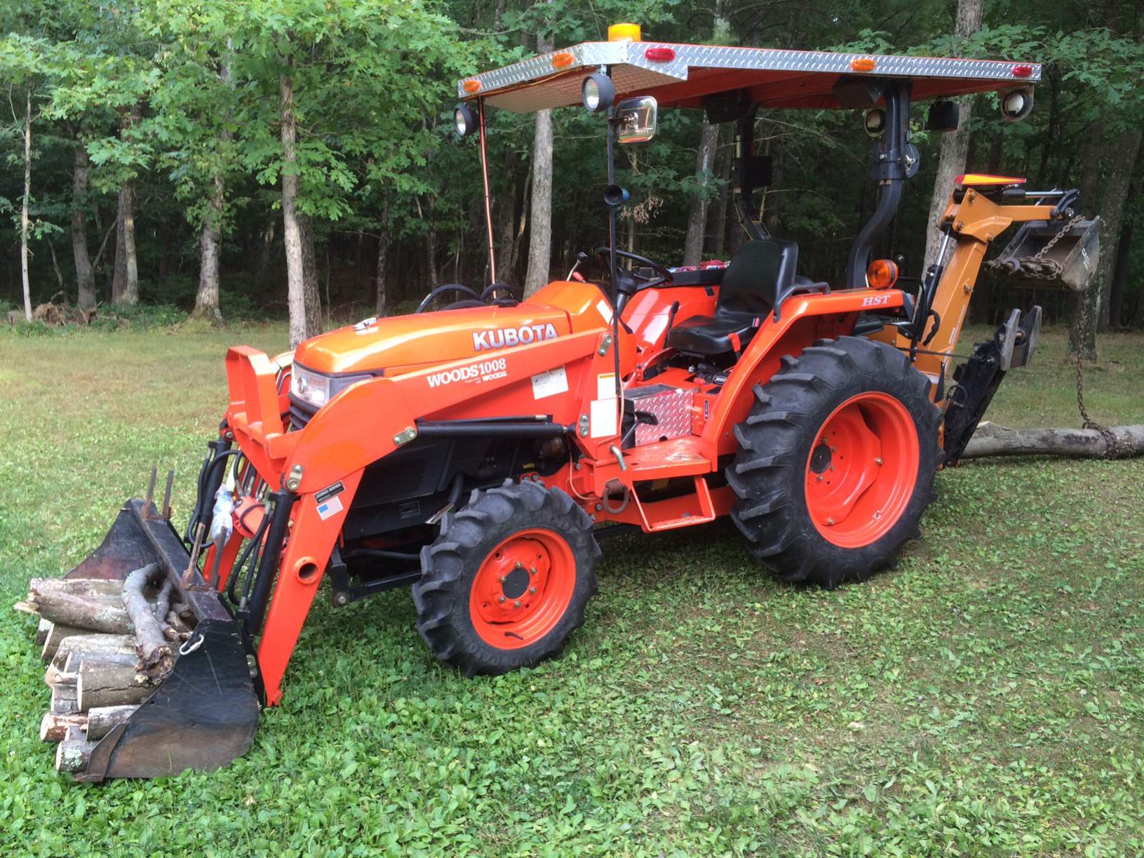

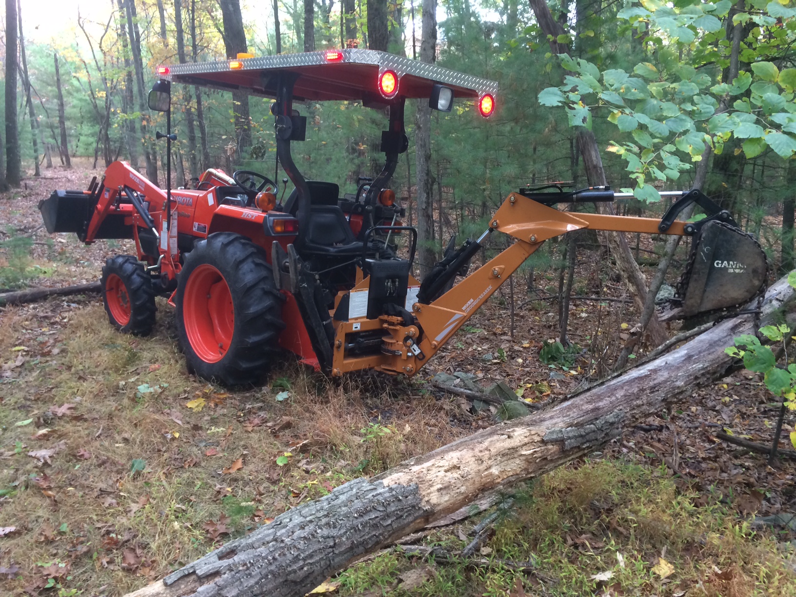

2. The 7th area was reserved to processing the wood. I either drag a long log in with the Kub and place it on a sizing ramp with a 12vDC jeep bumper Chinese hoist. I attach the winch line as near to the far end as I can and haul it in and up the ramp to waist height where I trim it into 16" lengths. From this point on I NEVER LET THE 16" LOG down, thus eliminating bending over thousands of times to pick it off the ground AGAIN.

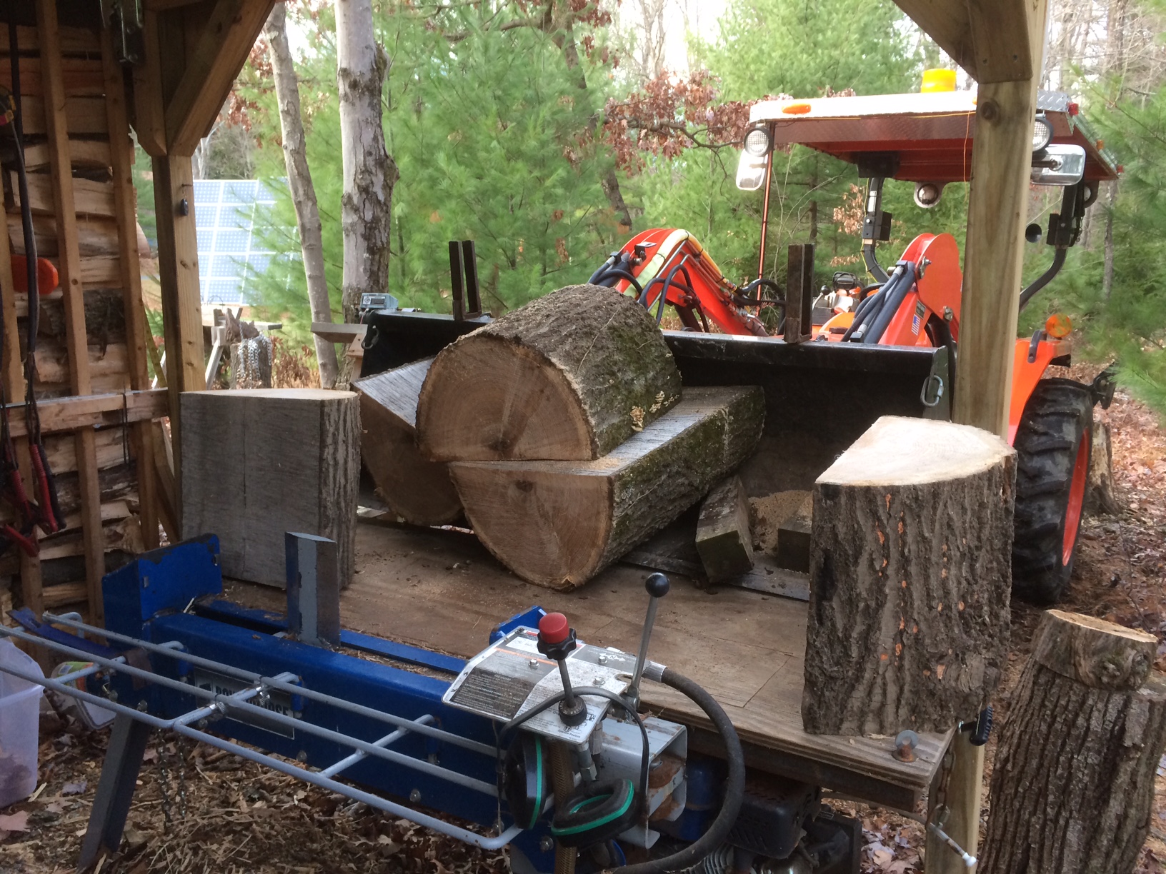

The sizing ramp's end (see foto FS06) was placed in such a location were I either cut a few 16" logs and immediately take them to be stacked or with just a simple twist of the my waist I simply place them over to the splitter work table if they beed to be quartered n split them later or when the table is full.

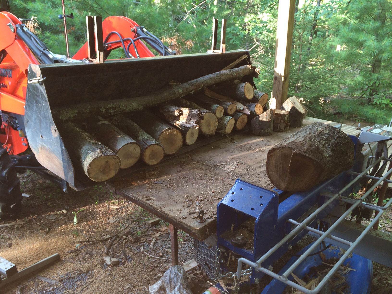

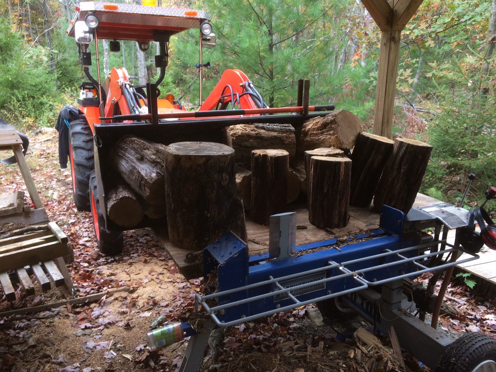

I chose a splitter I could easily add a strong angle iron work table to the side of. I place the logs from the re sizing ramp there for splitting or if the tree falls in a manor where I can cut into rounds that are off the ground near waist height I sometimes trim them in the woods into rounds than roll them into the loader bucket of the Kub n use the Kub to lift deposit them up on the side of the angel iron table I had fabled up and added to the side of my splitter. Again the thoughts are not work off the ground with my 65 year old back bent over and once lifted they stay up until placed into one of the 6 storage cribs to dry for at least the next 2 years.

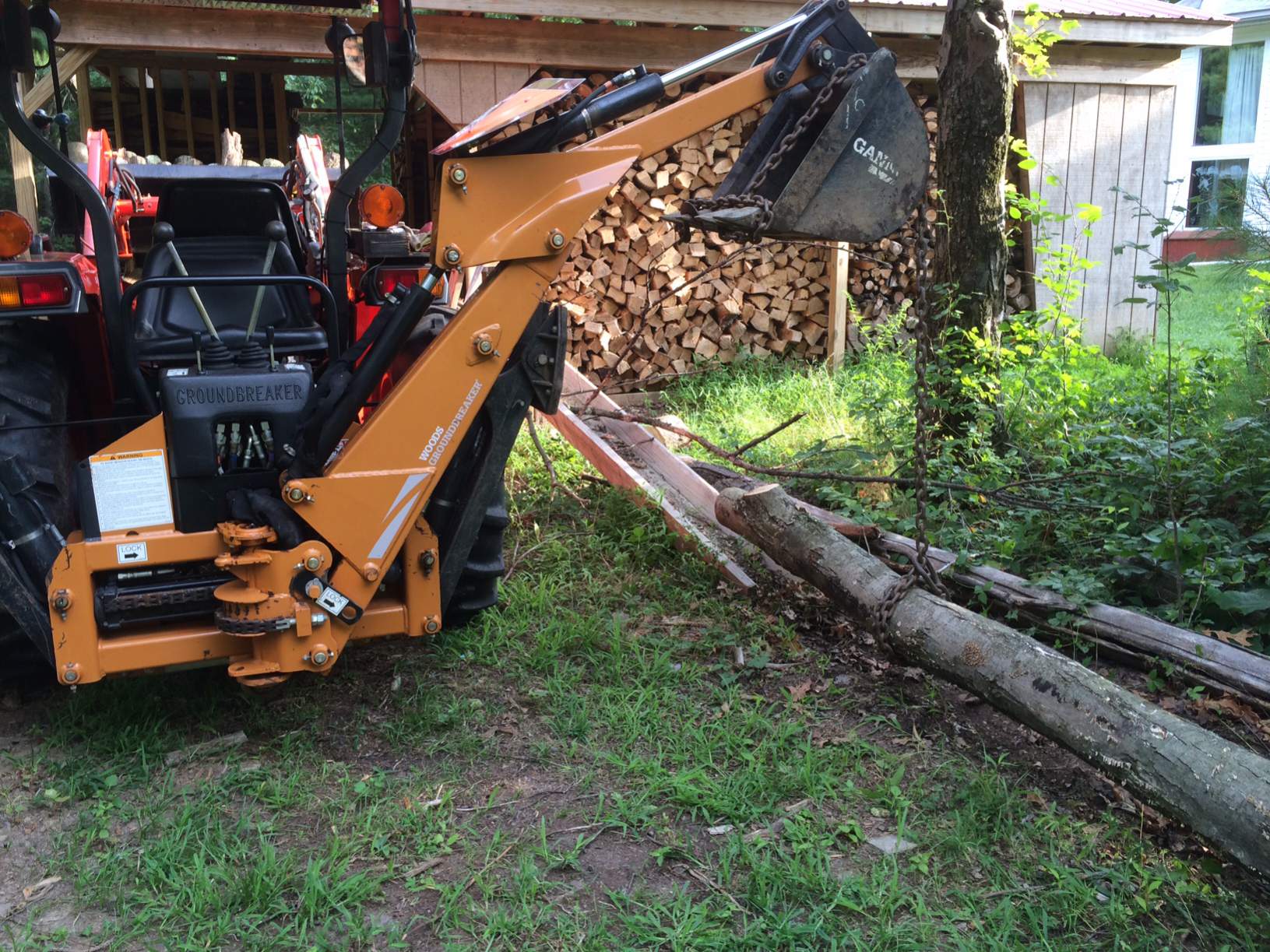

The seventh area is in the NE corner under the roof where I drag in the logs to (foto WS07) attached to the hoe bucket. Or haul them in with the Kub's loader bucked when I had the chance buck the rounds in the woods and they need to be splits and I immediately stack them in one of the 6 cribs a few steps away.
Again, one thing I do not do is get carried away with one specific segment of gathering wood. I noticed starting n finish each load of fire wood keeps me from using the ground for a temporary storage area, thus not needing to bend over n pick it up AGAIN........
Any Way, I haven't seen others working like this in vids on uTube but this works for me n my back just fine and I have one my wood drying for at least 24 months before I burn it.
