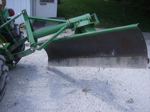

3-pt blade offset & angled!

That is SaaaWeet!
That's an old JD model 80 blade out of the 1960's. I have this one at home and two at the farm, one angled & offset for road grading & one turned backwards for a 'bulldozer' (both inherited). They show up on CL around here frequently. I used it on my JD 520 & now with the 790. ~~ grnspot
