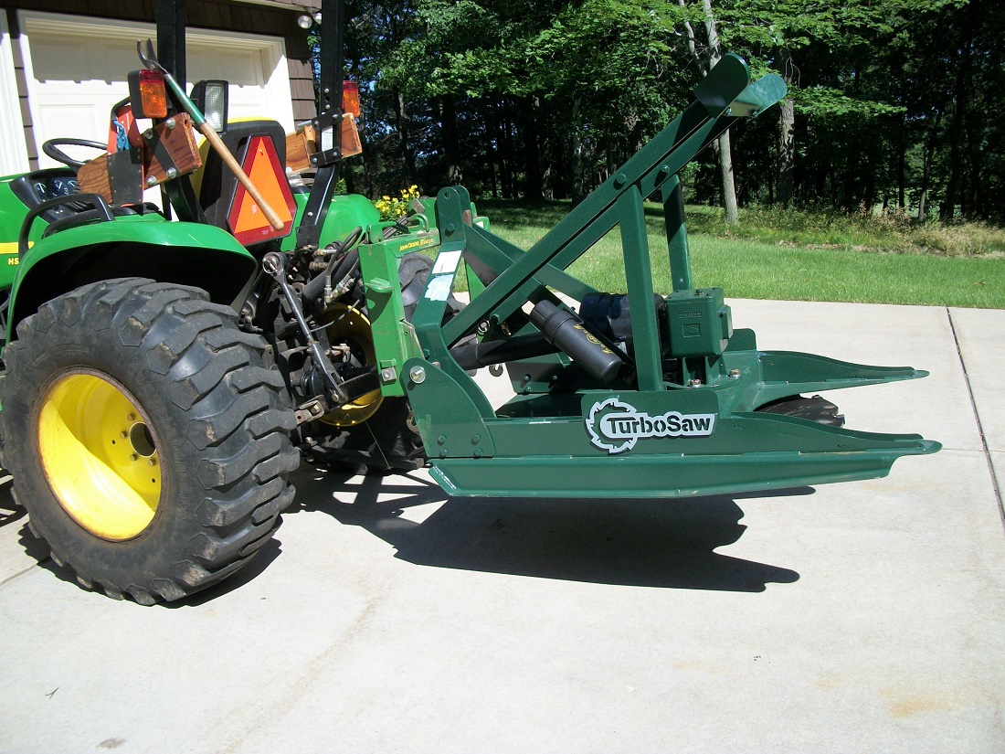

Bought the LT3200 TurboSaw, and it fit right up to my iMatch with very little re-rigging of the lower and upper connection bushings.
Was hesitant about the HP of the JD 4300 to power this attachment but after cutting over 50 spruce stumps today, the HP is just fine.
An awesome fit, finish, and robust piece of equipment..
Varying the pitch or angle of the sawblade using the hydraulic top arm is a convenient feature, but not a requirement.
Tackling standing spruce trees that are 30-40' tall and in the 10-12" diameter works well.. notch out on the tractor side and don't cut all the way through, allowing the push bar to topple the tree.
Thanks to a TBN member for chatting about his experience with the TS. One day use, but believe its a winner.

We need more action pics :D That's a great setup. It's nice to hear the power is sufficient as well. What do you have for PTO hp?
