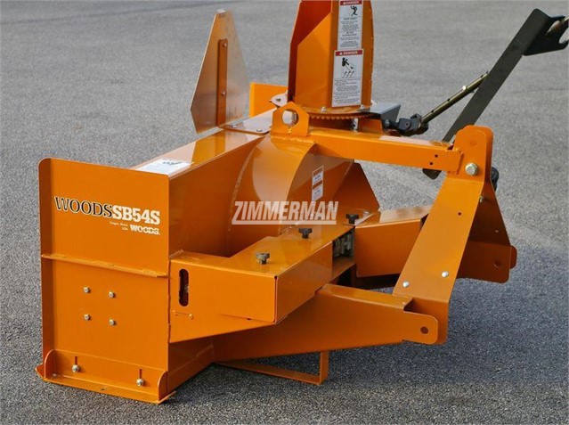

I run a Kioti 2610 with a 54" rear mount blower (Kioti, but made by Woods). The ears where the 3-point arms attach to the blower have begun to flare outward as if the arms are forcing themselves too wide against them. I am aware of the turnbuckles that control the swing of the attachment. These do pull outward if turned to tight, and I keep this in mind when I adjust; loose enough to allow a little swing, but tight enough to keep the arms off the rear wheels and chains. I don't think any sort of tensioner between the arms is an option because it would obstruct the PTO. I could weld some strength into the ears of the blower, but I am surprised the modifications would be necessary.
Am I missing something?

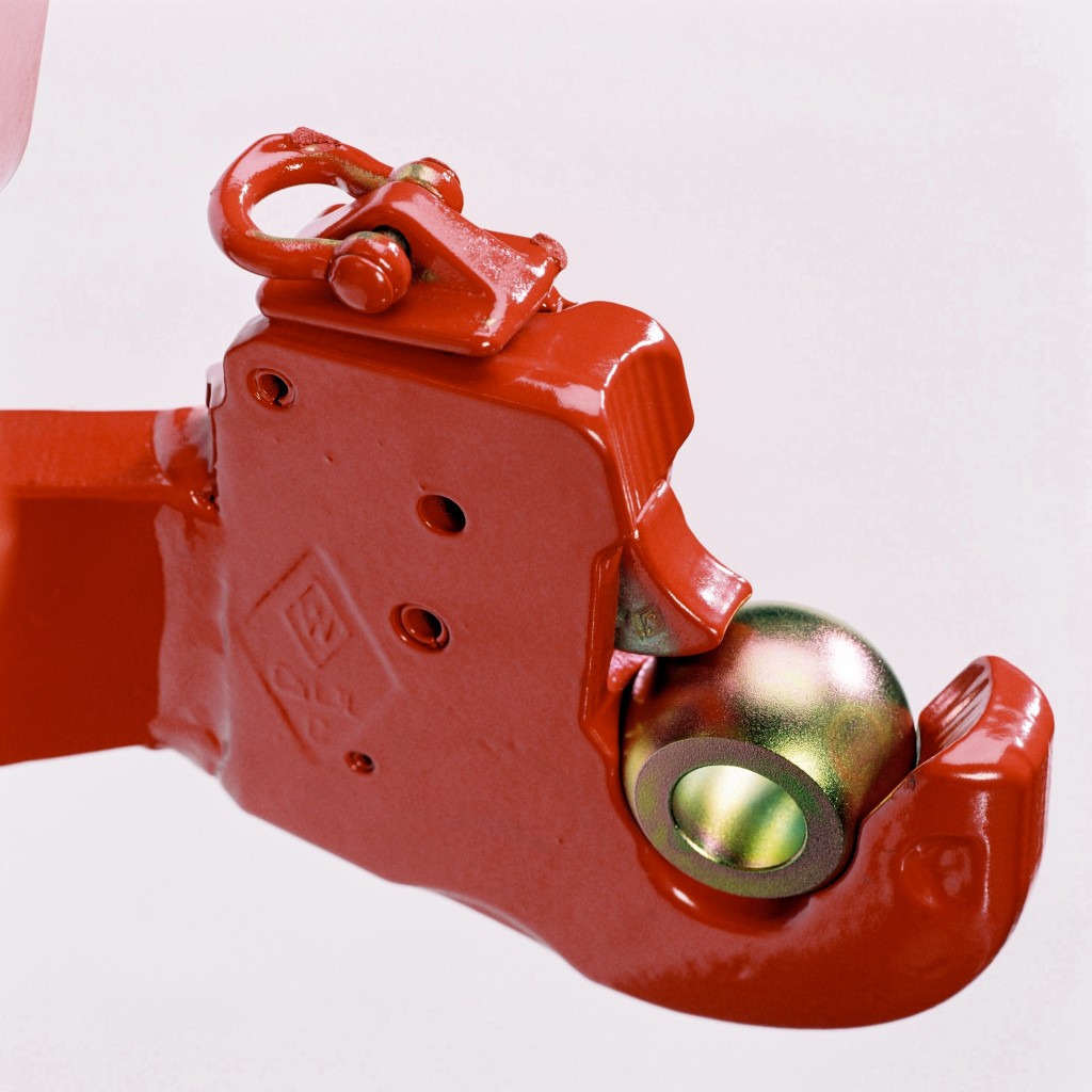

That's why we use these in Europe:
These together with telescopic side links, makes for a really nice and fast setup.
Well that's cool! It's like a Pat's Easy Change system only welded on the lift arm and with the added benefit of a ball. Nice!

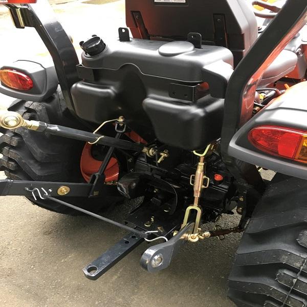

Pictures are not of my tractor but show the blower and 3-pt hitch. To me, it seems the ears are poorly designed and weak, but Woods sells a lot of blowers so I can't imagine I'm the only one who has seen this.
Chain and turnbuckles between the arms would interfere with PTO.

The quick fix would be to use the appropriate size bolt and nut in place of the pin. That will hold the outer flange relative to the inner flange.
But I agree, the flanges should have been made heavy enough to take the pressure. Notify the manufacturer, see what they have to say.
