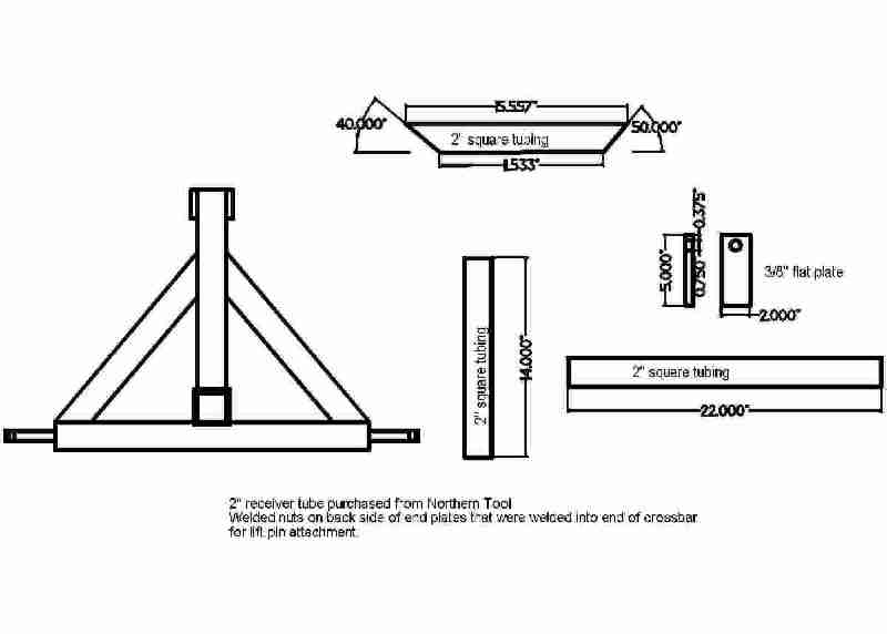

Joe,
Here's one that I fabricated a few months ago. My Cadd package doesn't convert to a JPEG very well but I think it should be clear enough.
RDS

RDS looks good.
TSC also has the 2 inch reciever tubes for sale.

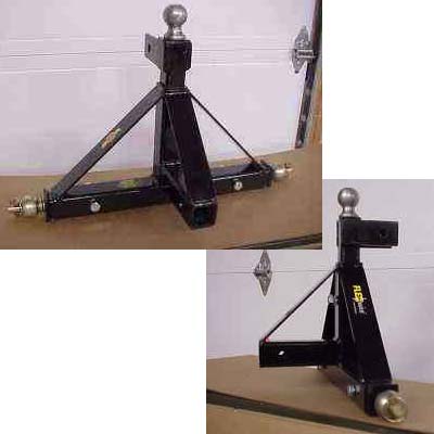

</font><font color="blue" class="small">( Northern catalouge has that I think. )</font>
Attached is a pic of the one offered by Northern Tool.
John in CT

   / 3 pt attachment plans #8
There appear to be two bolt heads on the rear facing portion of the lower horizontal piece. Any idea what those are and why they're on there? If they were eye bolts, I could see using those for attaching the safety chains for whatever trailer is being towed.

Gary,
Your're right, there's nothing special about the receiver tubes, just was convenient to punch in the order on the web and have it show up at the door. I had everything else laying out in the barn.
RDS
