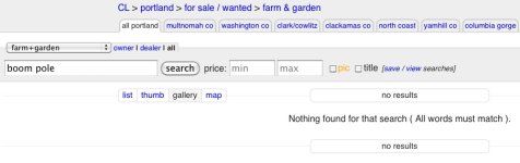

Not like that here. I've seen two in 3 years. One was too heavy, the other was bent.
Searched 7+ counties.
If I don't limit it to "Farm - Garden", I get big trucks, microphone poles, and sail boats.
Bruce

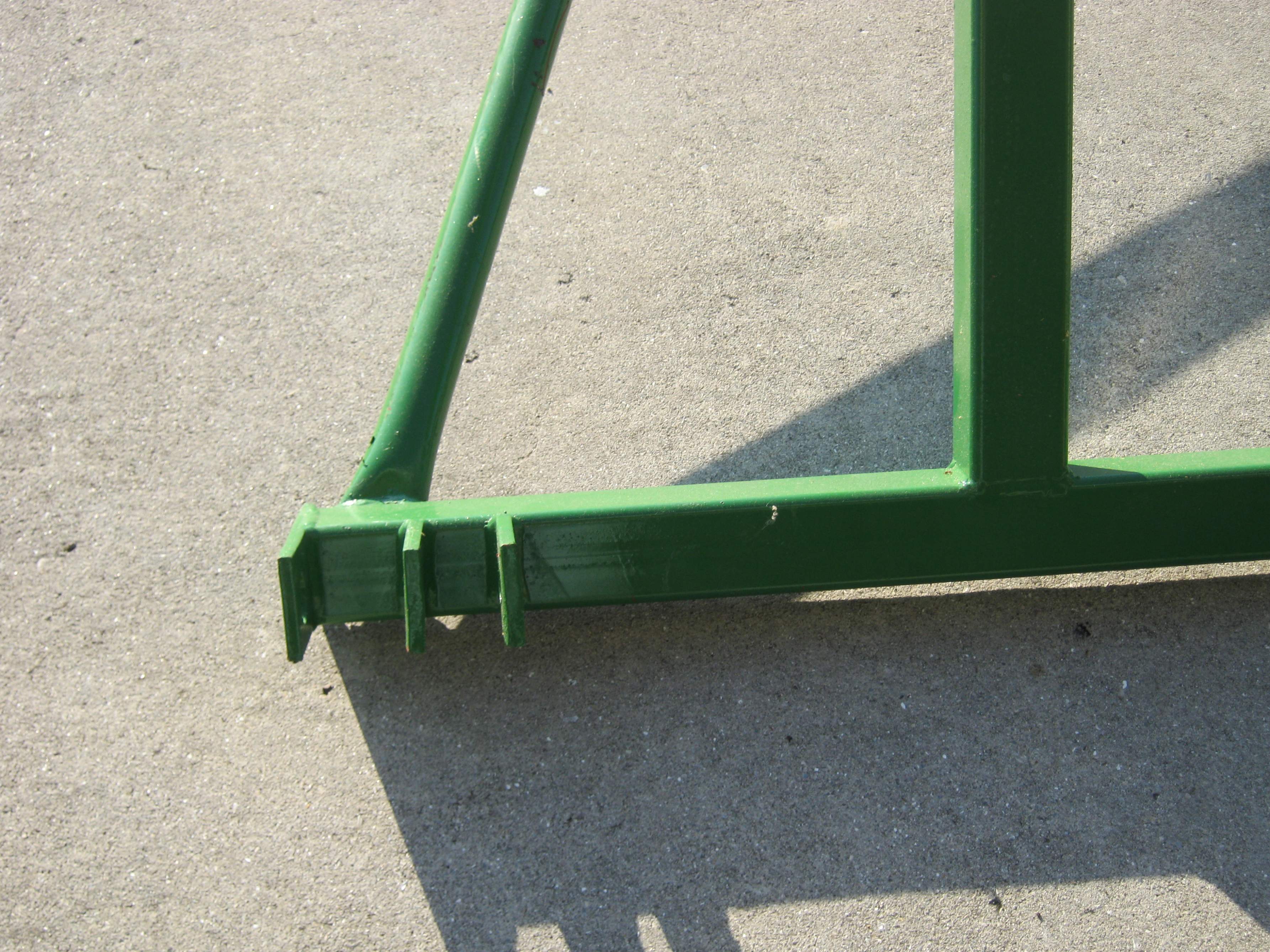

Heres mine I've posted these pics before. Its a cat 1 or 2. Built by the old World Agritech Corp or also known as "International" not same people as IH. Came red I painted it JD green .
