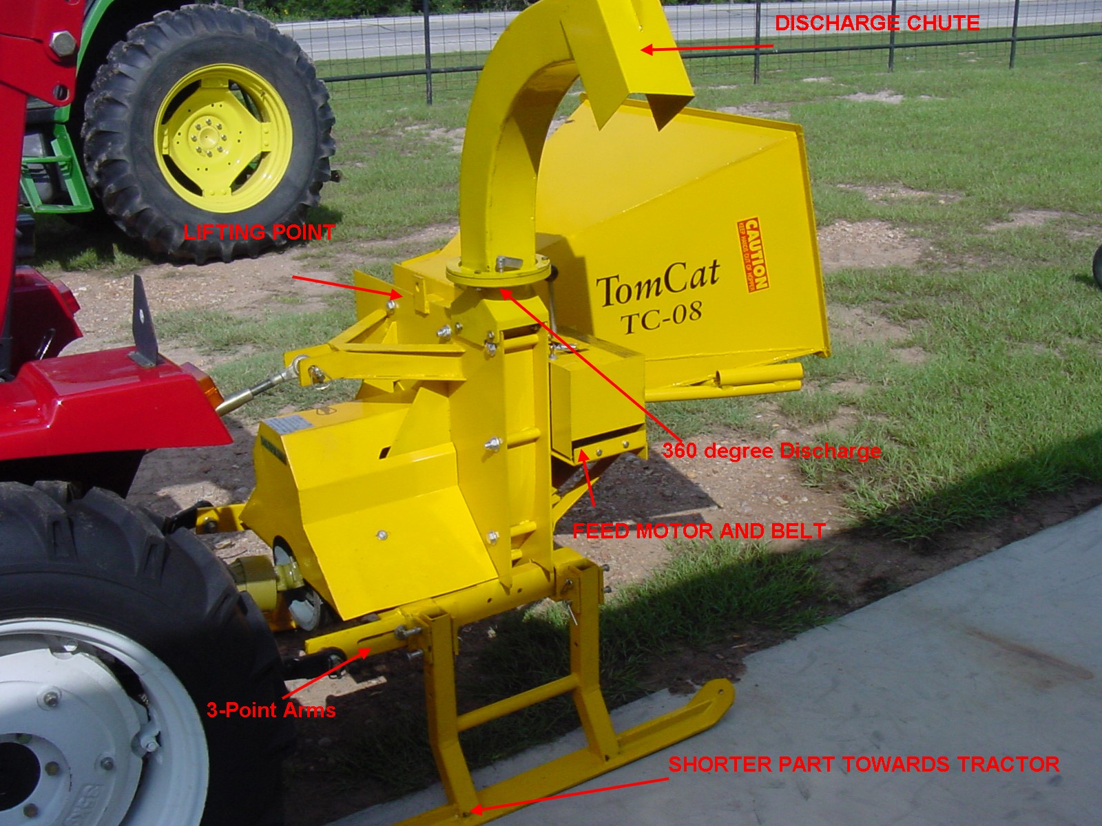

Those of you guys that have 3pt chippers would you consider them built heavy enough for light commercial use? I am looking at the Jinma 6" mounted on my JD 2520 and would like to do some light commercial work with it. What do you guys think?
Does the shute on the Jinma rotate 180 degrees? Also would it have enough power to blow chips into a truck? Thanks.
I cant justify $4-6K for some of the other 3pt units out there. At that point you could buy a free standing unit with its own power plant.

1; I have sold several to landscaping guys. The key to these chippers are proper prep / set up before they are put to work.
2; Not sure what the PTO hp is on a 2520 and what size/diameter you want to chip?.
3: The ones I sell do not rotate. Remove 4 bolts and can either blow left or right. Power to blow is effected by PTO power/speed.
There is a picture here showing chips being blown in a pick up.
Click here; Jinma Dealer, Wood Chipper , Compact Jinma Tractors

I wouldn't trade my Jinma for anything. That said, you just don't unload it and go to chipping. It takes some tweeking. I spent hours getting it " just right". If you are a tinkerer, you will have a great experience with it. If not, it will drive you nuts. I wouldn't have it any other way. I use it now for long periods of time and come home happy. I'm sure they have inproved it some, since I have had mine for several years. Like Ranch Hand said, proper setup. If your dealer does his part, you will just need to fine tune it, and keep an eye on things until you are sure it is " just right".

I have a small tree removal business. I have one to two groundmen plus a kioti lk3054 with a jinma chipper. all I can say is it works great for me. Light and small enough to get just about anywhere and with a set of forks on the front I can move and load the wood with out a lot of damage to the property or employee injurys. Anything 6" or bigger I keep for firewood and all gets removed in log length from the property. Chips all get blown into to a dumpster and taken away with no problems loading a dumpster tightly. Yes preventive maintainents is the key with the jinma but also with any chipper. it has stood up and preformed well for me. hope this helps.
