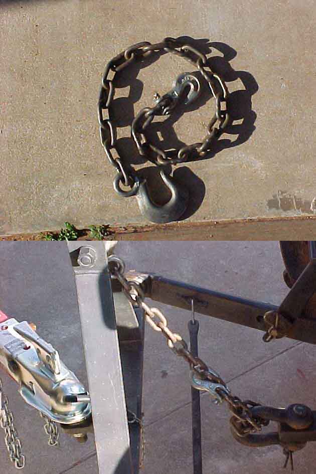

<font color="blue"> It comes with hardware to keep it from popping up as well, which is important if you are moving heavy loads on uneven ground since the 3PH has no down pressure.
</font>...I agree...important for any load that can't manintain positive tongue weight. Loads of all weights have popped up on me, but not since adding a restraining chain. It attaches to the "swinging" draw bar and to the hitch frame. Similar to the way BadRiver does it, I think.
OkieG
   / 3-pt Hitch Adaptor for Trailer #15
Oops. Here's the picture for the post above.
OkieG
