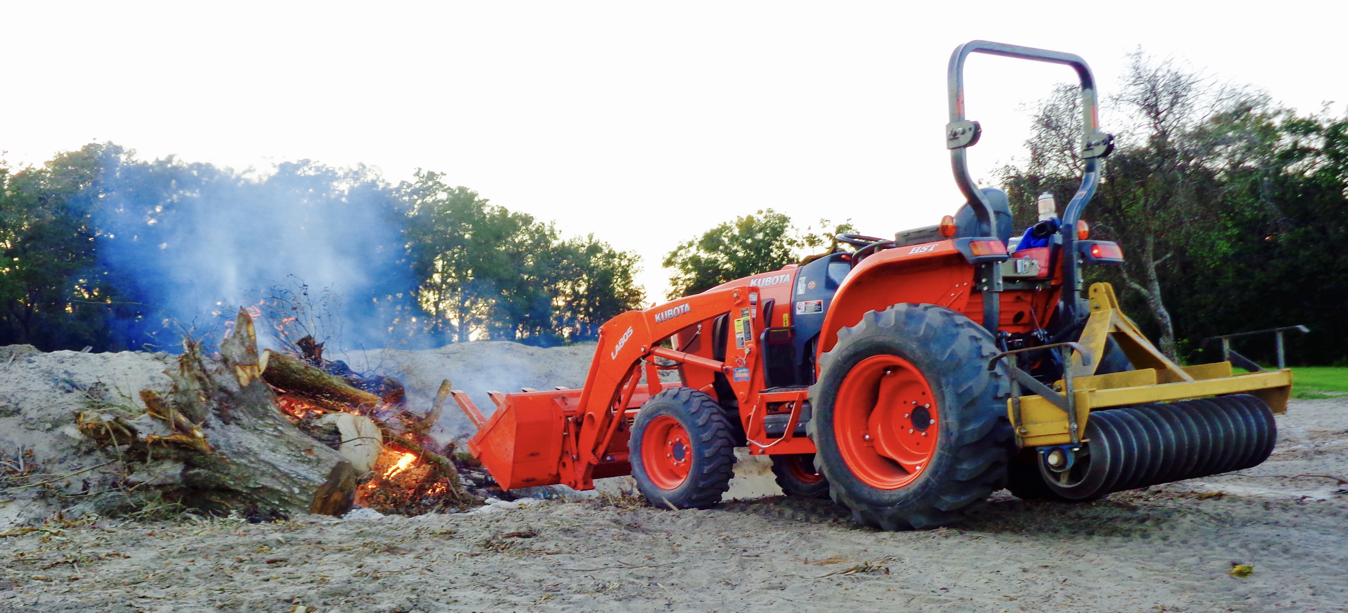

Titan weight box is the lowest cost, ready-made, single purpose option.
I concur with OOSIK that an implement mounted on the Three Point Hitch is the best additional weight.
My rear tires are filled only with air. The three implements I use for ballast most are a Cultipacker/600 pounds, Rollover Box Blade/700 pounds and TR3 Rake/ 800 pounds.

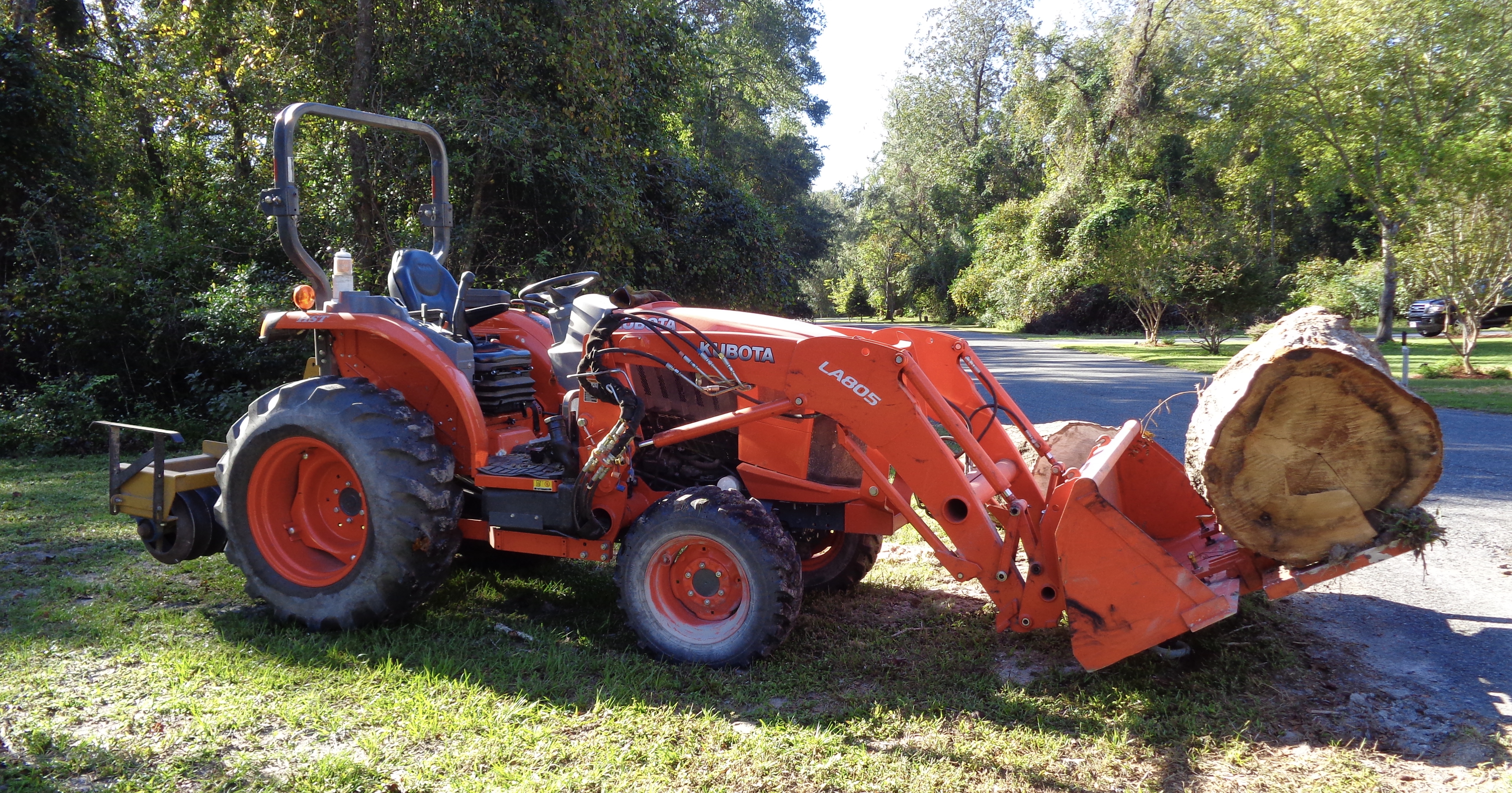

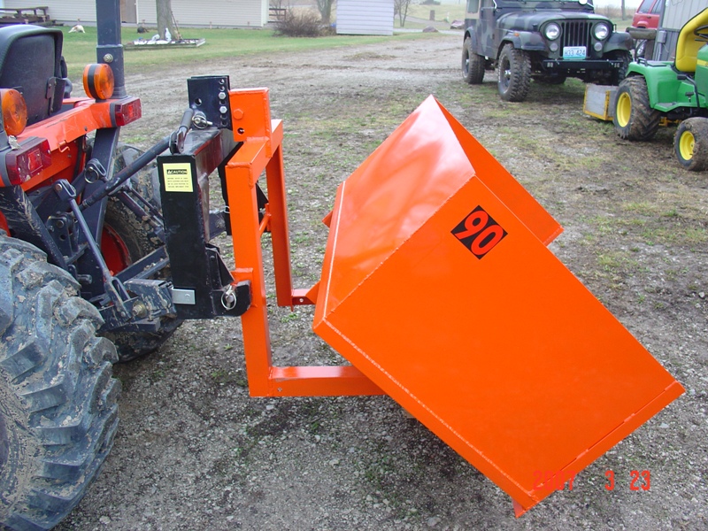

I have kept my hoe installed for ballast but I'm going to build a dumping carryall box that will have a 4" concrete "floor" on it to provide about 800' of ballast hanging on my TPH. It will be essentially like the Titan box but larger and like this. It will give me the weight I need and won't be anything close to as "out there" as my backhoe is and will give me a lot of hauling ability and places to put stuff when working away from the barn.
Kind of like this. Of course, one needs to be able to fabricate to use it but it will be as easy to mount as any TPH implement and will be exceedingly useful for my purposes anyway. Just hanging weight on the TPH does the job but serves no other purpose - this will serve many.

I don't know why it won't let me post my photo properly nor why it names it the old name "clamp on" but that is a pic of the box similar to what I will be building.
Great Idea also..More uses with this attachment..Something for me to consider also.. Thanks.
