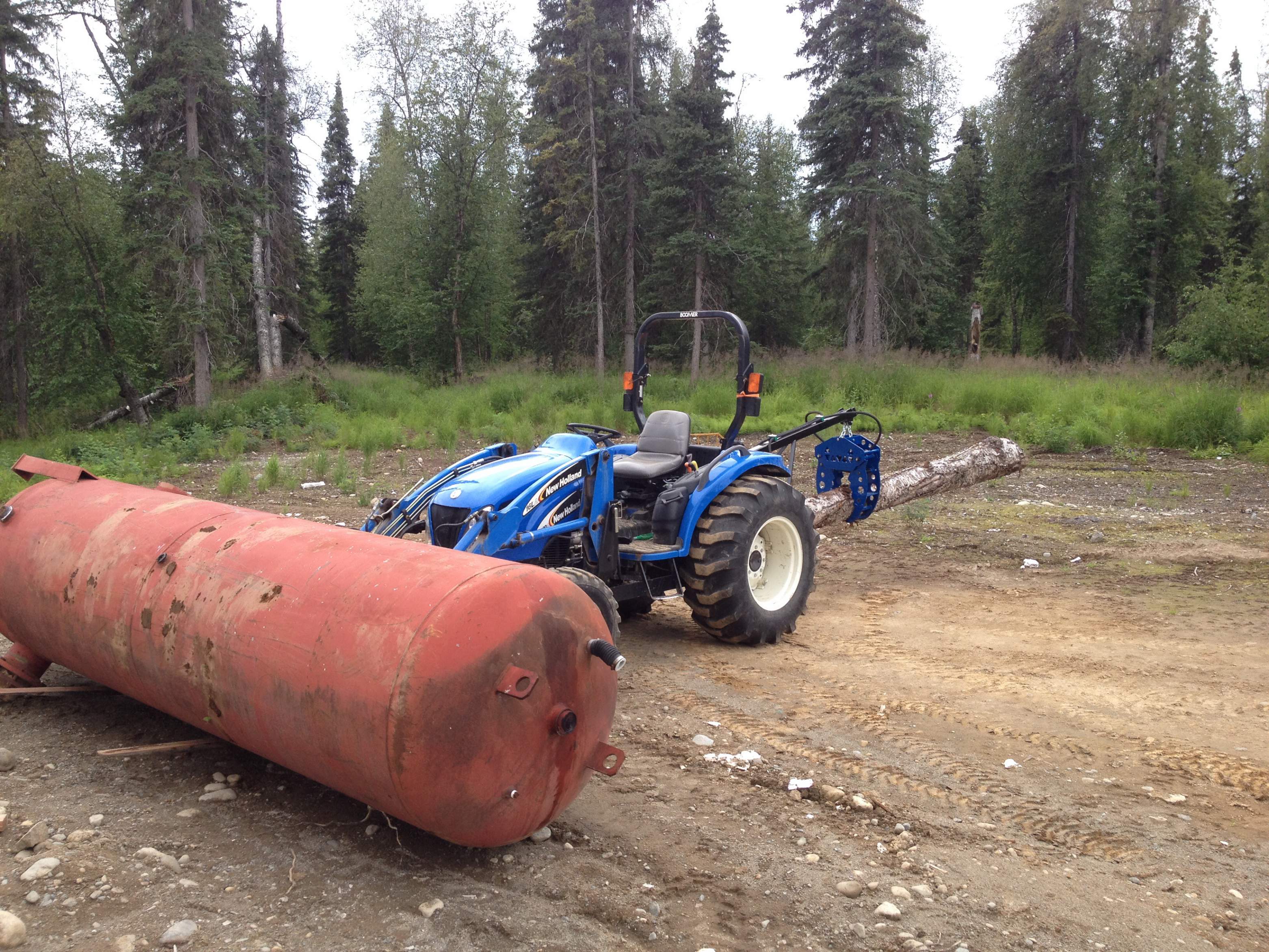

Very impressive AK. please give us a report after you have given it a good workout. I'm wondering 2 things, what is the measurement from the cyl pin to the "hinge" pin, and does that provide enough leverage or squeeze to hold a full "bite" of multiple stems? And while you're at it, do you like the dangling chain mount v/s a more ridgid 2 axis conventional mount?
Thanks for posting, and I'm probably going to "steal" you design (if I may) :thumbsup:

The Hinge pins are 7/8" cylinder pins are 1". The chains are "cheap & easy" and seem to work real well there short enough to only allow just over 180 degree rotation yet they rotate very easily for the first 90 degrees.

I found a new use for the grapple, holding a counter-weight!!
