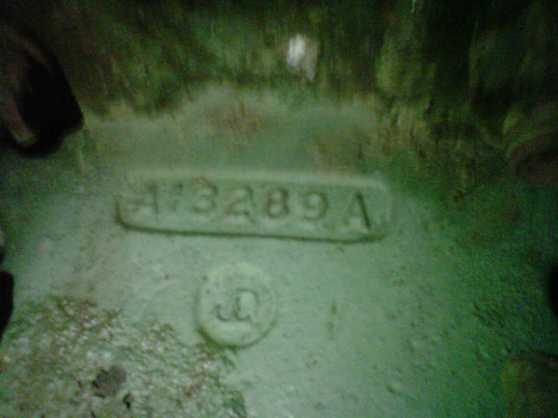

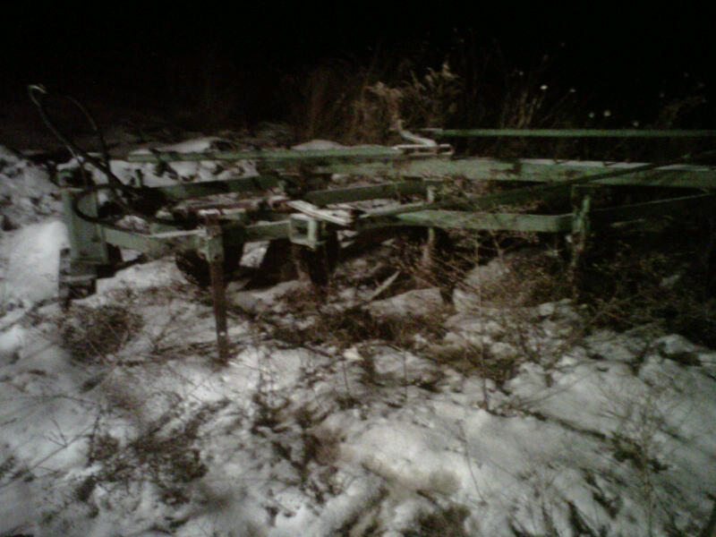

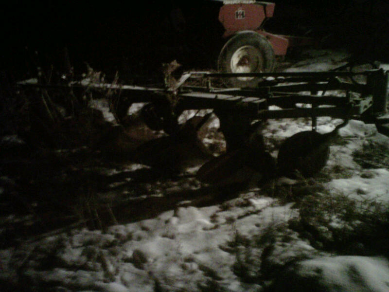

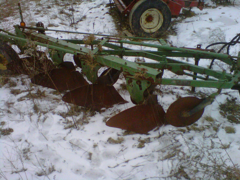

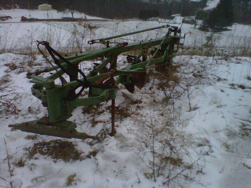

OK so i got some pictures for you fellas. It was dark out when I took them so i apoligize. The tractor lights are only so bright! There was no tags or model number on the plow only a dealer sticker. The one castiing number was right behind the upwright where the hitch swivels.
