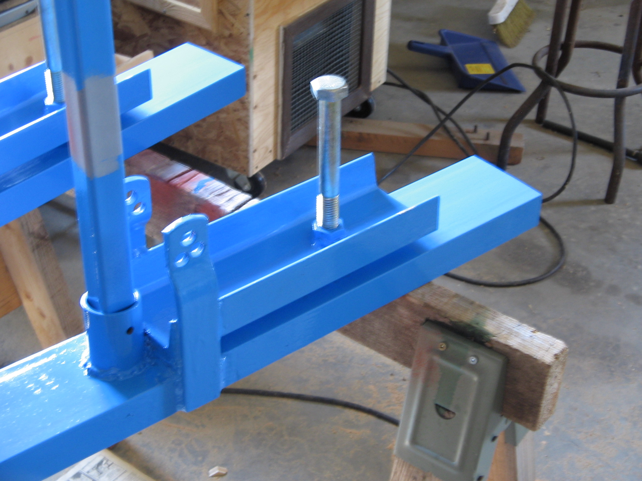

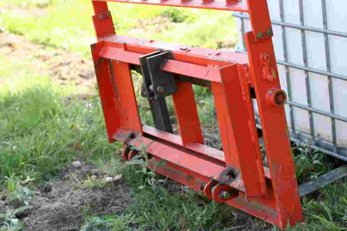

I did not have a FEL at first, so I made a set for 3pt. Later when I got the FEL I converted them to bobtatch. When I needed to lift a lot I missed the 3pt capacity so I took them back home and adapted them to fit the Speeco. Now they are bobtatch for the front, and fit the Speeco for the rear.
My forks stay on the tractor FEL more than the FEL bucket. With brush bars they carry a lot of limbs. When they are on the back I carry a full 300 gallon water tote for the trees.
You work hard and deserve the best. Go dor double duty. It takes just a little more time to figure out the welding.

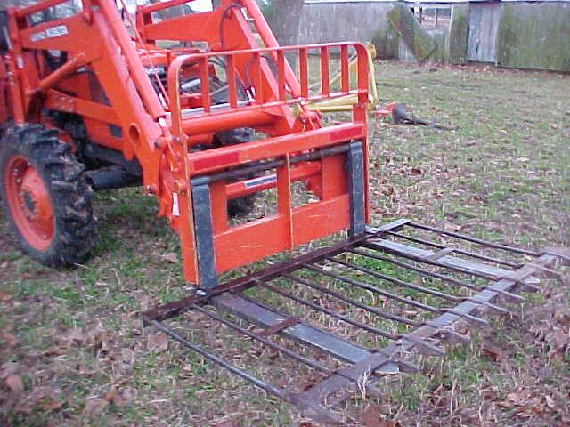

I recently made a set of FEL pallet forks to move hay bales mainly. The main concern was to be able to lift the bales high enough as the stack grew. Weight is not a great concern as only lifting 4 to 6 bales at a time ( likely only around 350 lbs. ). I would not attempt to lift a lot of weight very high with a compact tractor.
The pallet forks I made clamp onto the FEL. This worked very good since I had to off set the forks to one side so I could get in close enough to the stack. Also I don't have to take off the bucket. It only takes about 10 mintues to put the forks on. The one thing I did add was uprights to stop the bales from tipping backwards onto the tractor. Not a great thing with a fiberglass hood.
They cost me less than $90 ($80 US) for material. I couldn't find anything less than $1,000 around here.
