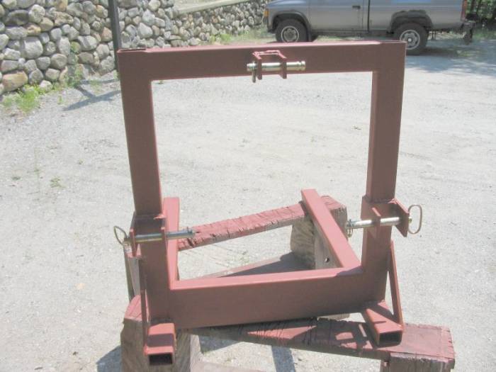

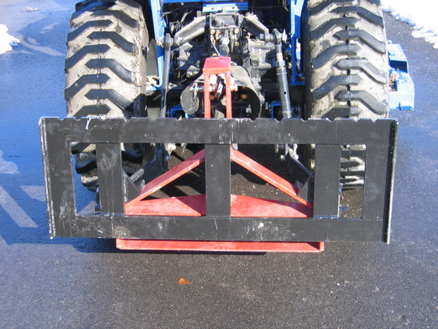

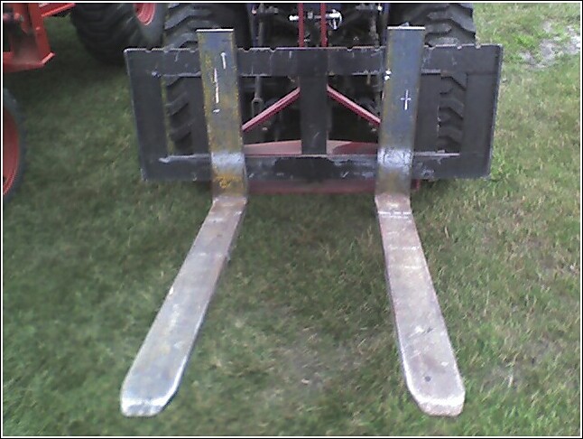

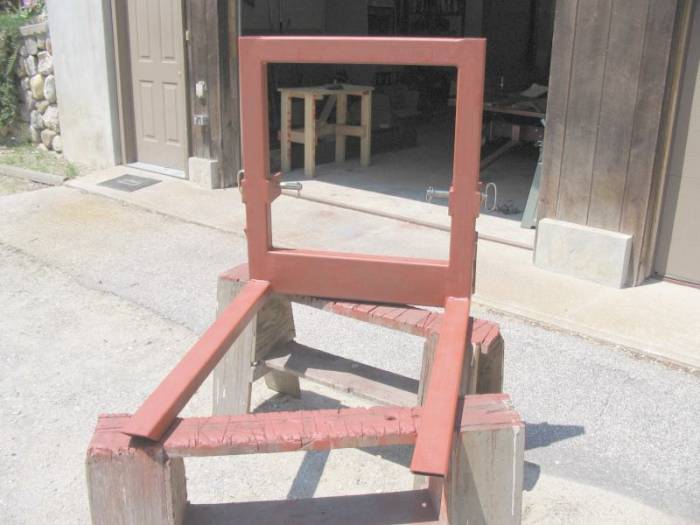

Does any one have a picture of a pallet lift that they have made for a 3PH

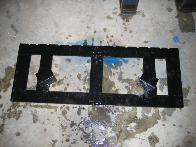

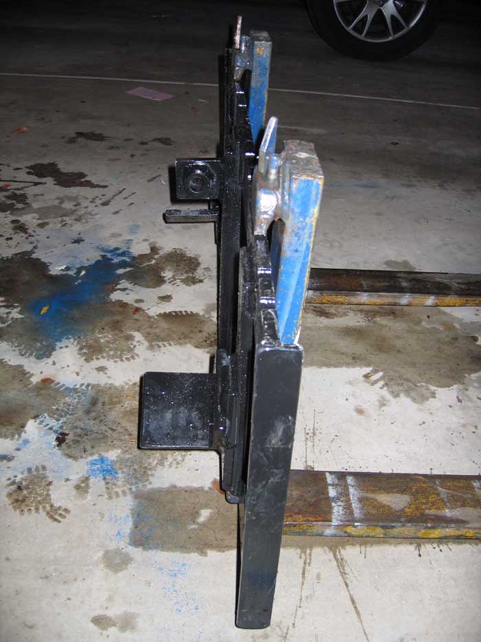

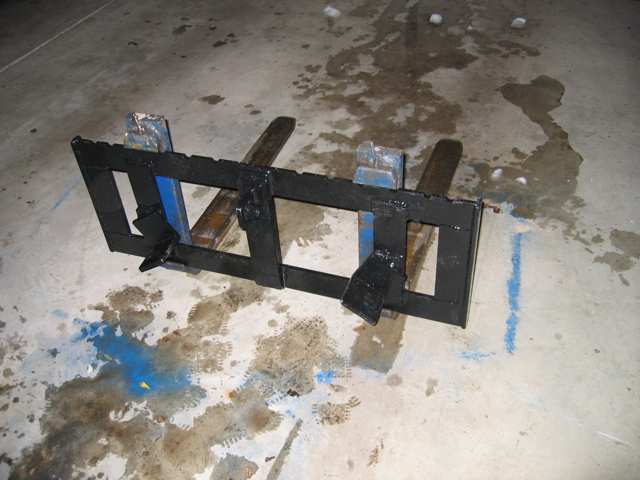

   / 3 PT Pallet Forks the easy way! #5
I have built 3pt pallet forks. These are very heavy duty and were designed to lift at least what the 3pt could lift. I am not sure if this is what you are looking for but it will give you an idea of what can be done. The forks themselves are 2" x 3" x 3/16" rectangle tubing.

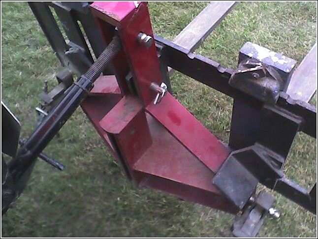

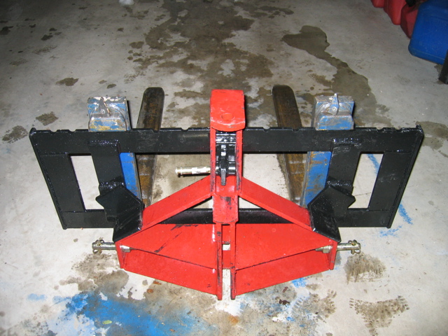

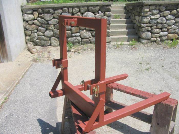

   / 3 PT Pallet Forks the easy way! #6
Nope, but I have several pictures :D
Mine comes apart into 4 pieces so it is easy to store. I used a toplink pin to hold the backplate to the 3pt A frame.
I strongly recommend a hydraulic toplink, it makes life much easier!

   / 3 PT Pallet Forks the easy way! #10
I made one exactly as you are thinking and it has never failed, I have picked up and moved 2000 lbs that is as much as the tractor will pickup and the front wheels still be on the ground ;)) Without a hyd toplink they are very hard to use if moving pallets on rough ground.
