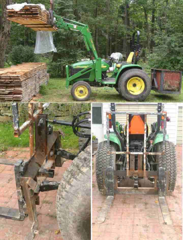

Here is that forklift that fits either end of my tractor. I made it for my old 18hp Yanmar, but after getting my JD 4310, I beefed up the forklift and added the hardware to fit it on the FEL. It also has a receiver and a clevis for skidding logs.

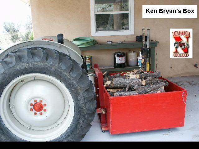

One of our Club Members made this carryall..He put casters on the bottom so it is portable when not hooked to the tractor.. See attachment..
