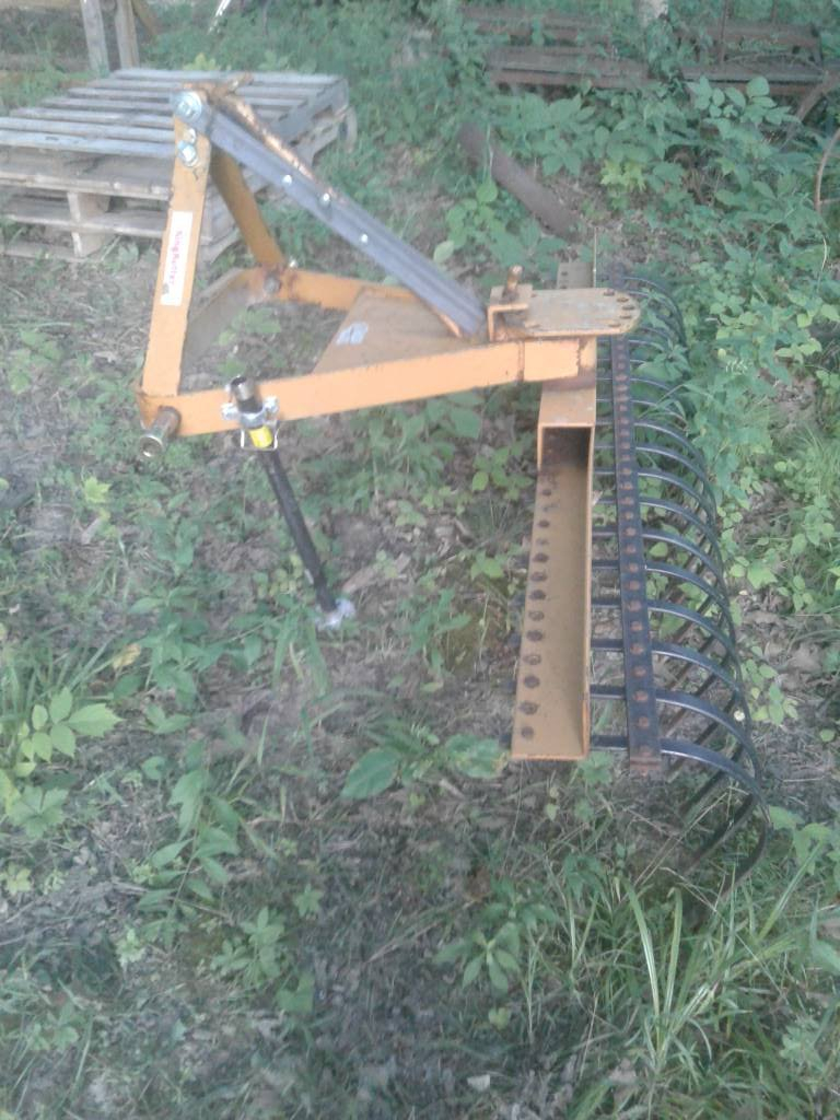

Just buy a piece of black pipe that sleeves in...Screw a cap on top. Screw a base mount flange to the base...
I did the same thing and made it so my stand slips out when I lift the rake to keep from bending it like I did to the original stand.

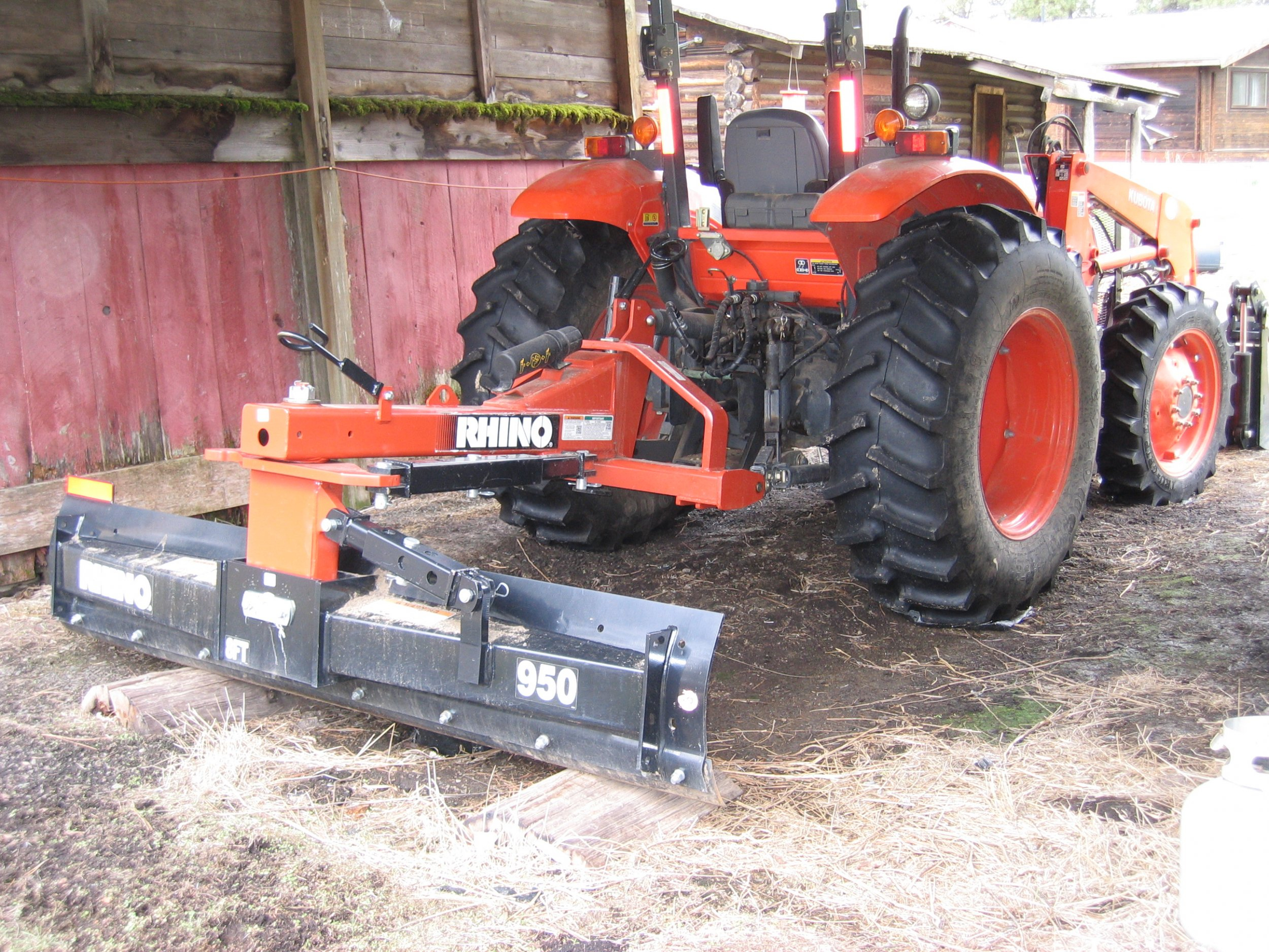

When I back my tractor into its stall - the rear blade rests on two chunks of firewood. Not worried about rust. It's just too darn dry around here for things to rust. It sits on the firewood so, in the winter, it won't freeze to the ground. Without the wood chunks - the blade will pick up a pretty fair amount of frozen ground.

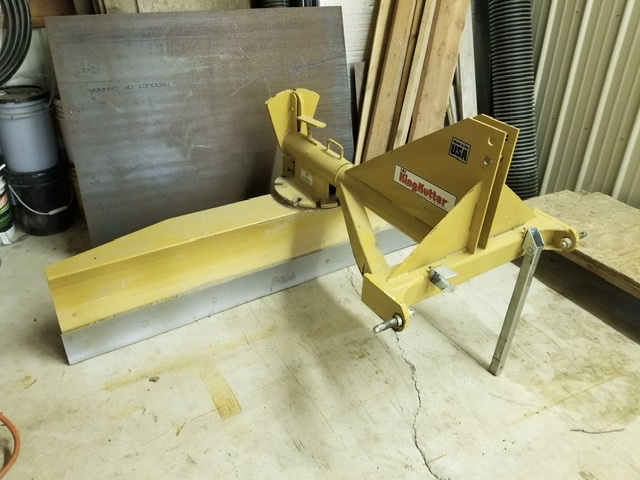

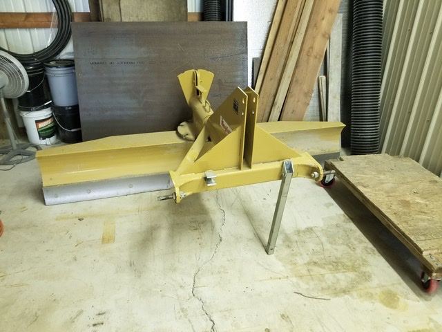

Mine came with a kick stand that rotates close and clips in holder
