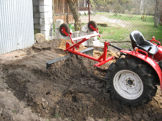

   / 3 pt rear blade #26

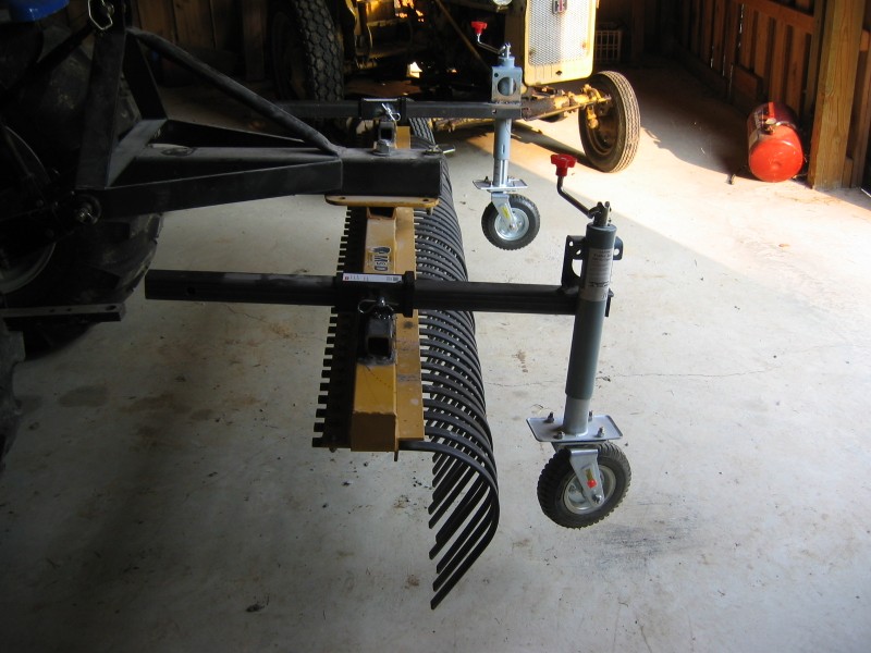

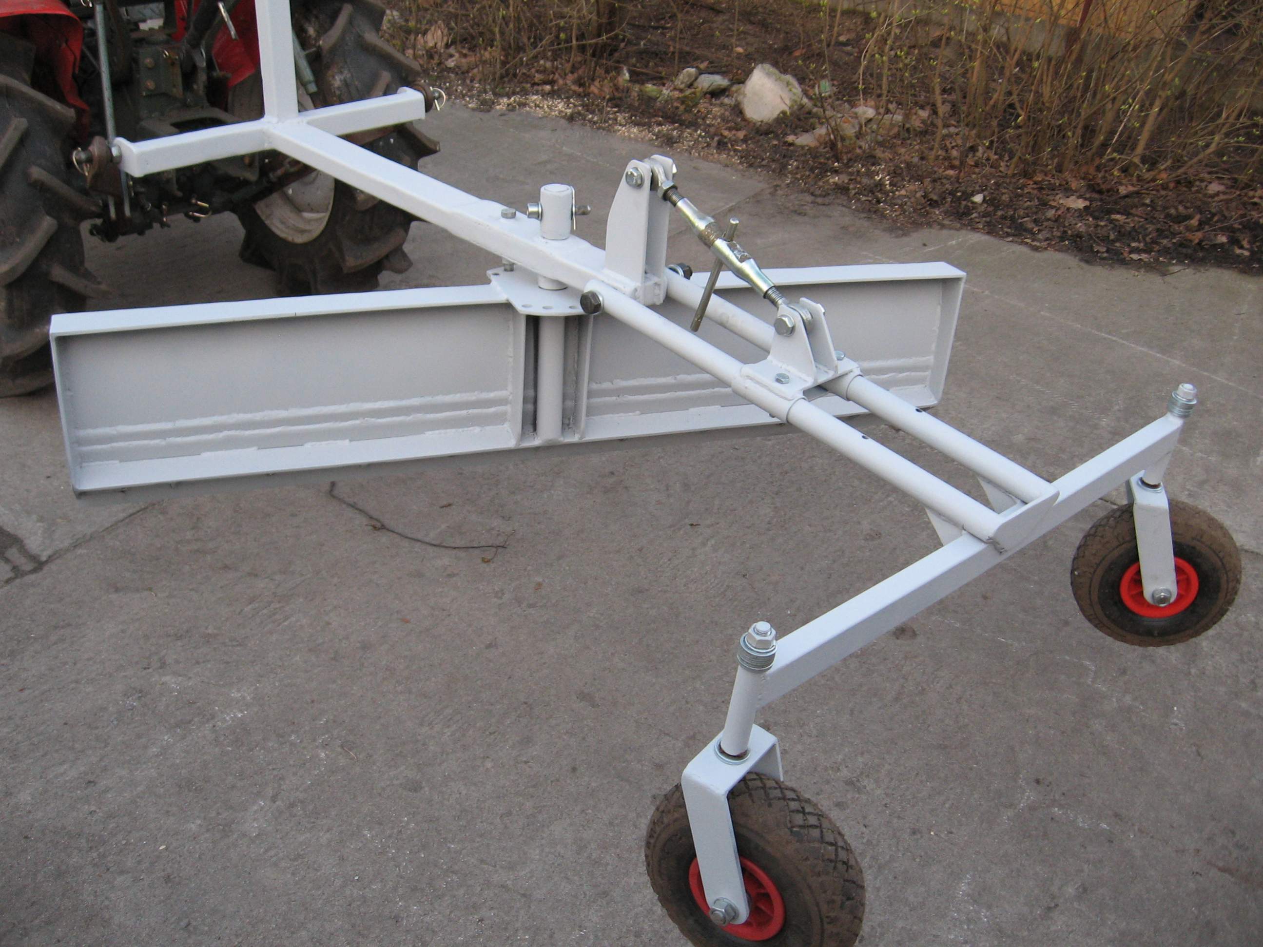

Good timing for this discussion: Are the gauge wheels mounted at the ends of the blade or as an idler behind the rear pivot?
They really can be either way. The wheels mounted on the blade itself and specifically those mounted close to the blade mostly just keep the blade from digging in or cutting when it is not supposed to (ie. plowing snow).
The other style is mounted to the frame of the RB and serves better to help smooth things out. This is based on the long wheelbase concept that road grader are built around.
I am posting pictures of each style so that you can see what we are talking about. I could not find quickly a picture of a RB with the wheels close, but I found one of a rake and posted that. I have seen these pictures on this site, but did not save them in my pictures folder.
Mike
