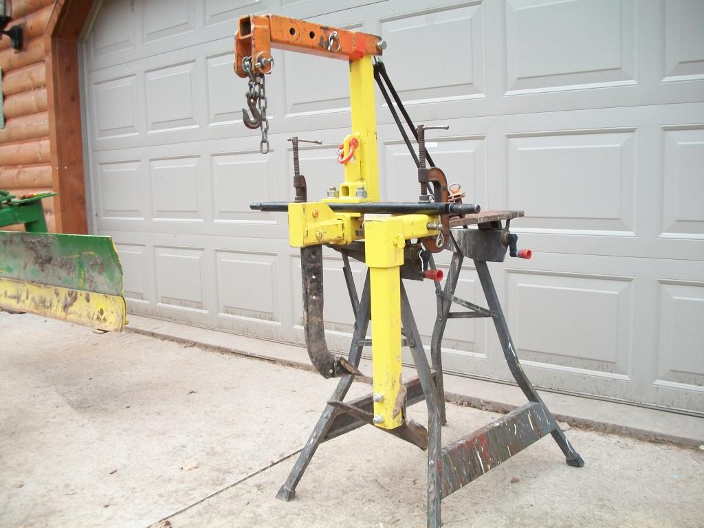

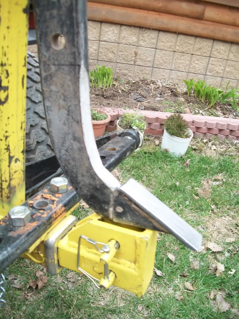

I built and use this home made sub soil tool as a rock / root grubber for pulling things from the yard.
I have also used it to cut some places for run off rain water to drain to.
The section of sharper edge helps a lot.
I'm pulling it with a 24hp JD855 hydrostatic.
It is simple and cheap to build. I'm sure there are better implements available, but I'm sure more $ also.
The potato plow type tool in the first picture also works well in garden type ground.
Good luck
