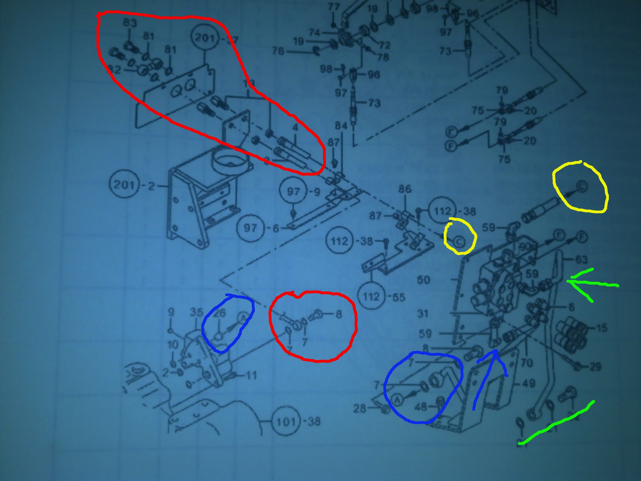

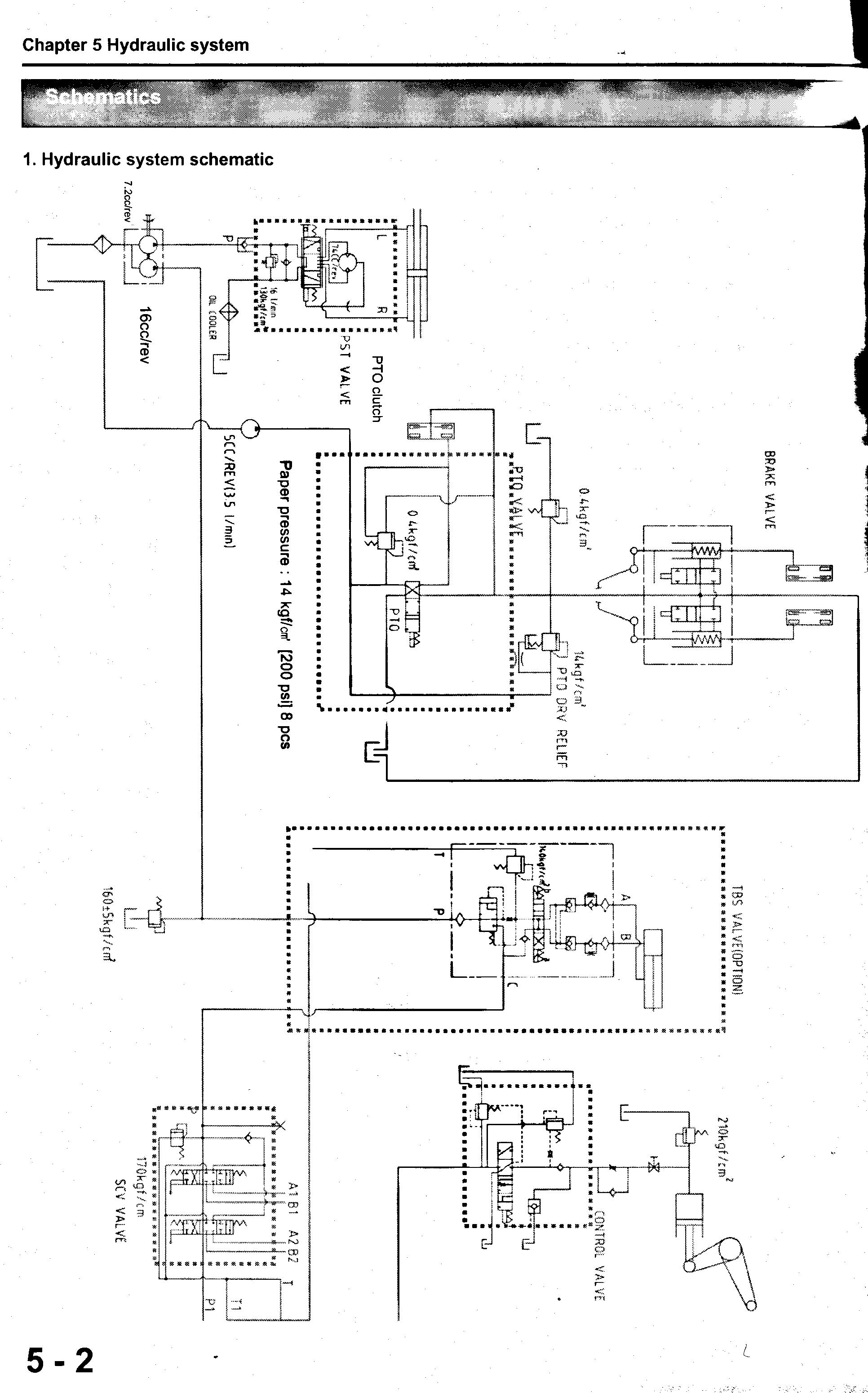

Something does not appear right. The purpose of the tank port on the FEL is to send the expended fluid to the tank, not downstream, as it is low pressure. However the tank hose could go to the back and tee in with another tank hose and then go to reservoir/tank.
Can you provide a complete path from pump to tank. There has to be a logical flow of the hyd fluid for things to work correctly.
Can you paste a schematic of your hydraulic circuit. from your manual if possible.
   / 3 rd function on a branson 6530
#22
He is a picture from the service manual hope this can help. I put some color to the matching in and out put.

I found a new drawing that could help.

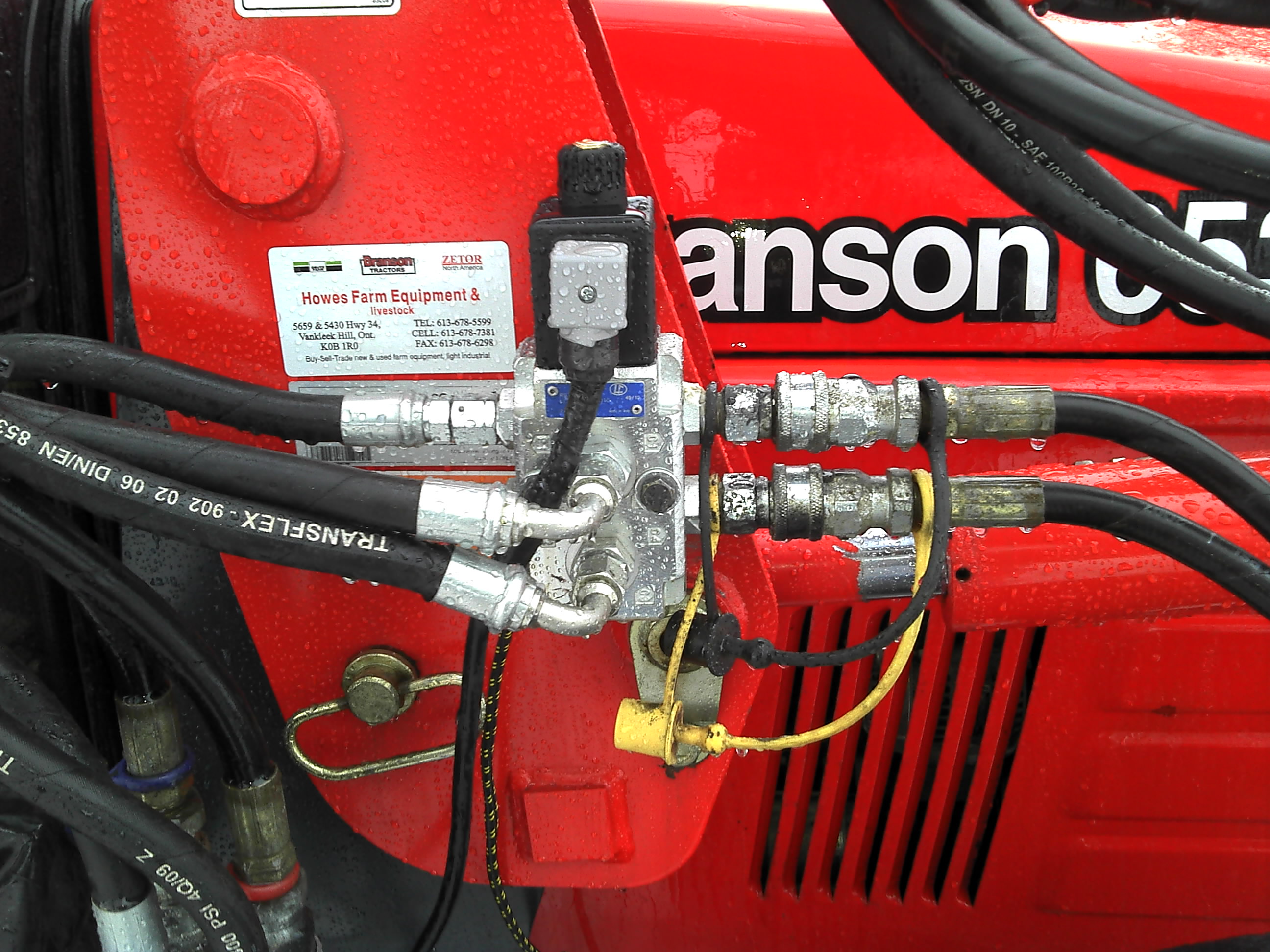

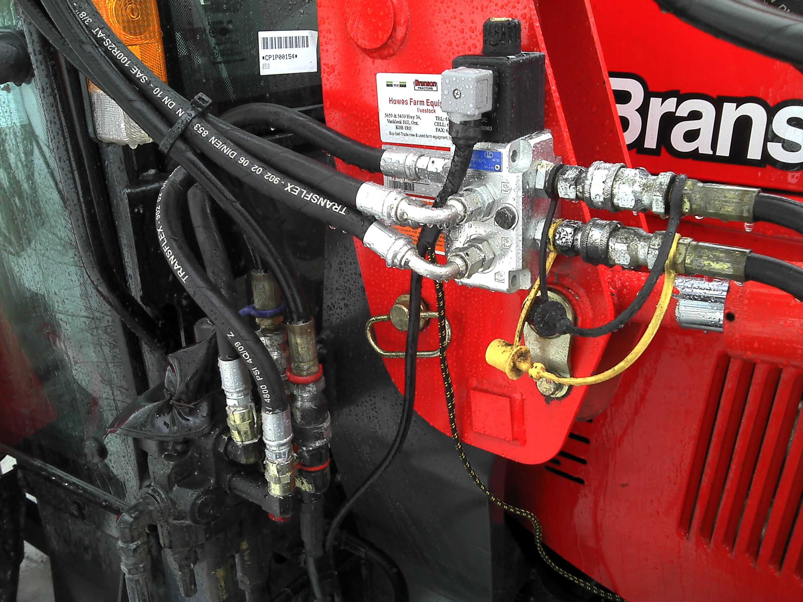

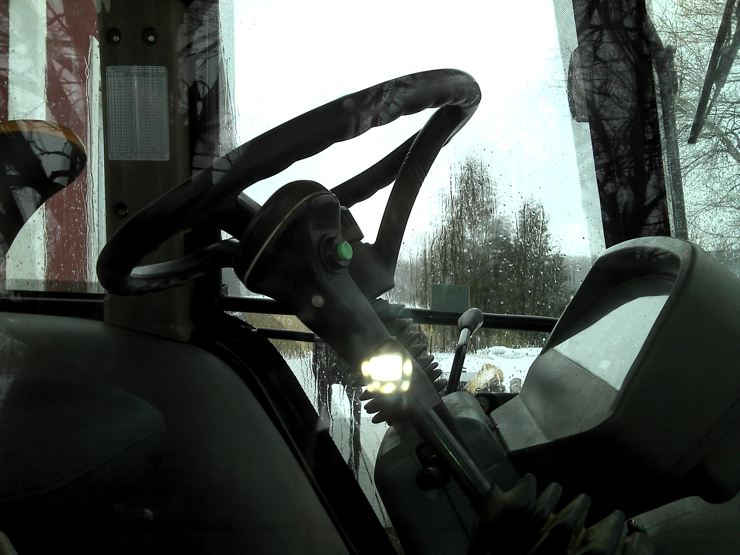

Here are the pictures. It is not exactly the way I wanted it. But it does the job pretty well.
In warmer days I will relocate the valve to be able to remove the loader.
