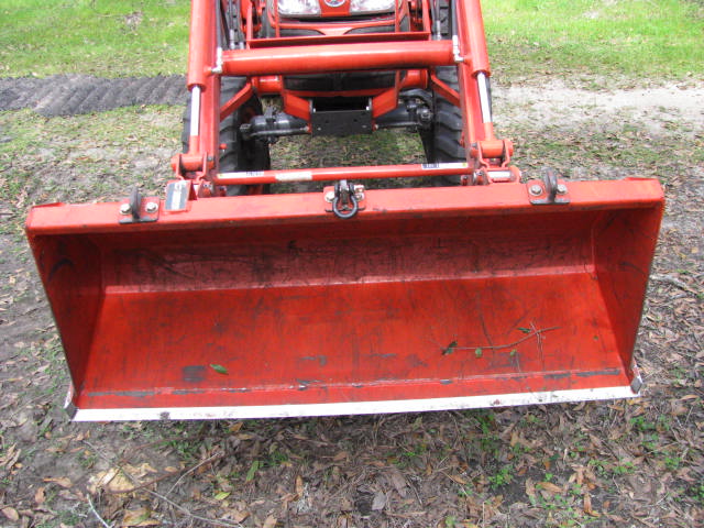

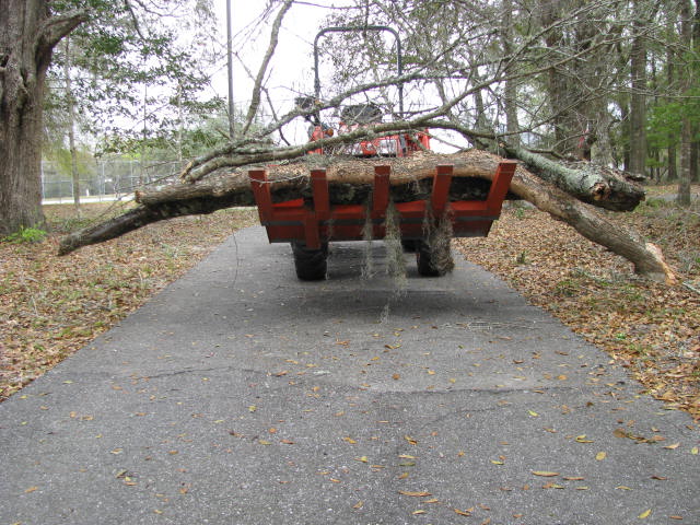

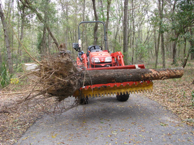

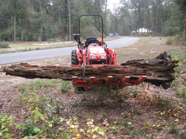

1. Toppling small trees and raking debris into piles: Ratchet Rake for sure.

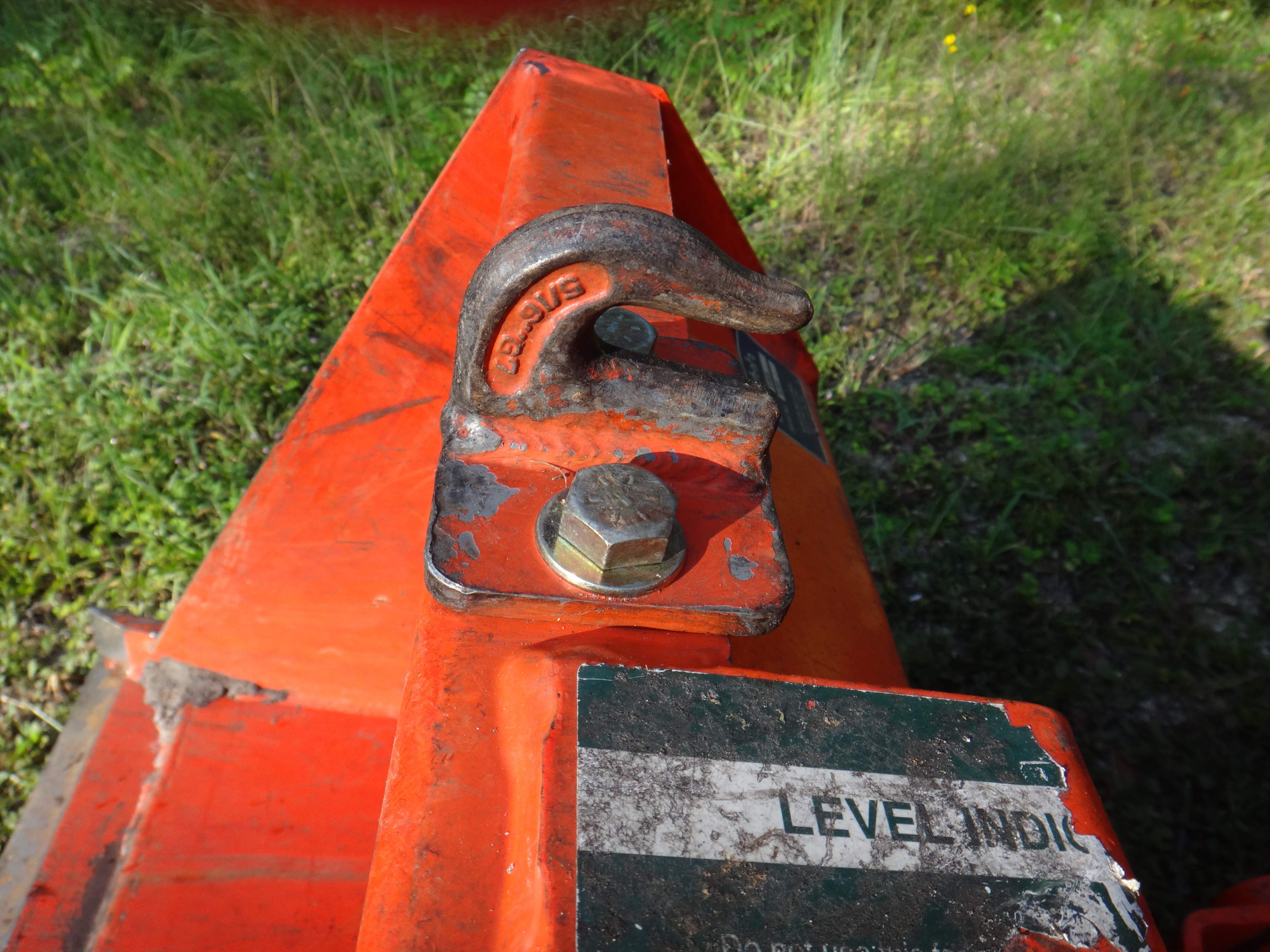

2. Moving logs with FEL: Grapple or Chain Grab Hoods on bucket plus 5/16" Grade 70 chain with Slip Hook on one end, Grab Hook on the other. You must have ballast on the Three Point Hitch.
I have Ken's 5/16" Bolt On Grab Hooks and I recommend 'Ken's' as easy install, immovable, indestructible.
3. Pulling or digging stumps: Rent a Mini-Excavator as needed. Bulldozer will do but tends to leave a mess.
4. Three Point mounted Log Splitter: Cut and buck logs in the woods, move sections in FEL. Buy an ELECTRIC splitter and split at home. Simpler and cheaper than a PTO splitter.
