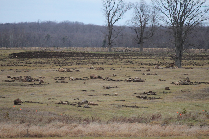

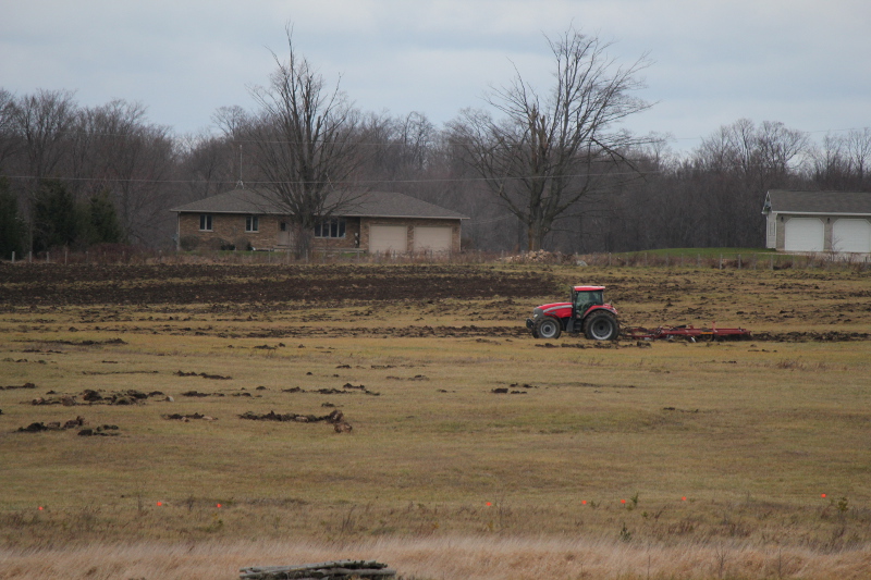

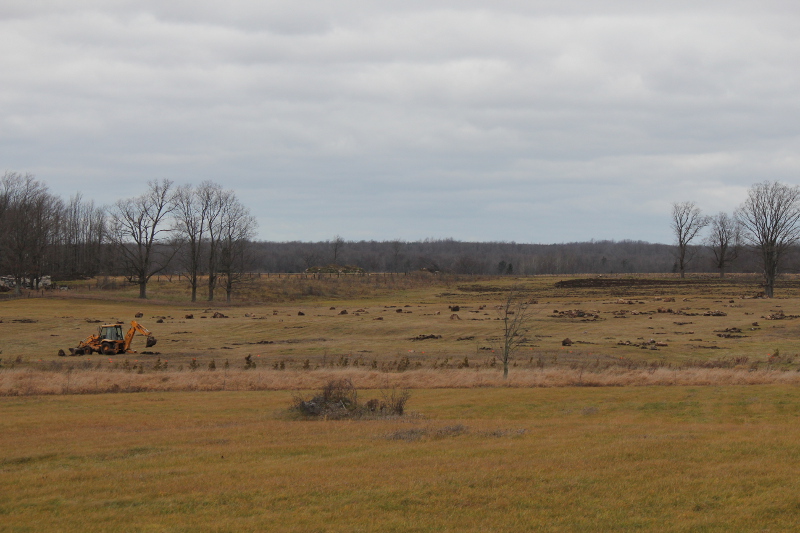

Yesterday, we pulled and moved hundreds more rocks. Today we started using the disc. It found a few rocks in the 10 first acres. Much better than we thought. Still a lot more rock to dig up and move. Hope to have the entire 30 acres disced by tomorrow evening. After the entire 30 acres has been completely disced up we will run the rock picker through it to pick up all the smaller rock missed with the backhoe and forks.

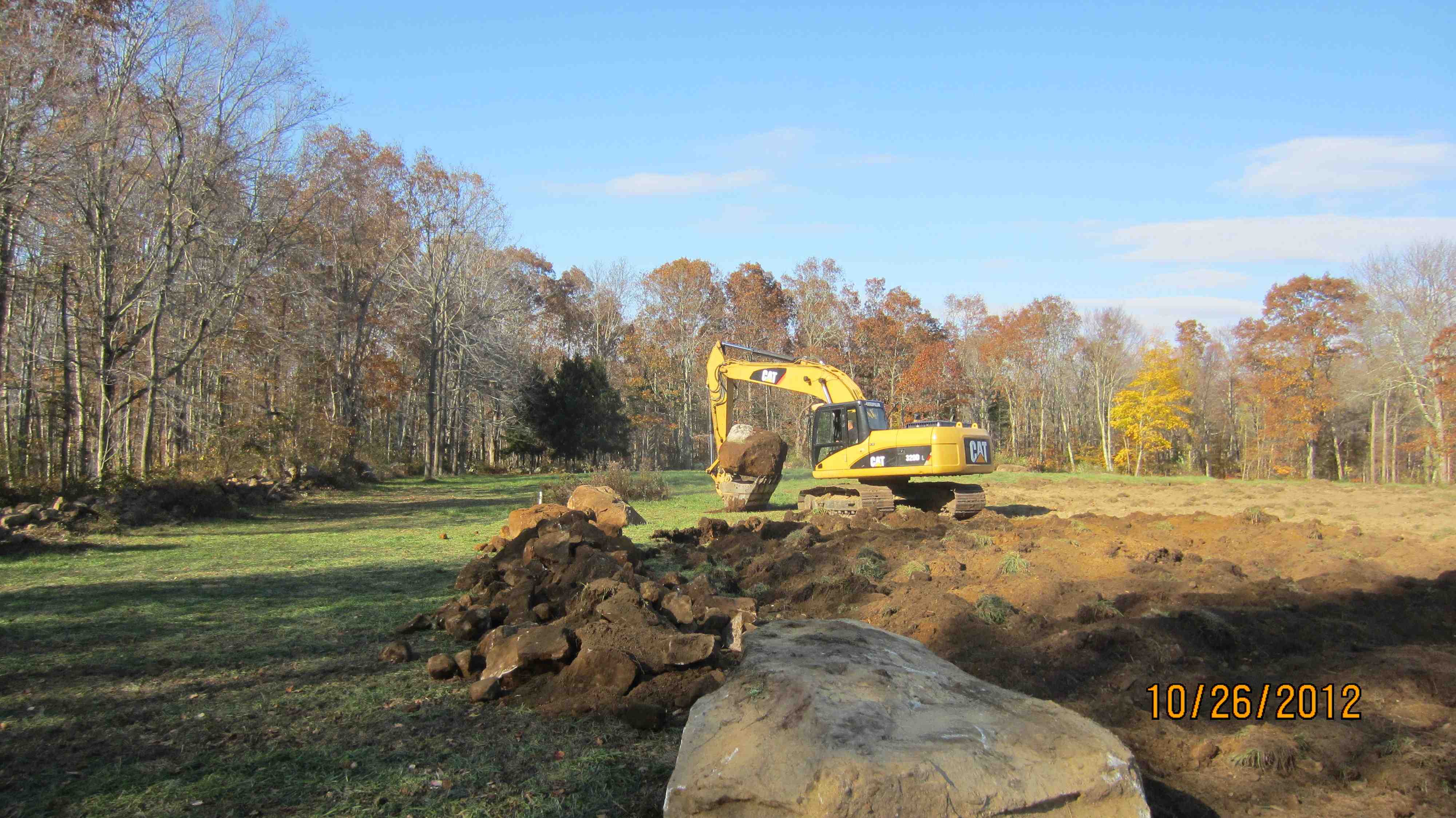

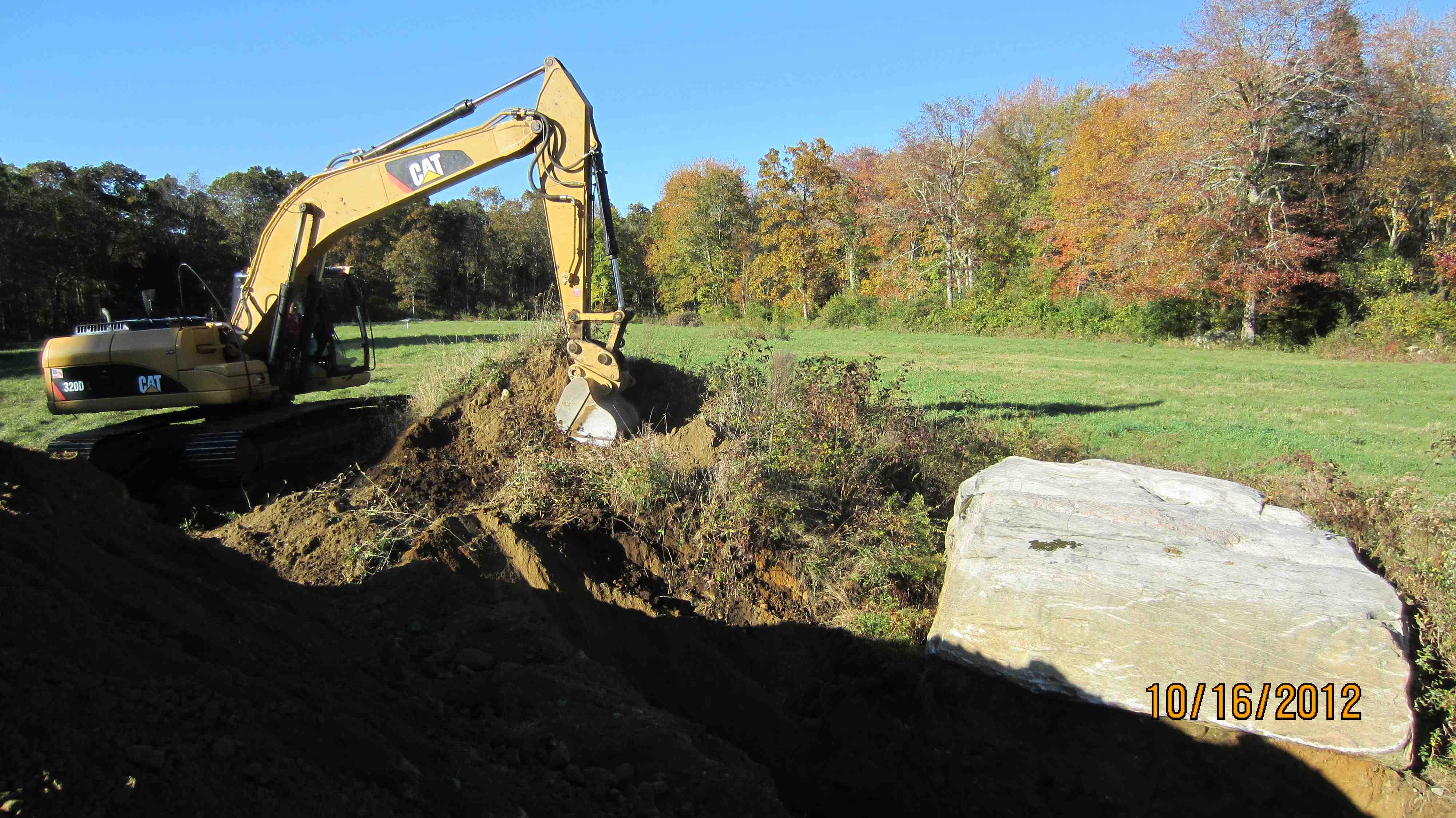

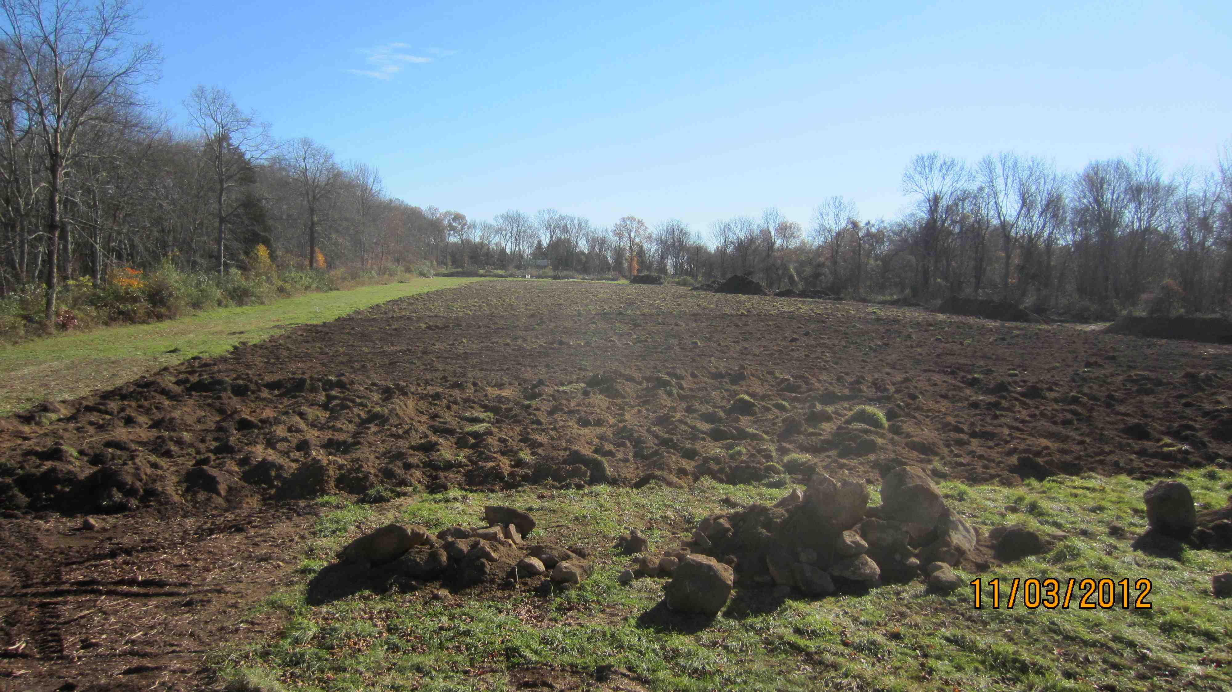

Luremaker - Nice pics ! I can relate to this thread as I'm nearly finished with my de-rocking exercise for 4.5 acres that will be a vineyard next year. I chose to take out, or bury, all rocks larger than a cantaloupe down to 3 ft. This was necessary as we will have the vineyard tiled and planted with laser guided planter. Our largest was ~ 40K lbs boulder which we buried deeply. When finished, next week, I think the entire de-rocked field with some reshaping will have taking 120 hrs. Attached are a few pics. Good luck with your project......Gary

Thanks for the pictures Hoaleguy. That is one big job. Farmers with rock free land just don't know what they are missing. Rocks build character and empty pockets! Do grapes require full sun?
We thought of burying my rocks but I just have too many. Still have at least another 16 acres to disc and there is now 6 inches of snow on the ground. Snow makes it harder to see the rocks. Hopefully the snow will melt away in the next day or so and we can get back to it. We ave around 40-45 hours in it now and I'd say another 40-50 hours to finish. Unless the weather improves we will have to wait until spring to run the rock picker and that will be another day maybe two.
I see your fence lines are just like mine piled with rock.

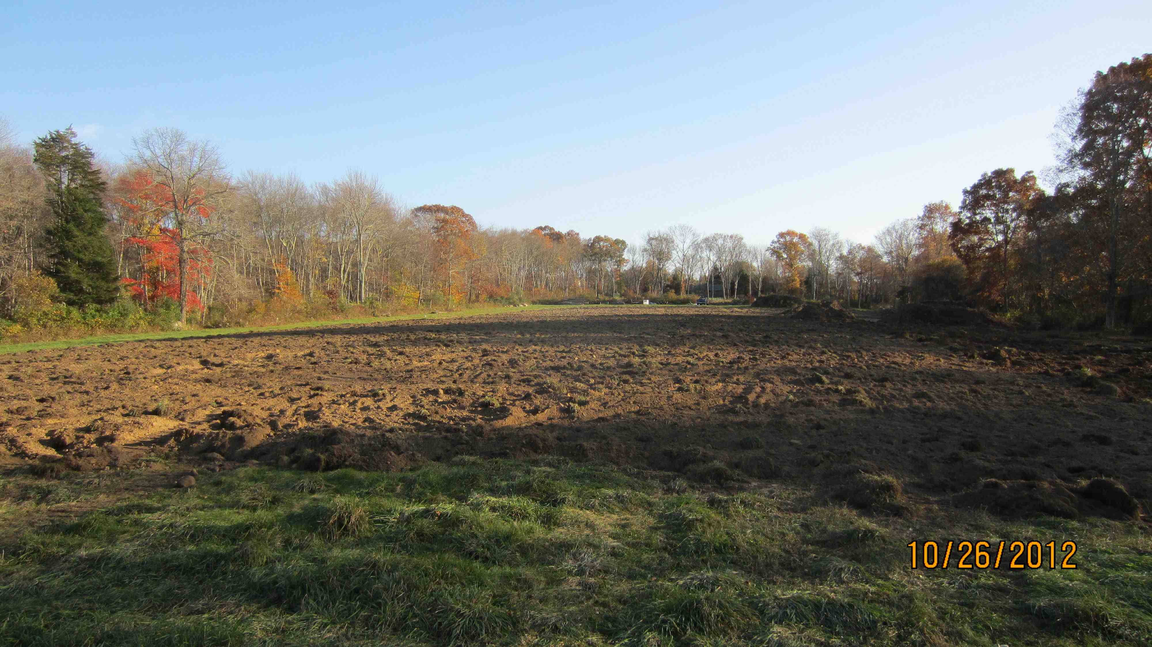

Luremaker - Yes grapes do need good sun. The shot below is looking south. All trees to the left in the picture(east side, another 3 acres) are being removed to get in early morning sun for quick drying of morning dew. On the west side I'm planting an early ripening variety such that a little late day shading should not affect it much. In recent months I've been meeting growers in the Beamsville Bench, Niagara-on-the-Lake, and Prince Edward County areas to discuss cool climate viticulture. They do a terrific job with viticulture and winemaking such that many of us down in cooler areas of the eastern US have much to learn.
The bigger rocks I bury below 3 feet and the smaller rocks end up in my currently ugly windrowed stone walls on the edges. Stone walls can look terrific but require more work than I can devote at the moment. The invasive plants seem to take hold quickly in the rock walls.
Hope you can get back to your project before full Winter sets in. I probably have another 2-3 weeks open to complete the current phase of work. Next Spring I will de-rock another 4-5 acres to get it ready for planting in 2014. Good luck on your project and look forward to more photos...Cheers, Gary

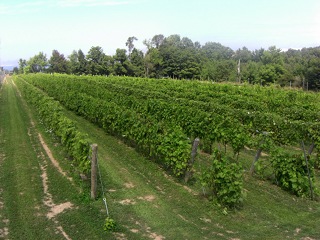

There is a local winery with 25 acres of grapes vines. Years ago, I was surprised to here they they were going to plant grapes with our cold winter climate. There are also several more wineries south of me in the large clay belt east of Lake Huron.
Welcome | Coffin Ridge Boutique Winery
