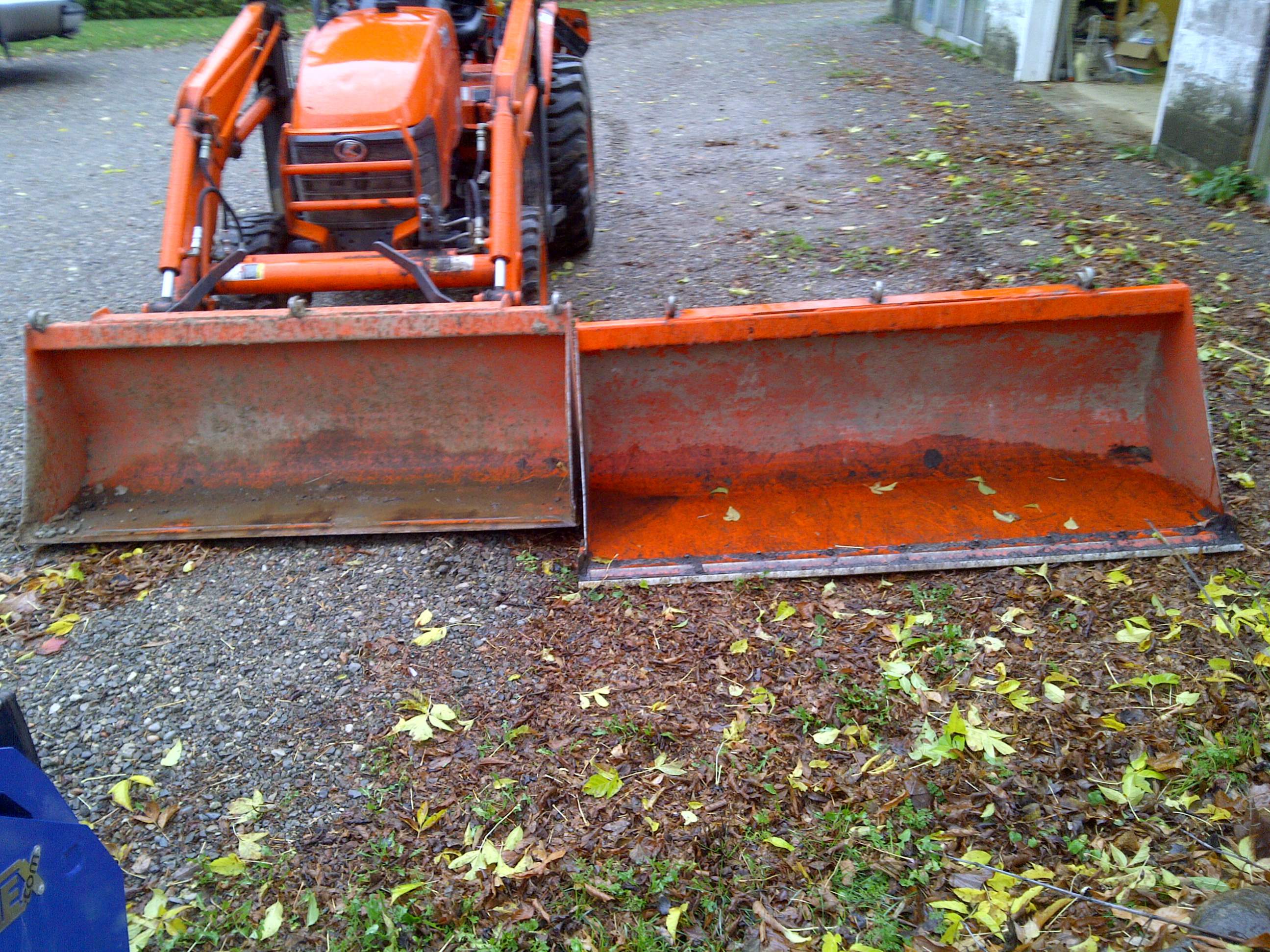

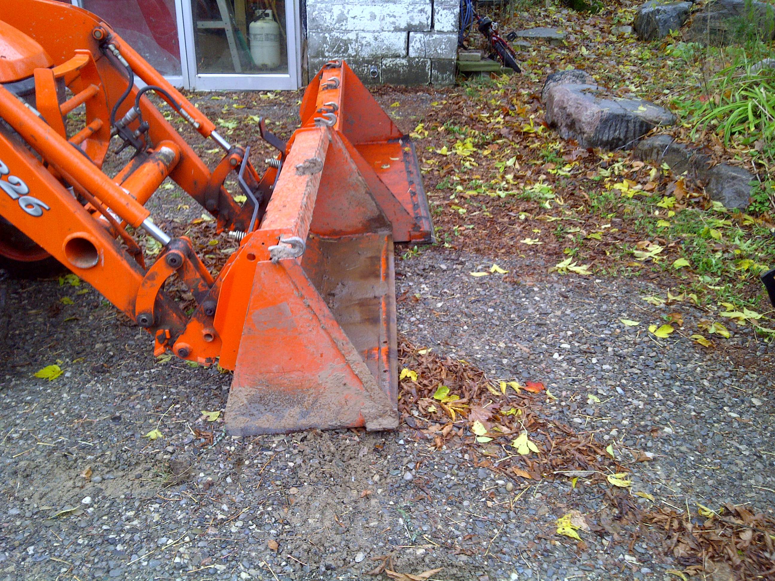

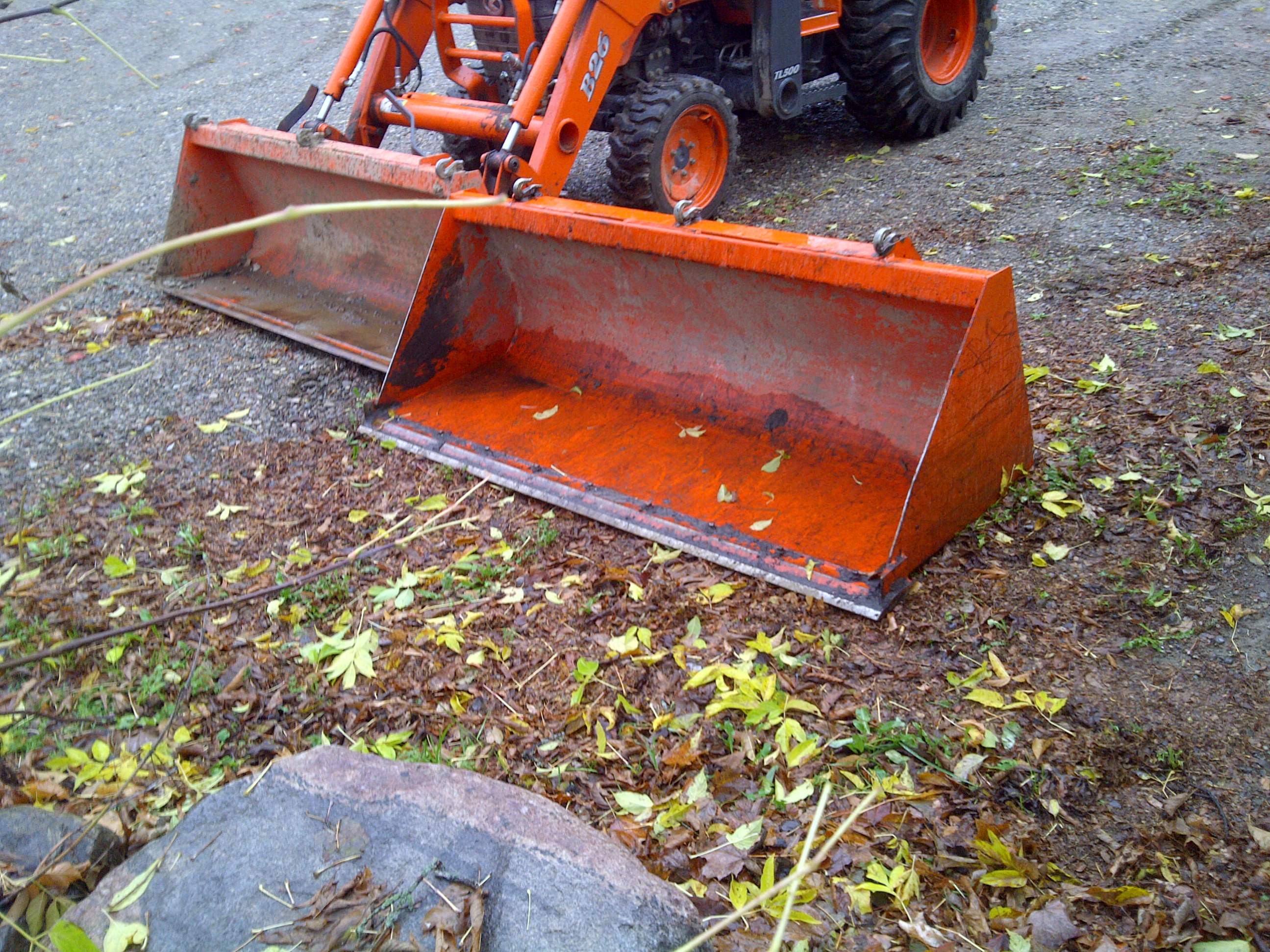

There is a a model TL2144 66" light duty bucket available for the B26. It is somewhat like a skid steet bucket in that it is not much higher than the standard B26 bucket but the bottom extends about 6" further forward.
I purchased this bucket and quite liked it on the B26. Despite the fact that it is "light duty", I purchased the cutting edge with it and moved a lot of dirt. The B26 would not lift as high with a full bucket of dirt in it but it was high enough to get in my dumping trailer and I could fill it a lot faster so it became my default front bucket. I like it so much that I kept it to use on my L45 when I sold the B26.
Attached are a few photos of the original and light duty buckets for the B26.
