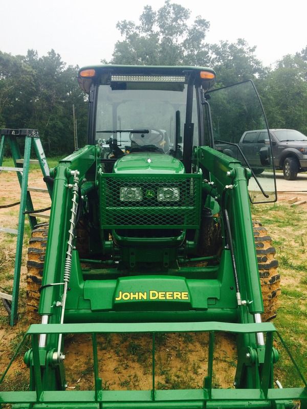

I haven't seen a light bar installed on the front of a new 5 series deere cab tractor and I can see why. It was a pain to design a backet that would fit in the stock mounting holes and give plenty of clearance for the light bar. Took a couple hrs but it's done and I love it! One of the best mods to the tractor yet. I have to do a bunch of work at night after my boy goes to sleep (baby monitor has great range) and with the stock lights it was difficult at best.
Only negative is it kills my fm radio reception.

Looks great.My LED,s knock out my FM radio when turned on also.

Nice looking! The led light bars do emit a RF field that I am not suprised knocks out FM reception. Fluorescent lights will do it also. I put a 30 inch LED bar on my ROPS and it works great. Almost too good! I believe there are ballasts in the bars that are causing the issue. Try taking your antenna and connecting a wire to ground temporarily and see if that gains your reception back. Let me know.

Yours looks great! I'll try the grounding issue next time I open it up

Thanks. I recommend this if your going to do anything at night. Made a world of difference. When the days get shorter I get way behind. Hopefully this will help me keep my head above water when it get dark

This is exactly what I was going to do... How did you mount it to the ROPS?

I'll have to try and take some pics Monday. It mounts in the stock holes for the option front cab lights. The bracket I made lowers it and brings it out and in so it doesn't interfere with the windshield while still giving good visibility.
