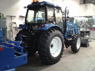

I paid $750.00 to have the rear tires filled with Agrim-lim 50 on my LS7010. LS7010.jpg
   / $300 to load rear tires #27
Rim Guard (-34f) is about .28cents a gallon +/- and can only be installed by a dealer.
I know this price is wrong. At that price I could fill my 7010 for $45.36 (162 gallons). Even at 2.80 per gallons only cost $453.60. That sounds more like it but still only 60% or what Ralph Copp paid for the agrim-lim which I have heard nothing about. I wonder if it is a calcium chloride type or some type of lime based.
   / $300 to load rear tires #28
I paid $750.00 to have the rear tires filled with Agrim-lim 50 on my LS7010. View attachment 301225
Actually a little mis-spelling there. It is Agri-Lim and is only available in Ontario Canada according to their website.
Seems a bit more expensive than the Rimguard but might have more weight. Web says it not corrosive and good to -50C.
Agri-lim inc.
