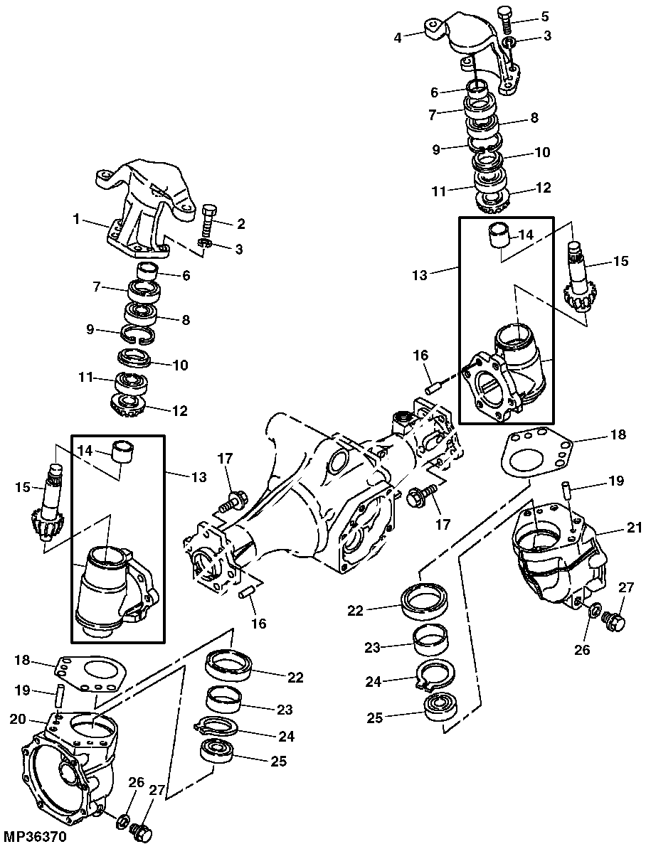

PCABE thanks for posting those pics.
That is what I don't want.The fender is too far away from the tire,but has to be that way so it clears the turning radius. I want the fender to rotate with the tire,that way it will be much closer to the tire. Hopefully I can find something (fender) with the same radius and width as my tire.
Does anyone know if the steering arm,part #1 is weldable? If not, I'm sure it can be drilled and tapped.
Greg

   / 3000 SERIES FENDERS #16
Greg
Don't know for sure, but by the shape of it I suspect it's cast, it would be better to drill/tap it IMO.
