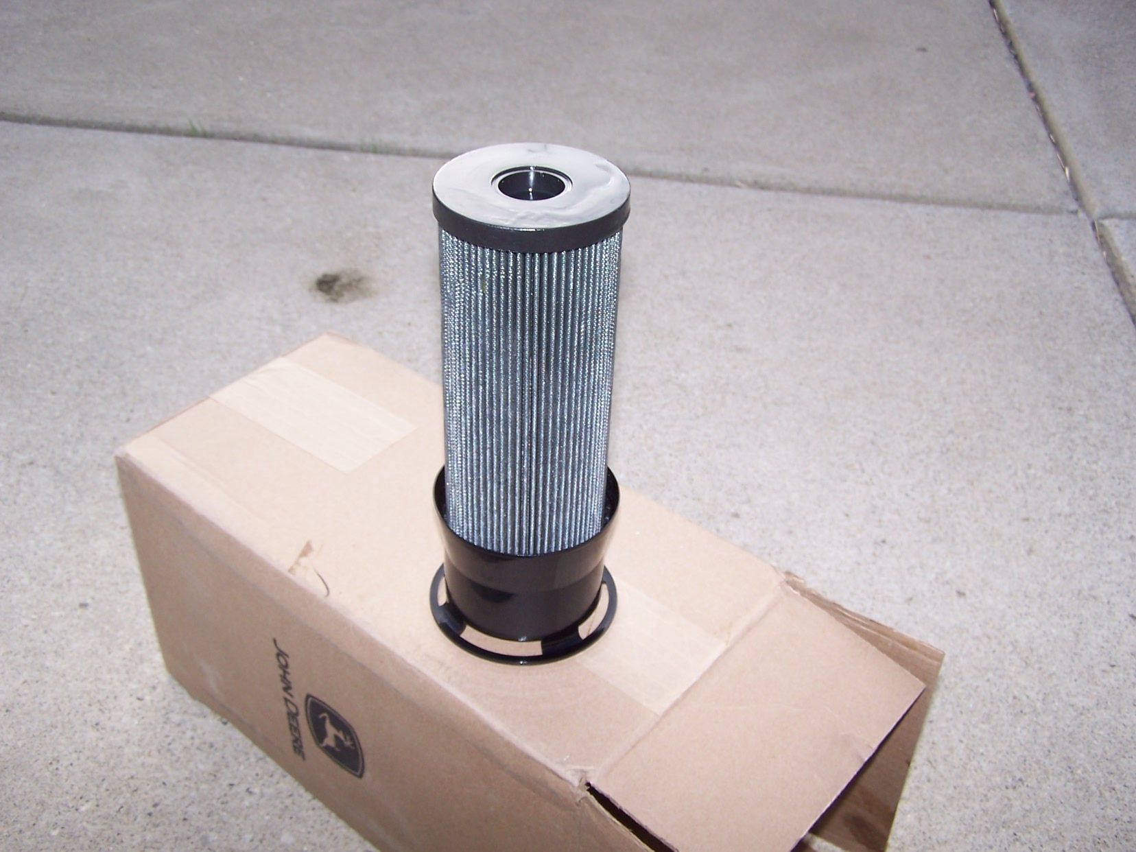

The hydro filter for my 3320 is about 9" long and 3.25" in diameter with fine corrugated steel mesh (looks like stainless) rather than the paper mesh you see in an oil filter. I paid $72 in June 2006 so $85 today sounds right. I did receive a free filter pack from JD in Oct 2006 which was valued at $115 at that time.
Given that my hydro filter is good for 400 hours and considering what I have invested in the tractor, I'll stick with the JD filter.

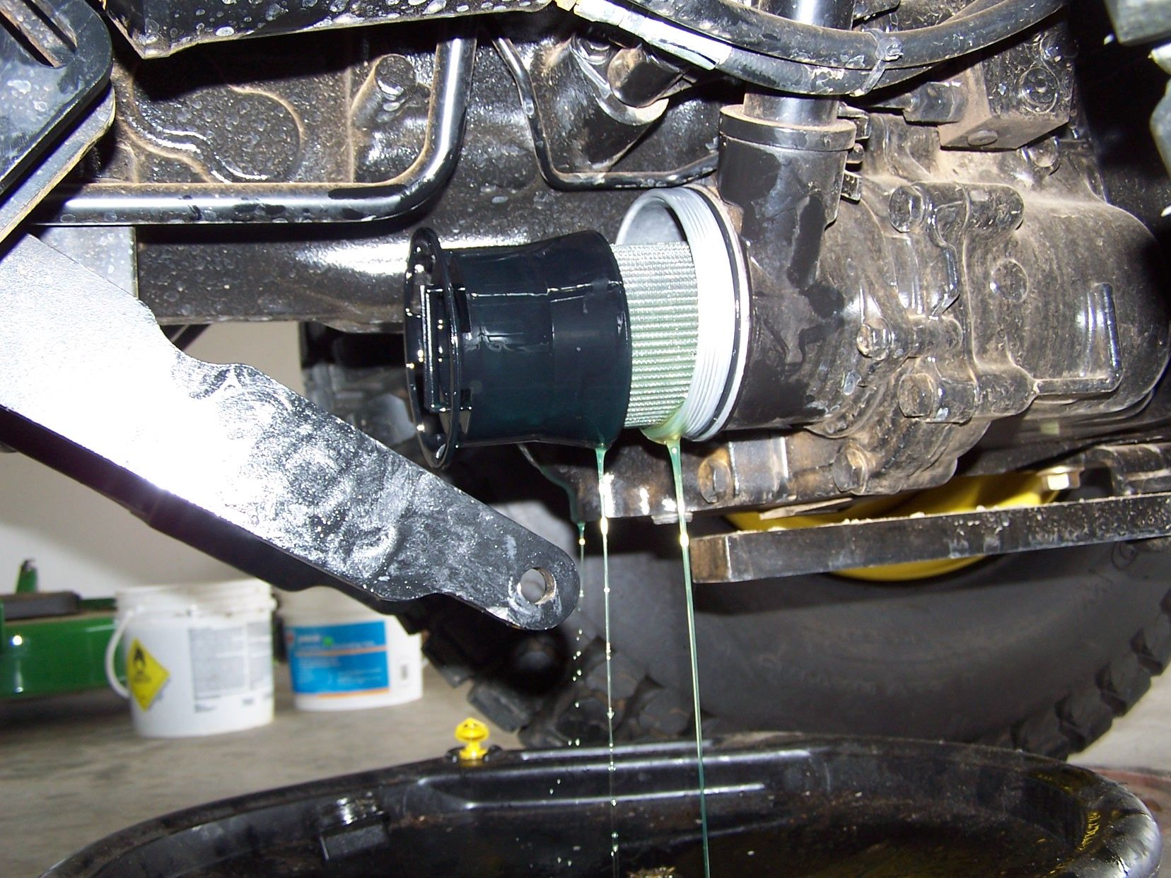

Here she is,the infamous $85.00 filter, in all her glory.
Behold.

Killer, I know you've mentioned it before but would you share with us once again what tool you used to remove the filter?
Thanks.

Here is my approach:
On my 3320 the hydraulic filter cap is 4.5" in diameter. I got a large band wrench at VIP auto designed for Cummins/Detroit filters which worked. A standard oil filter wrench will not do it. My filter case was on very tight, the big band wrench just barely got it off.

The 3X20 series has just the sump filter as imaged by Killer.
