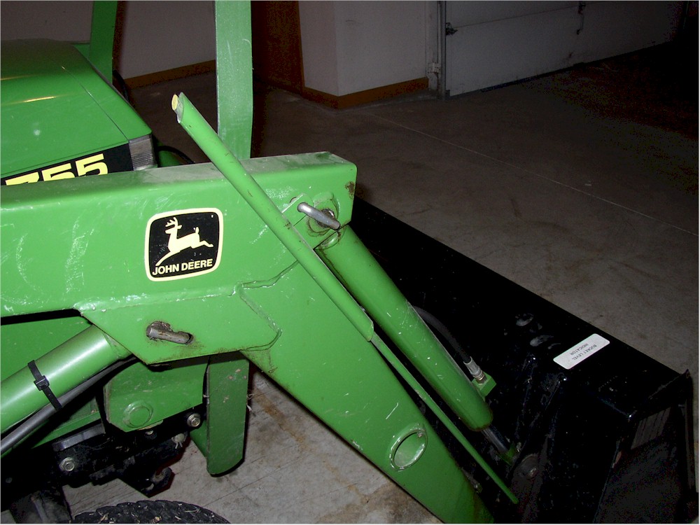

my 420 is missing the rod. it has the 'holder', just not the rod. when i first used the loader to try and move some dirt piles, i had a hard time telling if the bucket was level due to the shape of the rear of the bucket. when level, it looks like it is 3 inches off the ground due to the bevel in the back. have used several loaders, and never had a bucket shaped like that. i later realized that the top is parallel to the bottom, so that helps.
i am going to make a rod (deere wants $40 for one), just to see how it works. i think i will make several angle marks on the rod too, so i know when the bucket is tipped down at...say 20 degrees.
one question...does it work at any loader height? is the geometry such that when raised, the indicator always points to level? or does it only work when the tractor wheels and bucket are both sitting on the same plane?

No, it doesn't really show when the bucket is "level" but does show when the bottom of the bucket is parallel to the ground at the ground. While above the ground, the 420 FEL doesn't maintain "level".

I find the indicator useful when working on a hard level surface, where a small change in angle makes a big difference for what you are doing. Especially when just starting into the load before sensing the feel of the bucket.
My old 70 loader came standard with just a label on the bucket indicating the top was level with the bottom. The optional indicator was different than current ones, with a rod emerging from an angled tube to show level. After setting up the tractor for level operation, I cut the rod even with the angled top of the tube and then painted the tip yellow.
