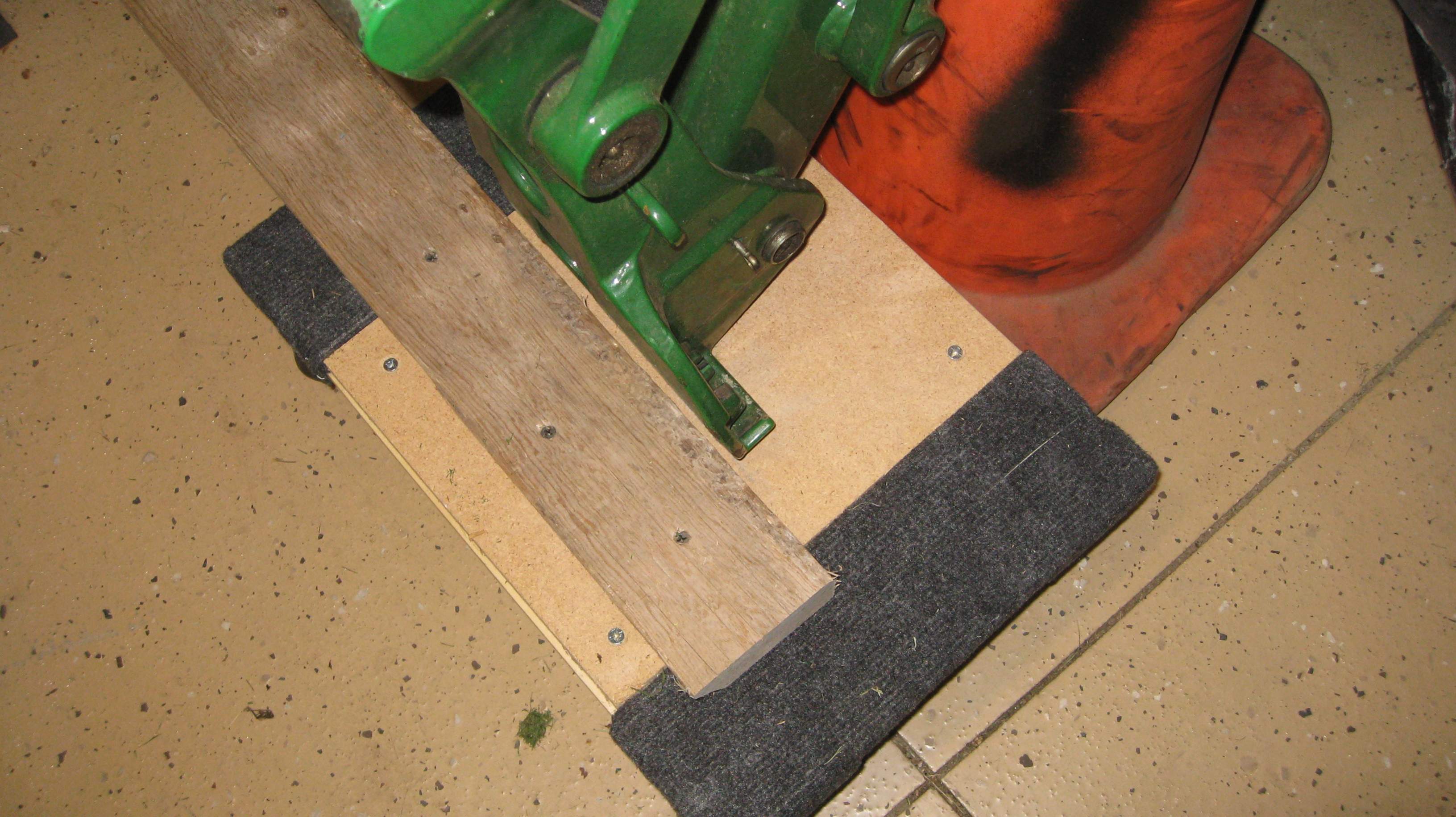

You know i was thinking about doing the same in my shed to position the loader in a different spot to provide more room in the shed for other stuff.

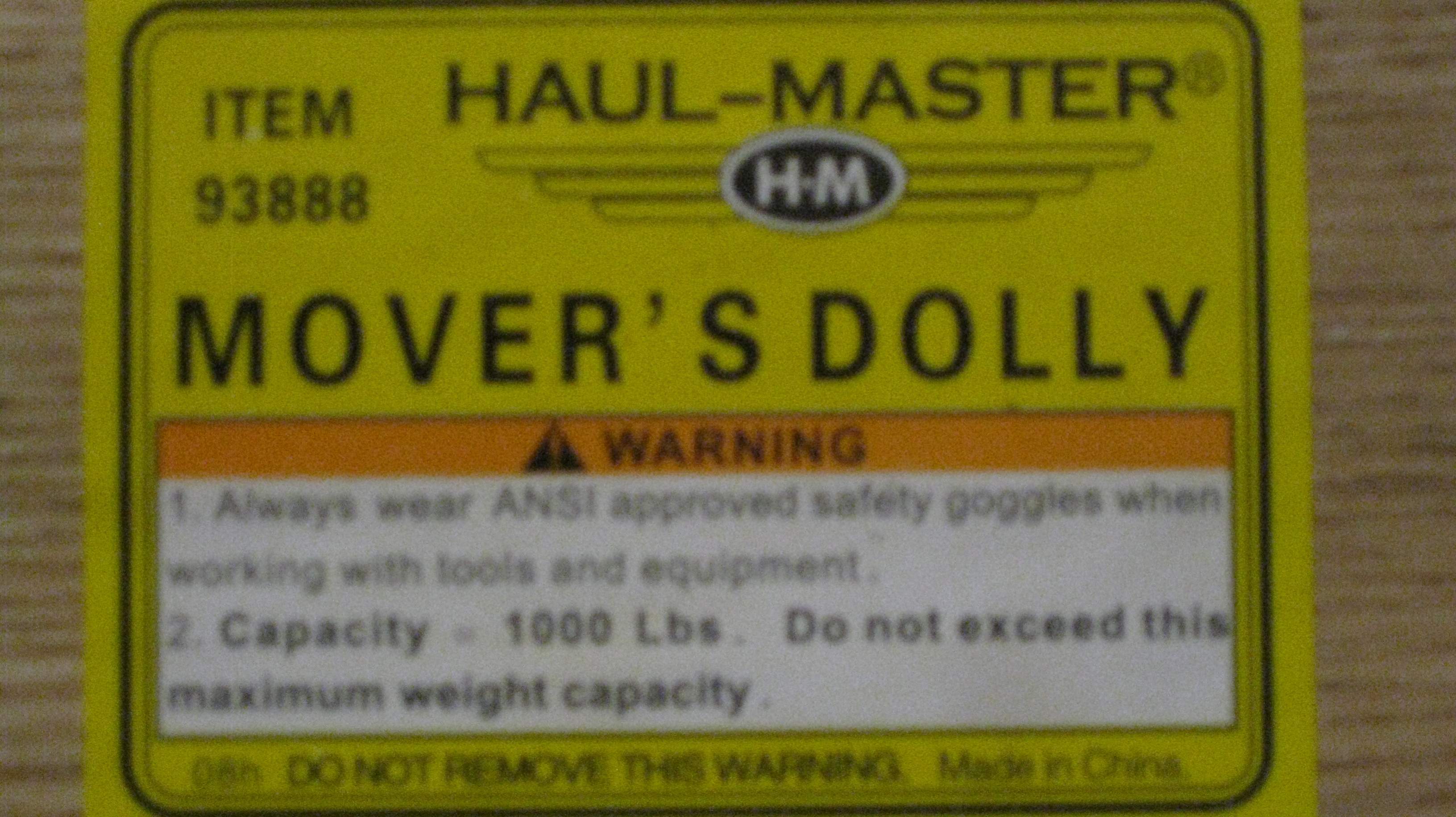

what type of dollies did you use? What did they cost and where did you get them?
Got the dollies from Harbor Freight around thanksgiving, for about $10 each. Added some plywood reinforcement between the carpeted rails and swivel wheel in the middle. Attached a 2x4 between the two dollies on each end to keep them moving in unison. Very crude but effective. Used them for the bucket and pallet fork - in order to move the items around the garage as needed.
Ok, that looks good and pretty easy to get together. Thanks for the pics.
