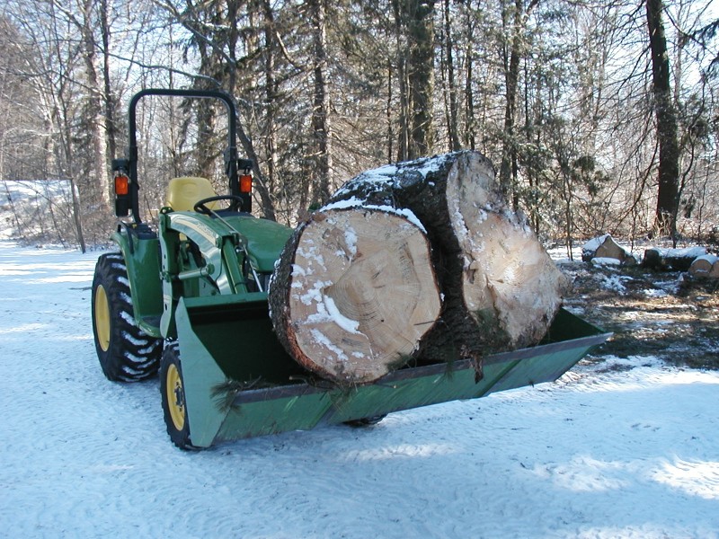

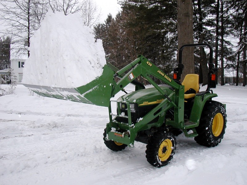

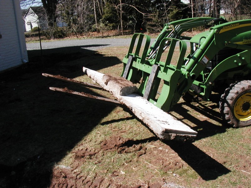

I have a 300 CX and can't imagine what could make it that far out of whack, it would bother me if it was just a little out even if it didn't effect safety or performance but with yours I wouldn't use it for any critical applications until you figure it out.
What do you use it for? I use mine for some pretty heavy stuff like in the pics.

JB4310 said:
I have a 300 CX
In one of the pictures you posted, there is a 430 loader, not a 300CX?
I wondered if any one would catch that, My 4310 came with the 430, I wanted the extra lift capacity of the 300CX which is considerable so I found a dealer that only charged me about $450.00 to trade up.
