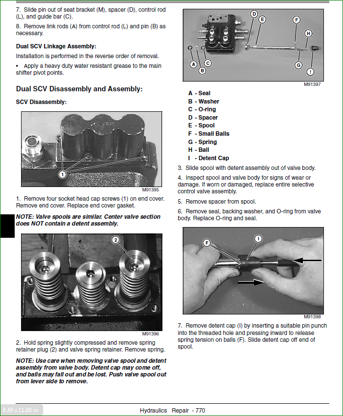

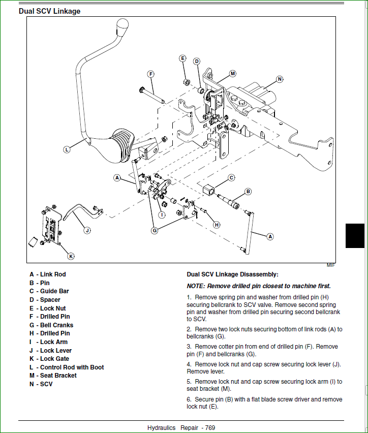

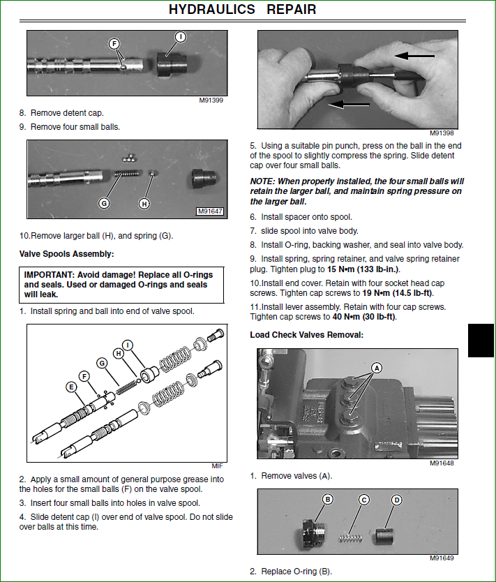

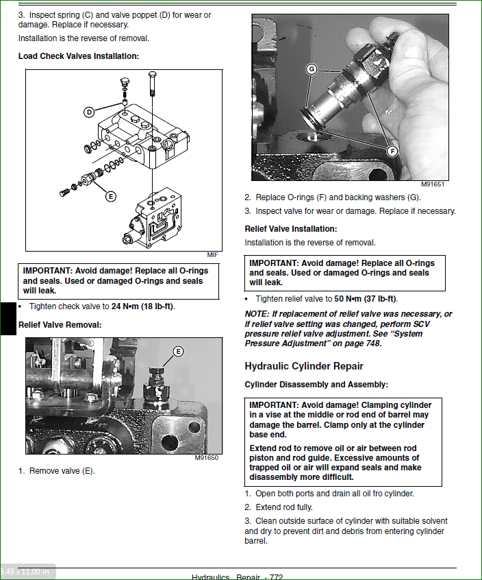

Enclosed are repair shots to cover the "spool" problem area that is suspected. I hope LD1 or someone may shed light of the problem. On Page 769 I assume the problem is inside "N" labeled SCV. On pabe 770 shows the SCV linkage dissembly/asm. Page 771 shows the area disassembled. I do not know if I tackle the problem or send it to the JD repair shop still debating.
Hope the attachments work because edit alludes me. -----Fuseboxer

If the linkages are all still connected and when you operate the stick it is actually operating the spool, then yes, the problem would be in that valve.

REPAIR COMPLETE,,,,,,, The "load Check Valve" as shown on page 771 and top of page 772 was blown. Hole clean through the small rubber poppet valve. Three valve spools with three load check valves (see service manual above page 771) When the system is abused it blows a hole in the very small rubber plug and the hydro pressure goes to bypass. I removed the very small rubber check valve with a hole in it and replace it with the third valve spool that has no linkage and is not being used unless you have more than a standard bucket and lift arms. Grapper bucket I believe uses the unused valve spool. I went to my Mid State John Deere dealer and they wanted $45. for a ten cent piece of rubber. It is about the size of the rubber eraser on the end of a No. 2 wood pencil. It is dimpled and recessed on both sides and a small spring holds it in place. They only sell it as a Valve Kit Part no AM100201. I hate to put my tractor seat and plastic shield below the seat back together but refuse to pay $45. for a ten cent part. My unused valve spool will not work in the future if someone needs it to. I did degrease the area under the seat while apart. The curl and arms work perfect with the unused valve spool check valve removed. Thanks LD1 and others for your help. ---- Fuseboxer --- Feels good to get lucky and repair my JD4410.
