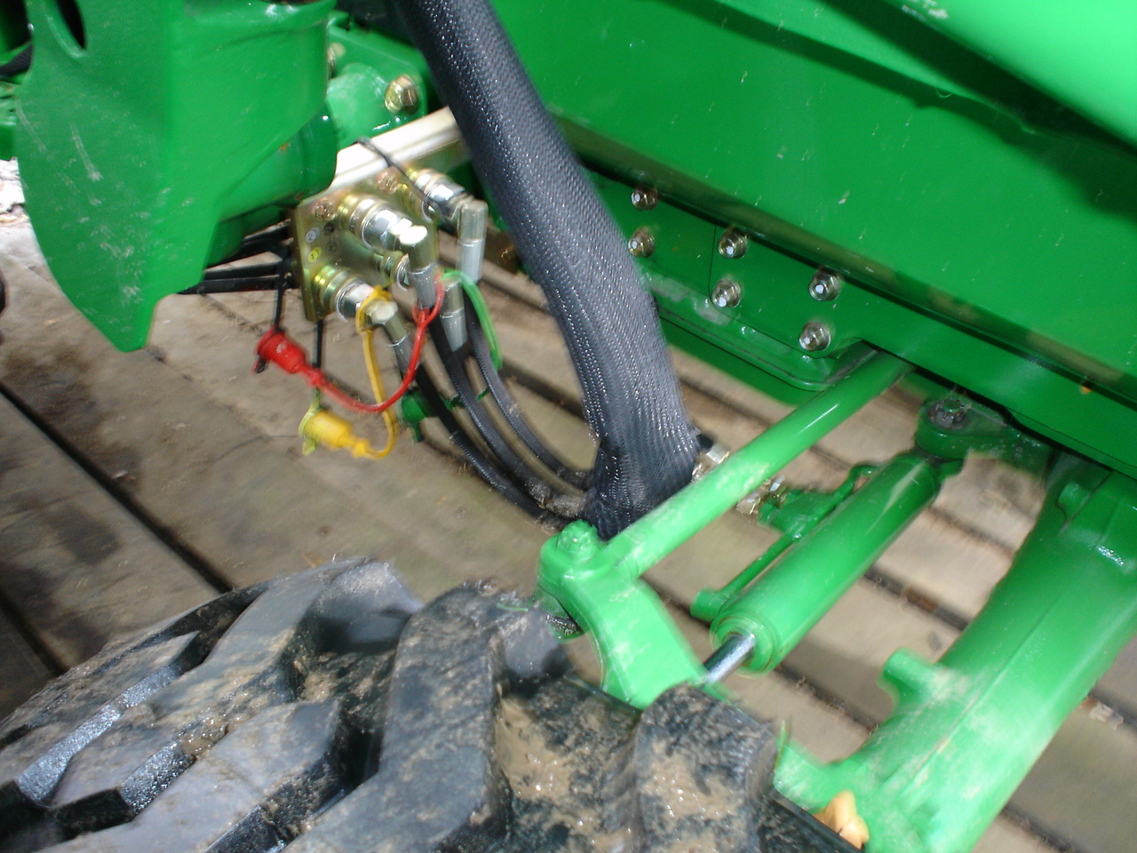

   / 300CX Problem #8
So these 90Deg output fittings should be facing upwards?
   / 300CX Problem #9
Champy, on the 3000 and 4000 series. Yes,up.....Actually the 300 loader manual has a pic of the quick attach hyd fittings for a 790 without a 90 degree fitting on it. It shows a straight fitting running into the two x two connectors. I assume the 990 would be the same as a 790. And just when you thought you had it figured out. It looks like the straight fittings would work better than what you have in the pic.
