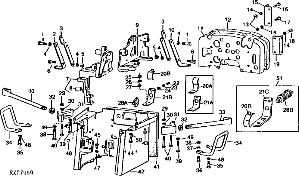

JD 3010 doesn't have a pto safety switch but it does have a neutral start switch(parts key #28A or 28B) under cowl by trans gear shift lever.

I have an L3010. I'll take a look in the morning and see if I can maybe help you out some.
/ 3010 access pto switch #4
Disregard my reply as I didn't read(comprehend) the part that stated KUBOTA. Duh

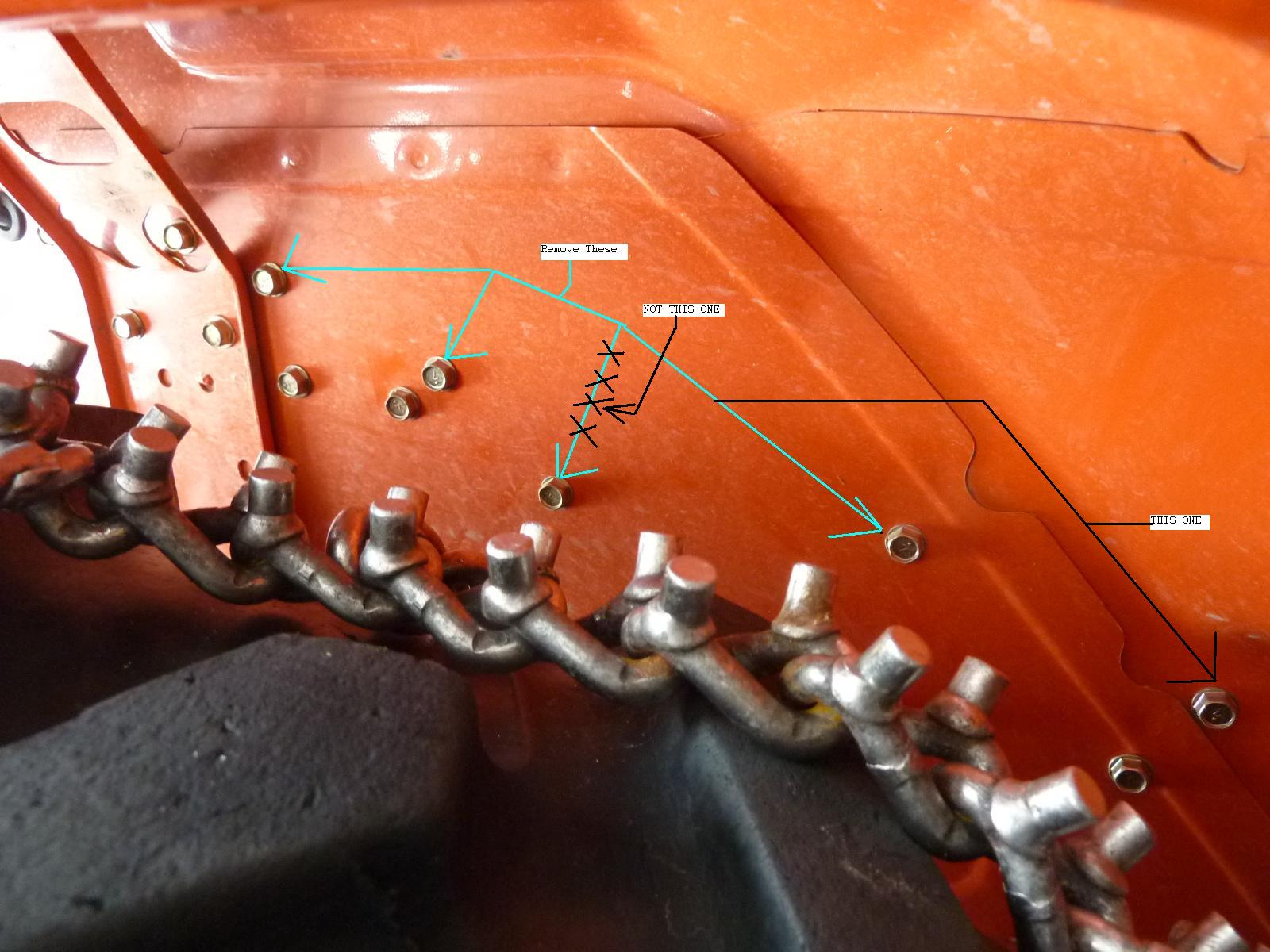

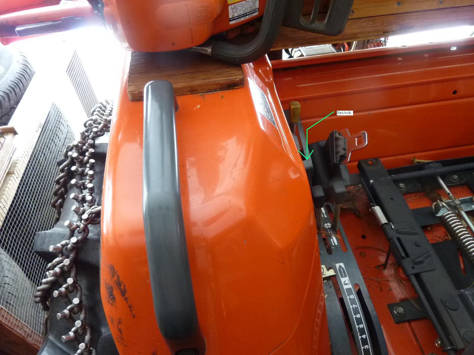

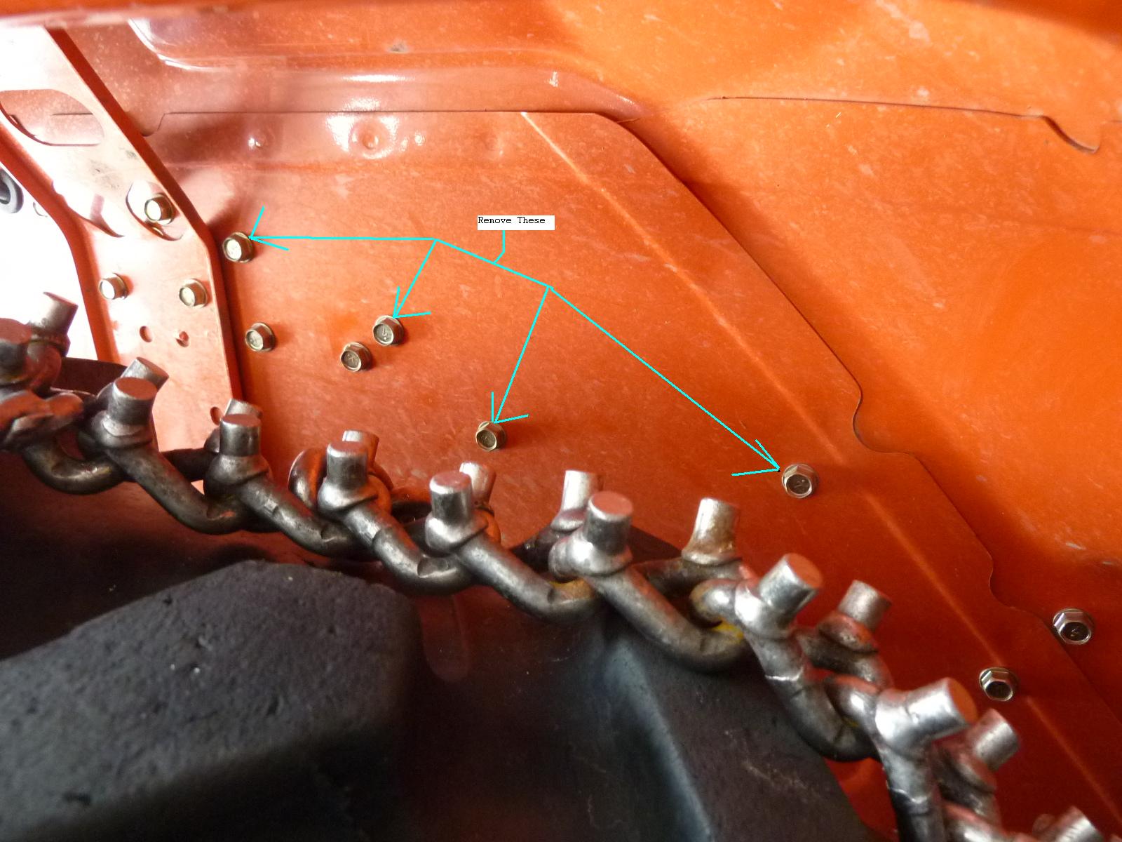

The switch is right under the grey cover plate where your PTO lever is. It is at the PTO engaged end. So if you do any "wiggling" do it with the lever in the engaged position. Maybe frozen ???
To get access to the switch remove the grey cover. There are 4 bolts behind the tire on the upper fender area that hold it on ( I think. )
Be careful lifting the plate. Looks like the switch wires and PTO cable may be attached.
Good luck. let us know how you make out.
gg
EDIT: CHECK CORRECTION BELOW>
/ 3010 access pto switch #6
OPPS - Slight correction needed. Sorry.
gg
