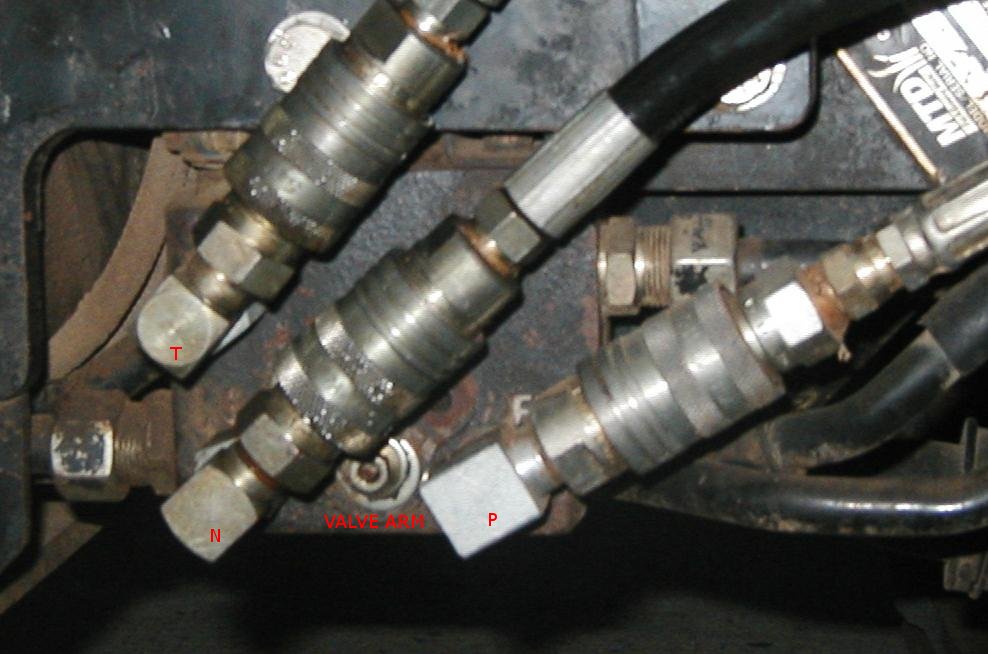

   / 3015hst loader hydraulics #5
The only thing I would add is that isn't where the disconnects are located on the Mahindra (at least mine anyway!). On mine, the joystick bracket is mounted to the part of the loader frame that remains attached to tractor, with the disconnects located directly off of the control valve (see attached picture). The connections on the diverter block do not have quick disconnects on them. I'm guessing your control valve remains with the loader when removed?
Sorry about the picture quality, it's part of a much large pic and happens to be the only picture of the tractor that I have here at work. If you'd like, I can take a few more detailed ones this evening and put 'em up.
Jerry
You have that exactly right. The diverter block looks identical. Now that you mention it, I suspect that the quick disconnects are probably installed with the loader and don't come with the base tractor at all.

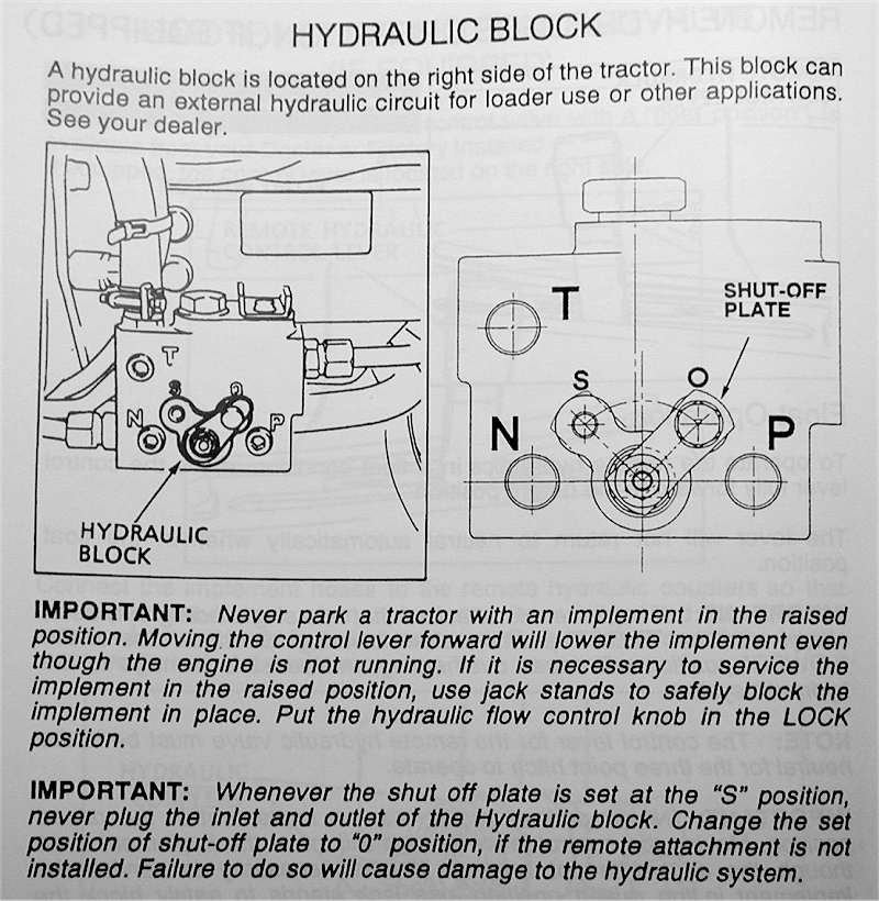

   / 3015hst loader hydraulics #7
To make up for the earlier pic, how about this?
Heres a picture from the manual (I don't own a scanner) of the page that describes the usage of the block. Pay special attention to the last note: if you remove the loader, you must move the lever back unless you like buying parts. /forums/images/graemlins/crazy.gif
BTW, if anybody needs more proof that these are last year's Cub Cadets (like there isn't enough already), heres my favorite: In the manual, on the page describing "Cold Temperature Operation" (page 49) there is this quote:
"4. TRANSMISSION HYDRAULIC FLUID - Use Cub Cadet Hydraulic Transmission fluid."
Looks like somebody "oopsied" with the cut-and-paste... /forums/images/graemlins/grin.gif
