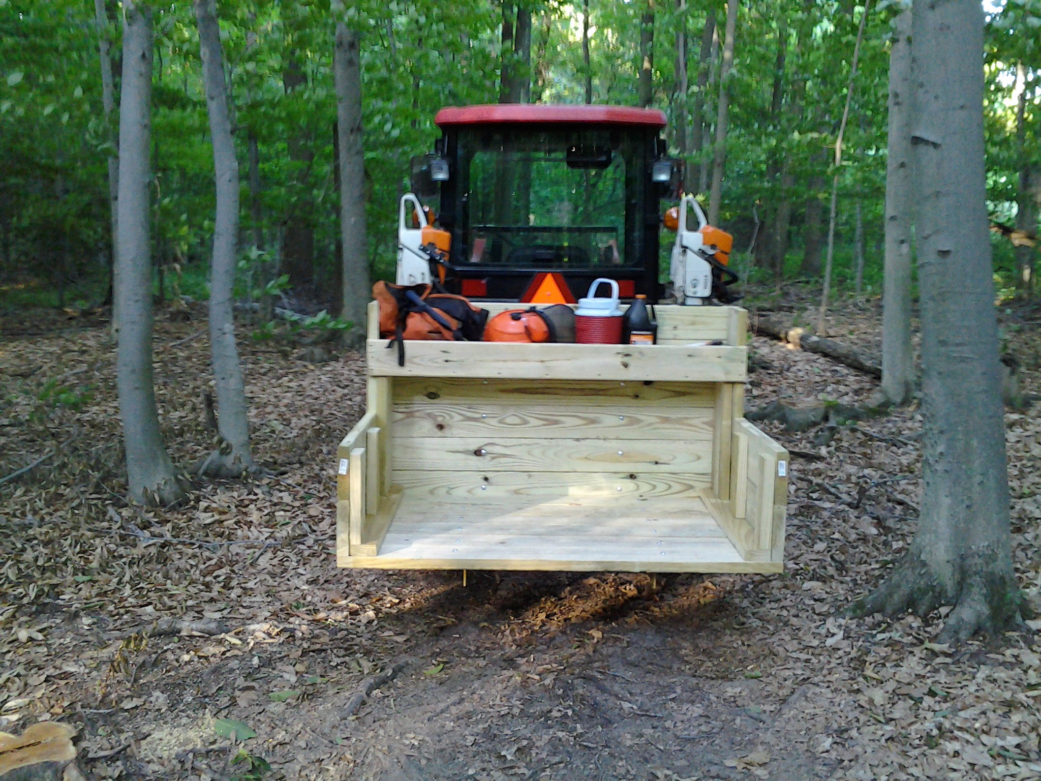

Well, thanks for all the advise; I really appreciate the thoughts and pictures.
I'll try this out for a month and see how it goes.
This is what I came up with for my rig; shop-floor slotted angle and four 2" rectangle bolts. I added 45 degree supports (1" slotted flat stock) from the sides of the tray to a higher point to each side of the ROPES bar, shortly after I took this picture. I left the bottom as open as possible to allow for debris and rain to pass through. I can put another saw (facing the other way), or my fuel and oil cans next to the bar. A bungee cord seems to hold the saw in place OK.
I have to figure out a way to stow the saw when I have the 28" bar attached; a manner that won't harm the chain or handle, perhaps a couple trunnion blocks made of fir. The saw pictured (362 with wrap around handle) equipped with a 20" bar.
I like your idea.
