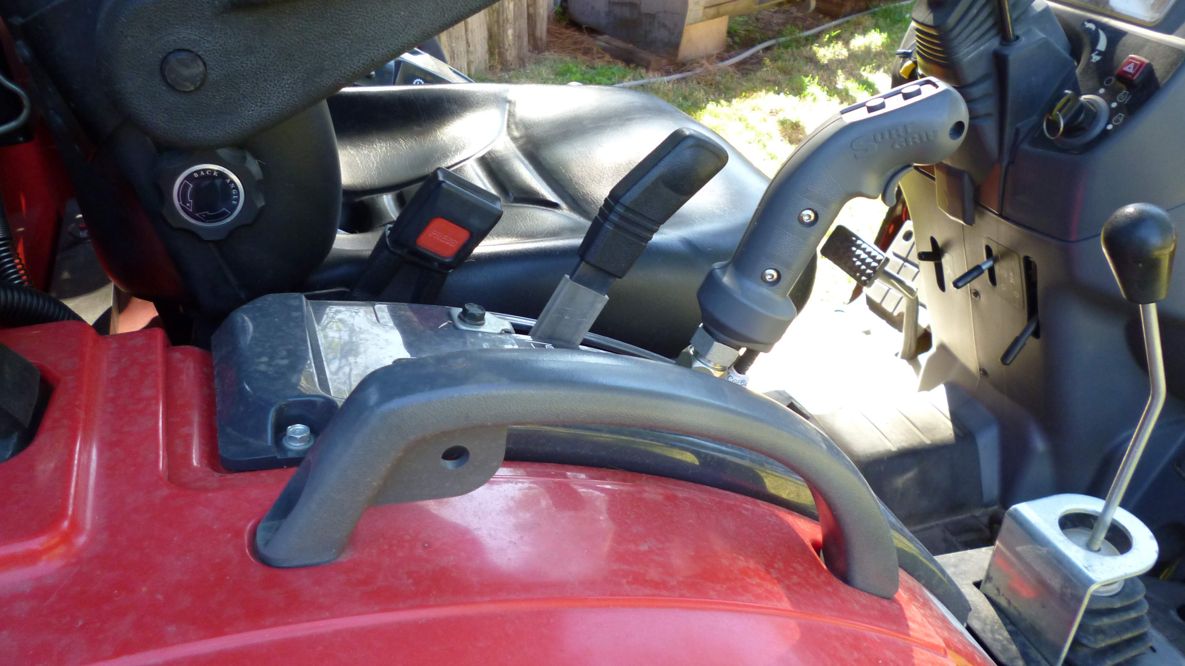

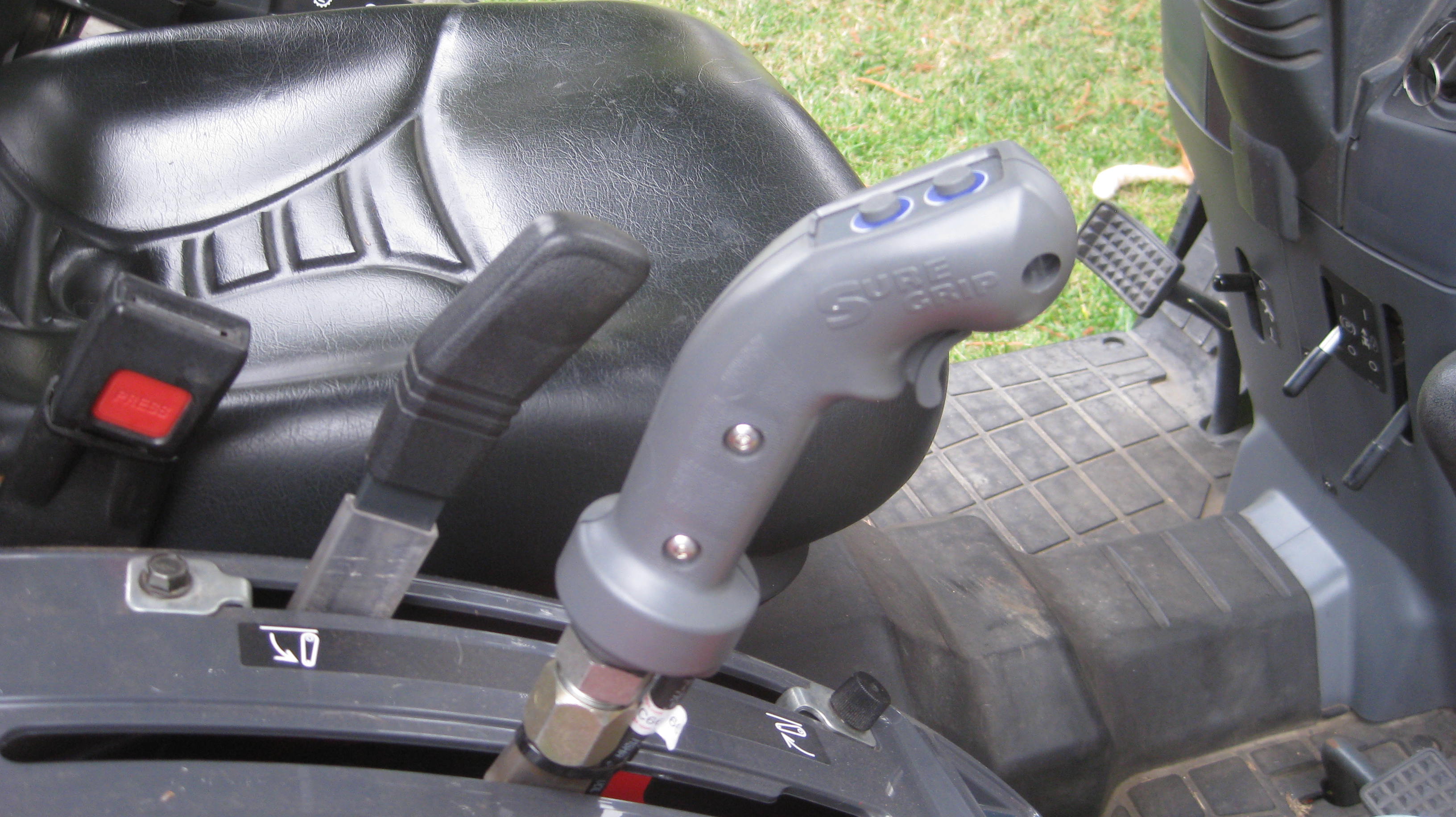

If you will be doing much grading, then get the single rear remote. $600 is more than a fair price for it. It is easy enough to add to that if needed. I have 4 on my 3215. ;)

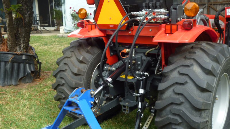

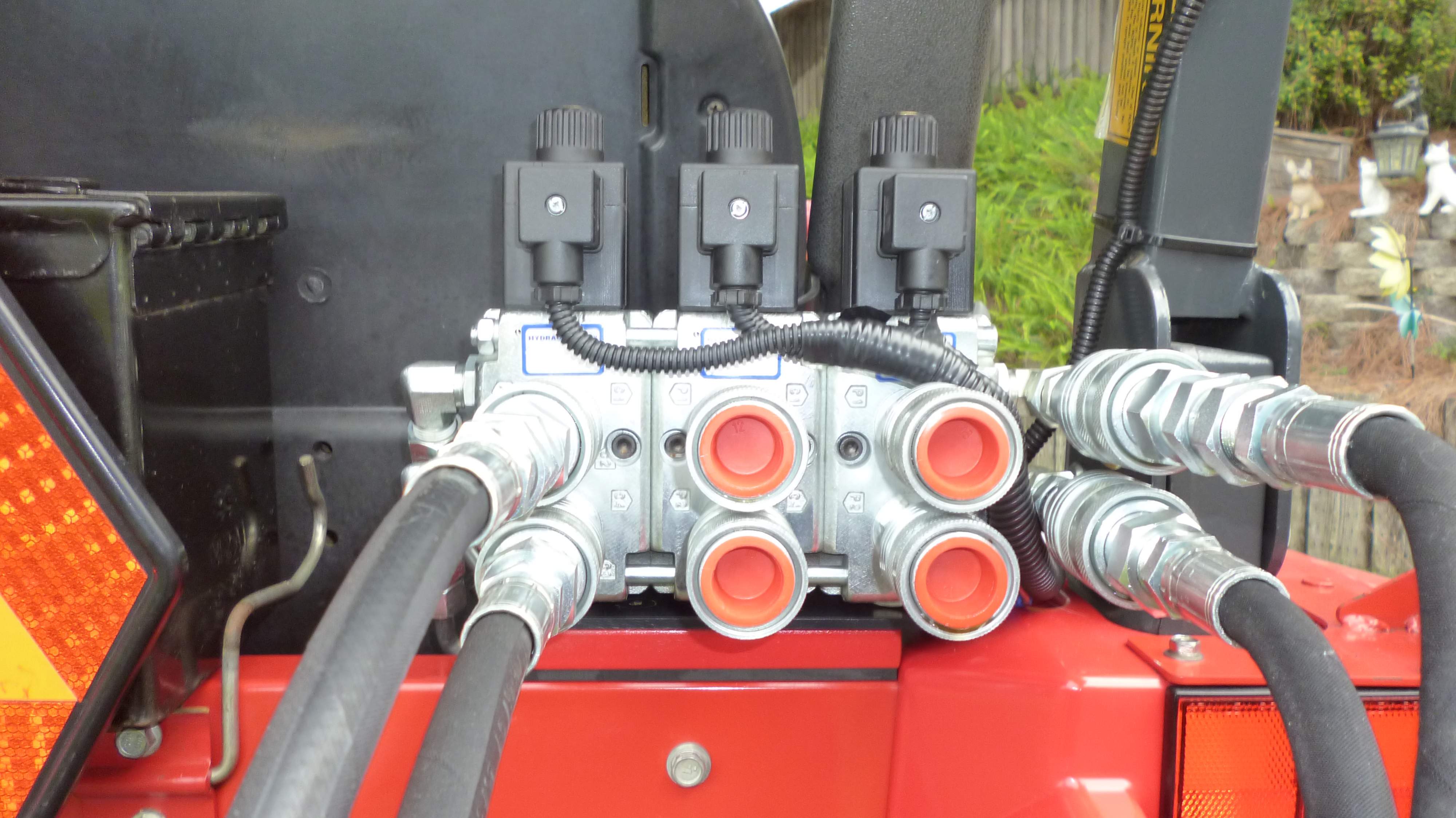

Lots of options with 4 sets! Did you just use electric solenoids to control flow from the one main remote? Is your single remote factory from Mahindra?
   / 3016HST, what options to add? #10
Yes, I have the single OEM rear remote and needed 4 sets, so I have a bank of 3 electric diverters. :cool: 2 for my "TnT" and 2 for the angle and offset for my landscape rake. I hope to have a nice rear blade for it one of these days also and that will require the use of 2 remotes. ;)
