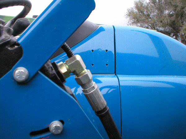

True 3rd function, or diverter? You only had the diverter when I got mine for my 7520. ;)
LOL not true! We have never offered a diverter.... but yes it's a diverter... actual third function is too costly... we have it for our big ag stuff though... we are working on our electronic valve kit now ;)
   / 3016HST, what options to add? #22
Jeremy, If KMW has NEVER offered a diverter valve, then how is it that I have Mahindra paper work for the diverter valve on my 7520 from 2004? :confused3:
Must be like these 4 holes in the cowel that have welded nuts on the back side. As far as Mahindra is concerened, this does not exist, and yet here it is. :laughing:
