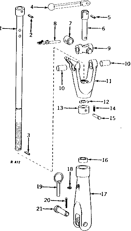

Hi Guys,
I have about a 1965 John Deere 3020 diesel. The lower arms on the 3 point won't go low enough. They work fine, I just need them to drop lower. I've tried lengthening them using the pins that allow the arms to extend but that doesn't help much. I know there are levers on the top by the seat and I think those are supposed to adjust the height of the arms, aren't they?
I'm using a middle buster to make a trench and the arms won't go low enough to make the trench as deep as I would like.
As you can tell, I don't know a lot about my tractor yet.

The levers I was talking about are the adjusting levers at the top of the lift link that runs from the 3-point arms upwards towards the seat.
   / 3020 3-point won't go low enough #4
If I'm understanding you correctly you referring to parts key #4 as the lever. Yes parts key #1 was designed to turn in parts key #17 to adjust how high/low draft links will travel. I'll bet they're stuck tight and a LOT OF HEAT will be the only solution.
Hi Jim,
That is what I was asking about. They aren't stuck (thankfully). I did some reading though and apparently there is only 1 1/4 inches of adjustment on those links and that's not going to be enough. I see photos where the lower rocker arms on a 3 point are almost touching the ground. Mine sit about 10 inches or more off the ground. Some of my attachments won't even touch the ground when I go to unhook or hook them up. I wish those arms would drop lower but I guess I'm stuck with the situation.

I sure thought there was more than 1-1/4 adjustment in the threads on the lift links.It's possible the control cable isn't traveling the full length of it's outside cover. As jd110 suggested put the L/D control lever in "D"
