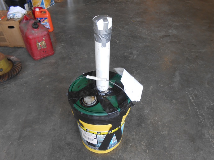

I'd suggest to send steering valve to Tim in Somerset,Ohio. He will reseal/calibrate & bench test for $350 IIRC. If you choose to do send it to Tim I'll get you his contact info.

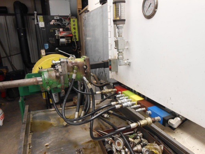

One photo shows a way to package(bucket) the steering valve for shipment and other photo shows testing a resealed steering valve on his test stand. Did I state that he's a very good JD technician?

Difficulty in R&R of steering valve is why I recommend for Tim to reseal,calibrate & ""test on his stand"". As far as I know Tim is the only technician that I've heard of with a test stand.

Having served as a JD dealer service manager for over 10 yrs during the heyday of 3020/4020's I can truthfully state that not all JD technicians can reset the valves correctly the 1st or 2nd attempt at least not down in Texas. I doubt a large % of current JD technicians have resealed/adjusted a 3020/4020 steering valve.
