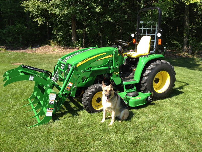

I took delivery of my 3320 a few weeks ago and am loving it. I looked hard at the 2520 before buying. One of the biggest things that pushed me into the 3320 was the scissor style deluxe seat! After going over a few bumps with both tractors I knew my back would be paying for the 2000 series. I jumped over the e series tractors because I wanted to remove the loader and have the option of a back hoe in the future. Plus it seemed like the 3320 had a few more nice features. I couldn't be happier with the 3320. Also, as far as financing goes.... I would go new and take advantage of 0 percent for 5 years. The best rate I could get on a used was 5.4. In the end, I would have been paying more for the used.... And who doesn't want a new tractor! Here is mine... MX5 brush hog is on the way.
