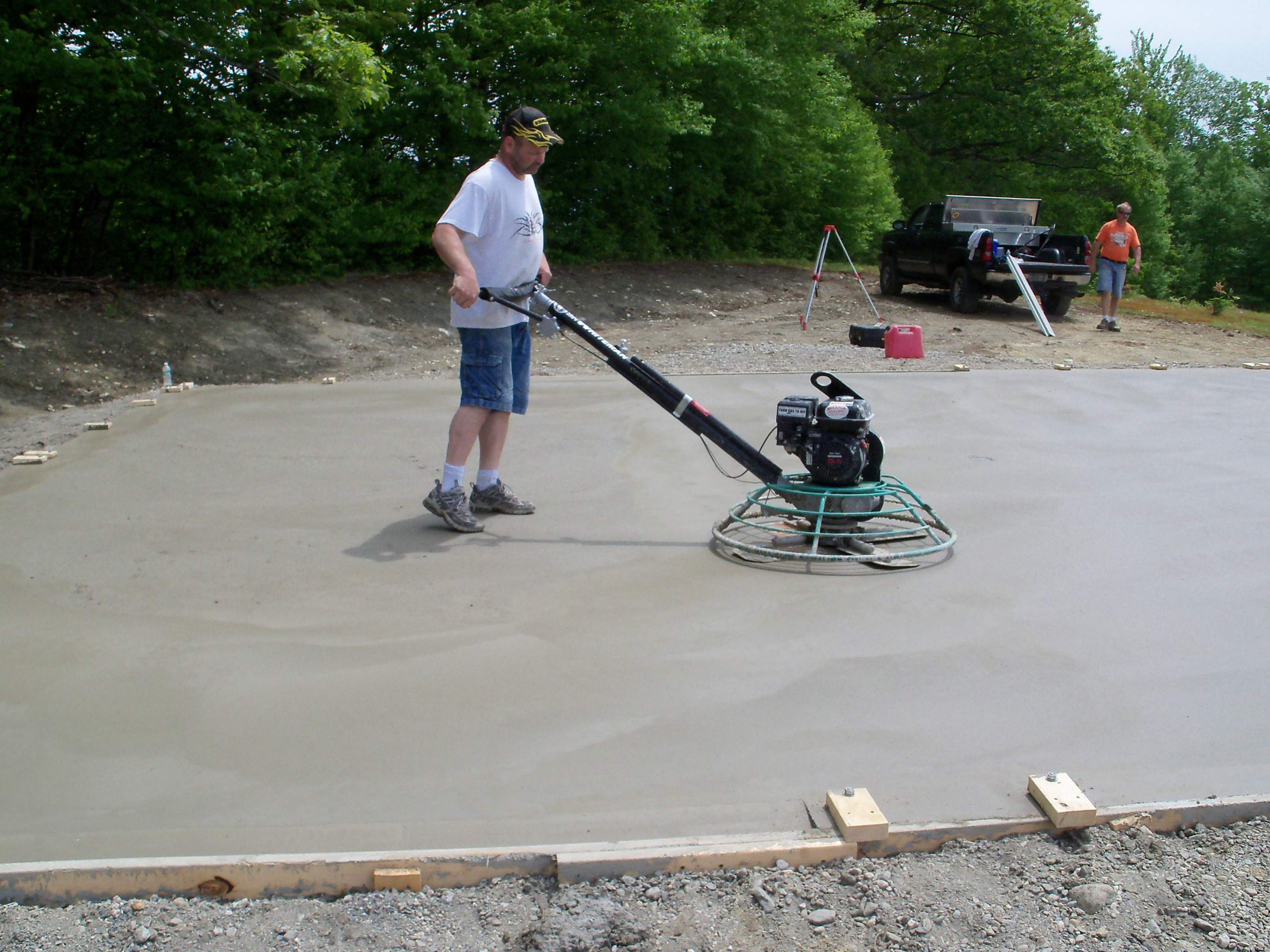

Good Mornin Rodney,
We pretty much did what Dave suggested after using our power trowel, and our slab came out exceptional !
To date I have not sealed the concrete slab yet but hope to this fall before the cold weather hits... I would use this method again.
We also sawed our 28' by 42' slab about an inch deep into 9 sections to prevent any cracking down the road, I would also do this again, to date no visible cracks ! ;)
