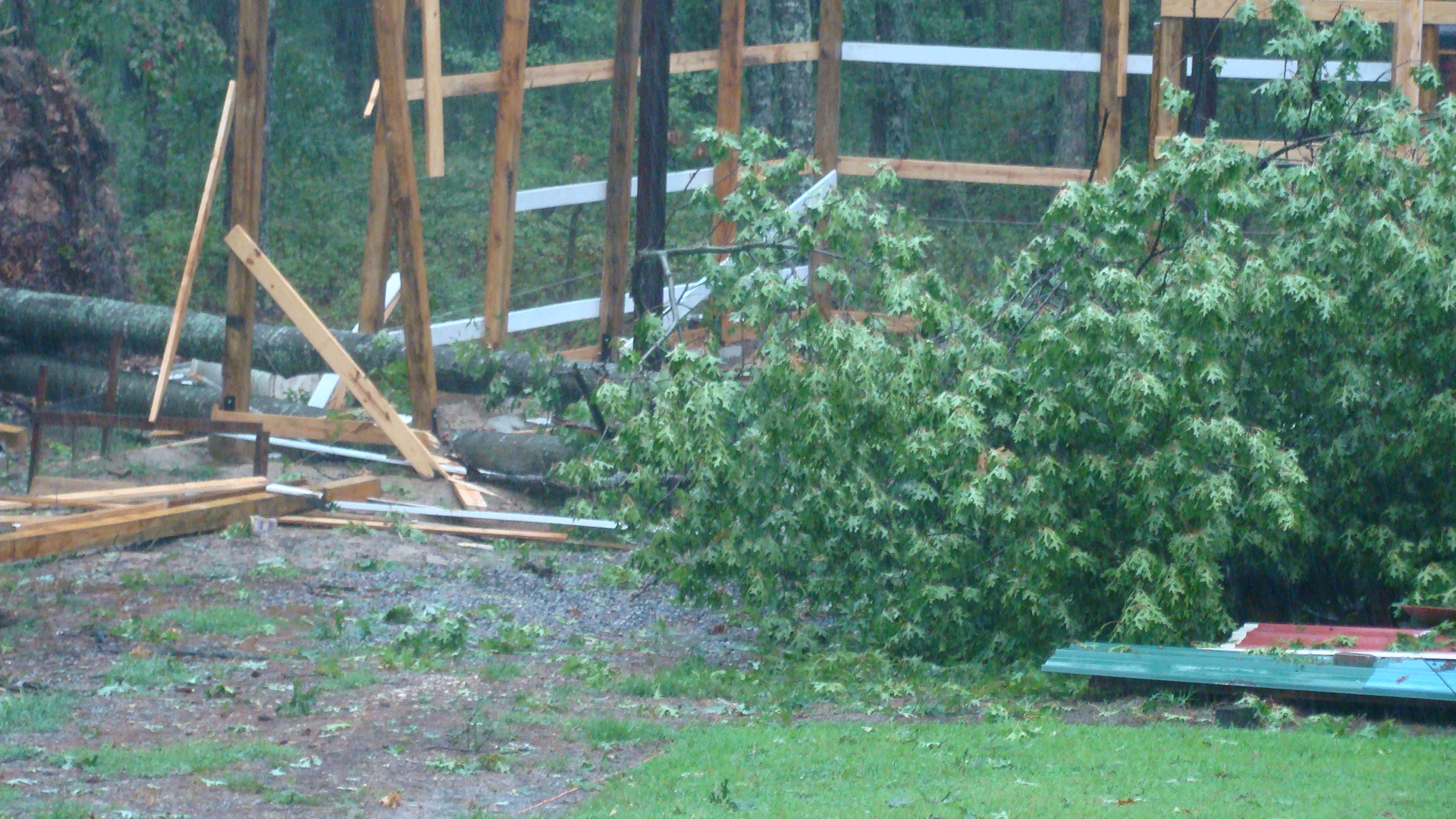

I know this is an old thread but I came across it yesterday and it got me to thinking. The storm we just had knocked one corner and a wall down on the pole barn I am building. My post that were knocked down didn't snap off the anchors that were screwed into the concrete footing pads were just ripped out of the concrete.
I had thought about using these post protectors also as I too worried about the post rotting off after time had taken it's toll. But now looking at these pics I'm glad I went with just attaching them to the footings with my home made connectors. I might be missing something though......but it looks to me like putting them in these protectors then screwing those anchor screws with the rubber washers into the post then covering them up with concrete would be a bad idea if you had luck like mine. How on earth would you ever change a post if something like what happened to me? Or if your wife gets mad at you and tries to run you over but misses and takes out half of your shed before she realizes she missed.
I hope something like this never happens to the op and probably once everything is up and all tied together with proper bracing the structure maybe would have been strong enough to keep the post from breaking off. I was just wondering what you have to do if something like this happened. I looks to me like you would have to rip up the concrete to get the screws out so you could pull out what is left.
