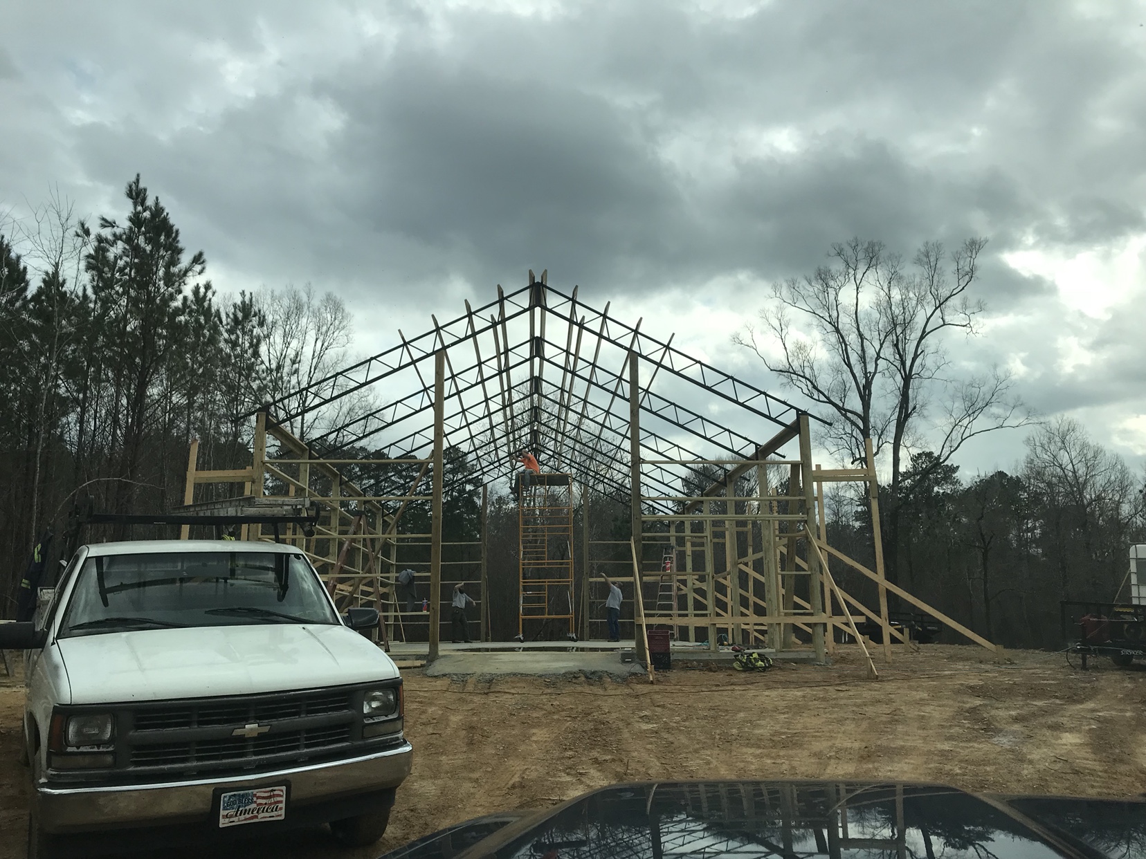

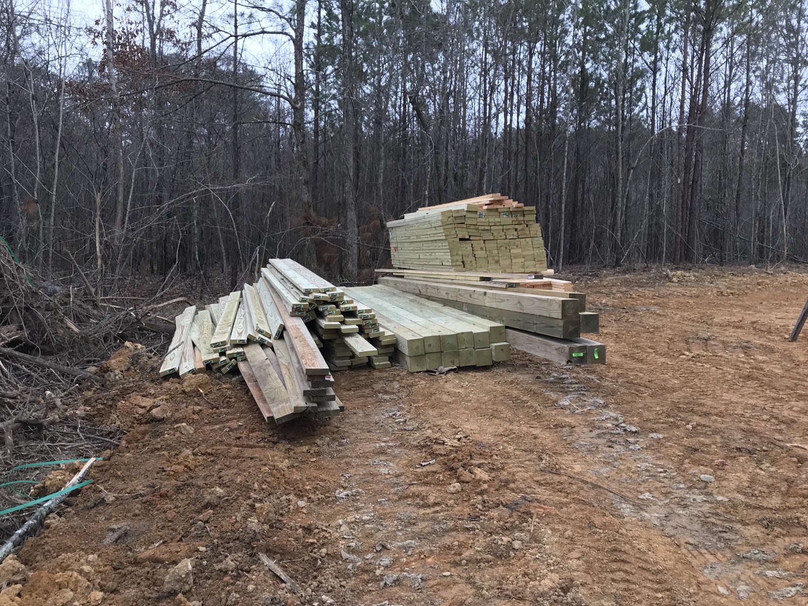

Pole barn "kit" arrives

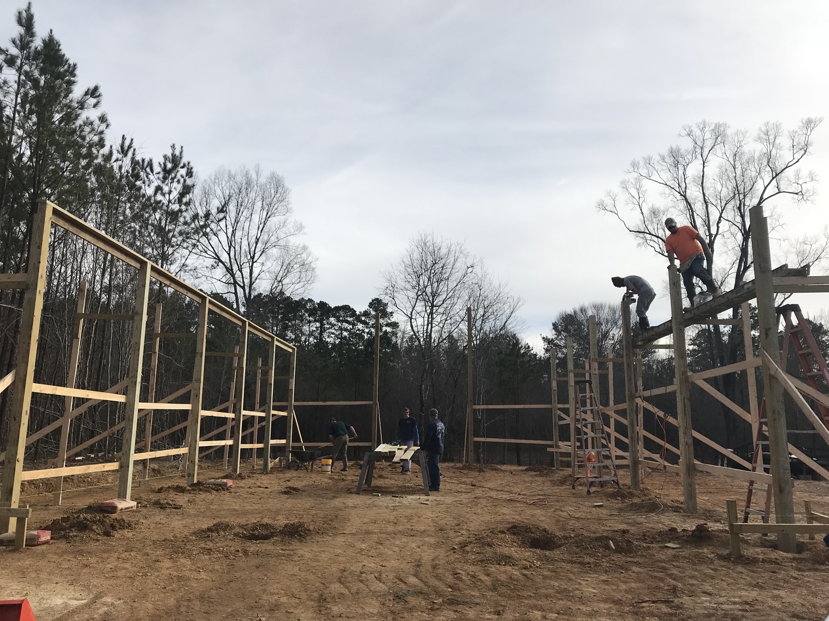

Took a few weeks to get the poles in the ground because of rain. The crew that's building it only builds on Saturdays.

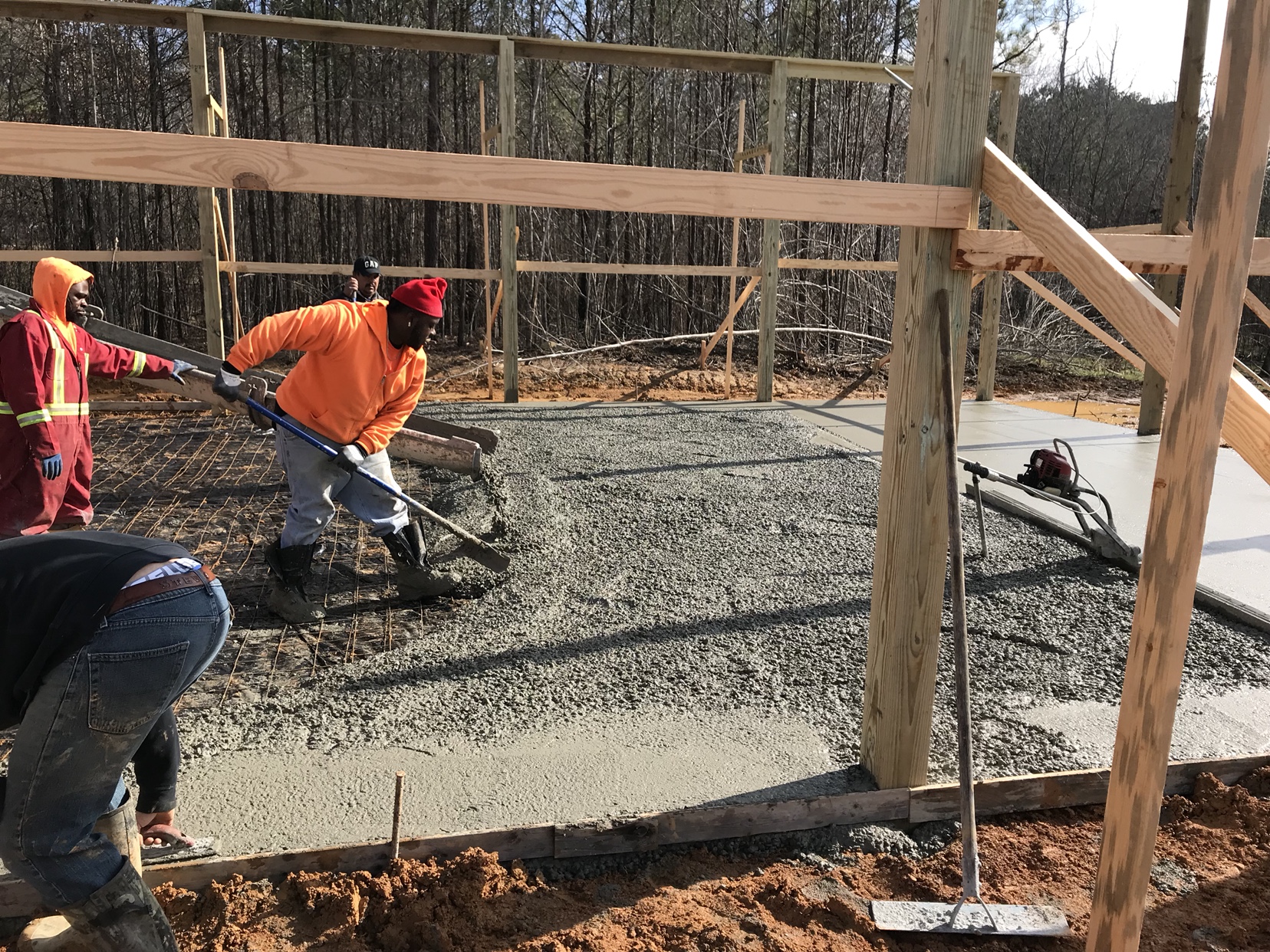

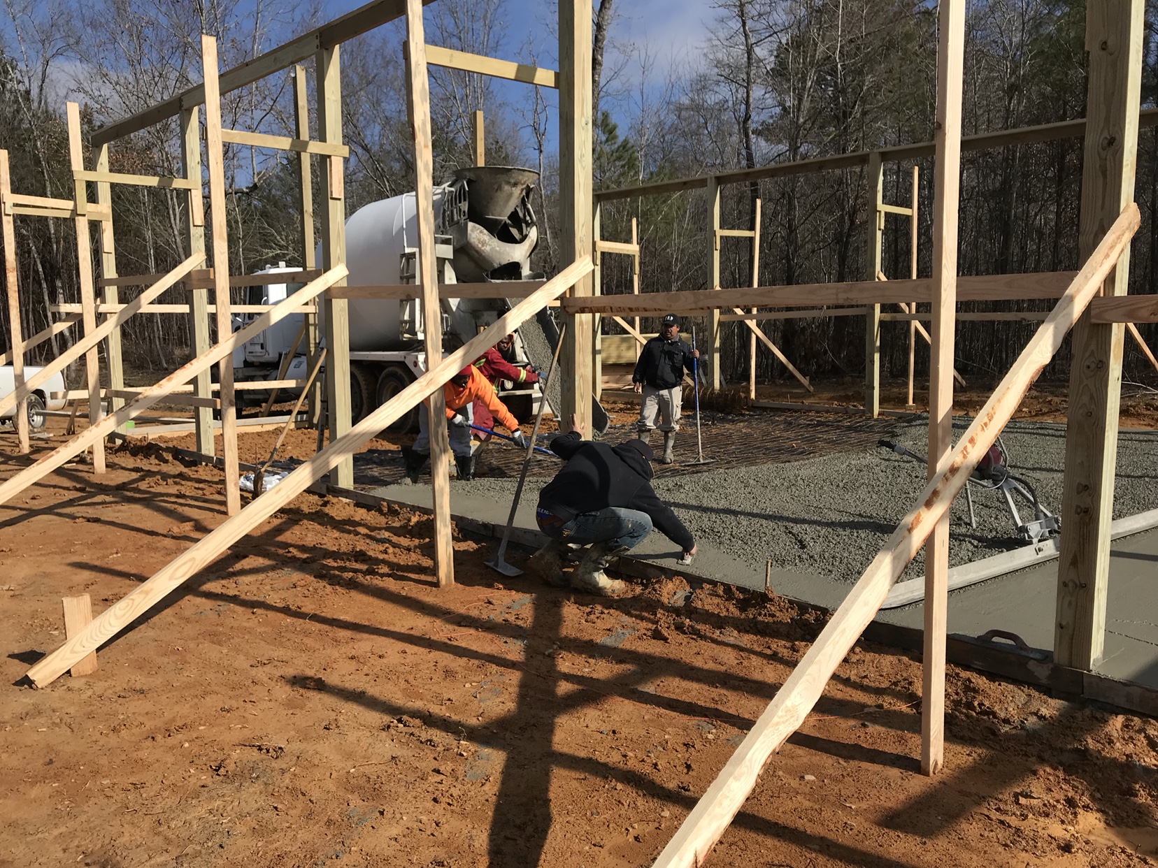

The concrete is a 5k PSI mix. It was supposed to a 4" slab but because of reasons, it averages about 6".

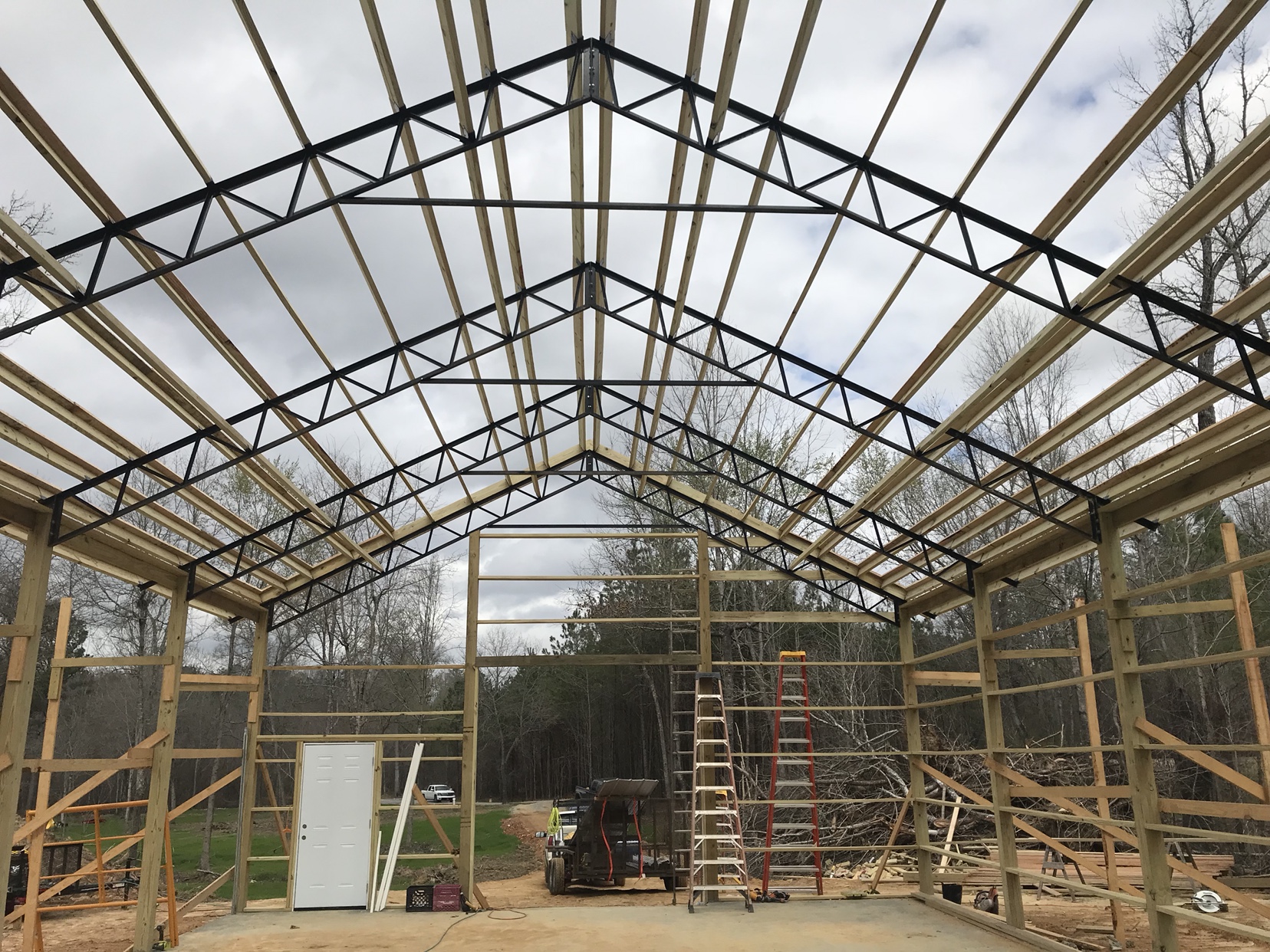

Steel trusses going up.

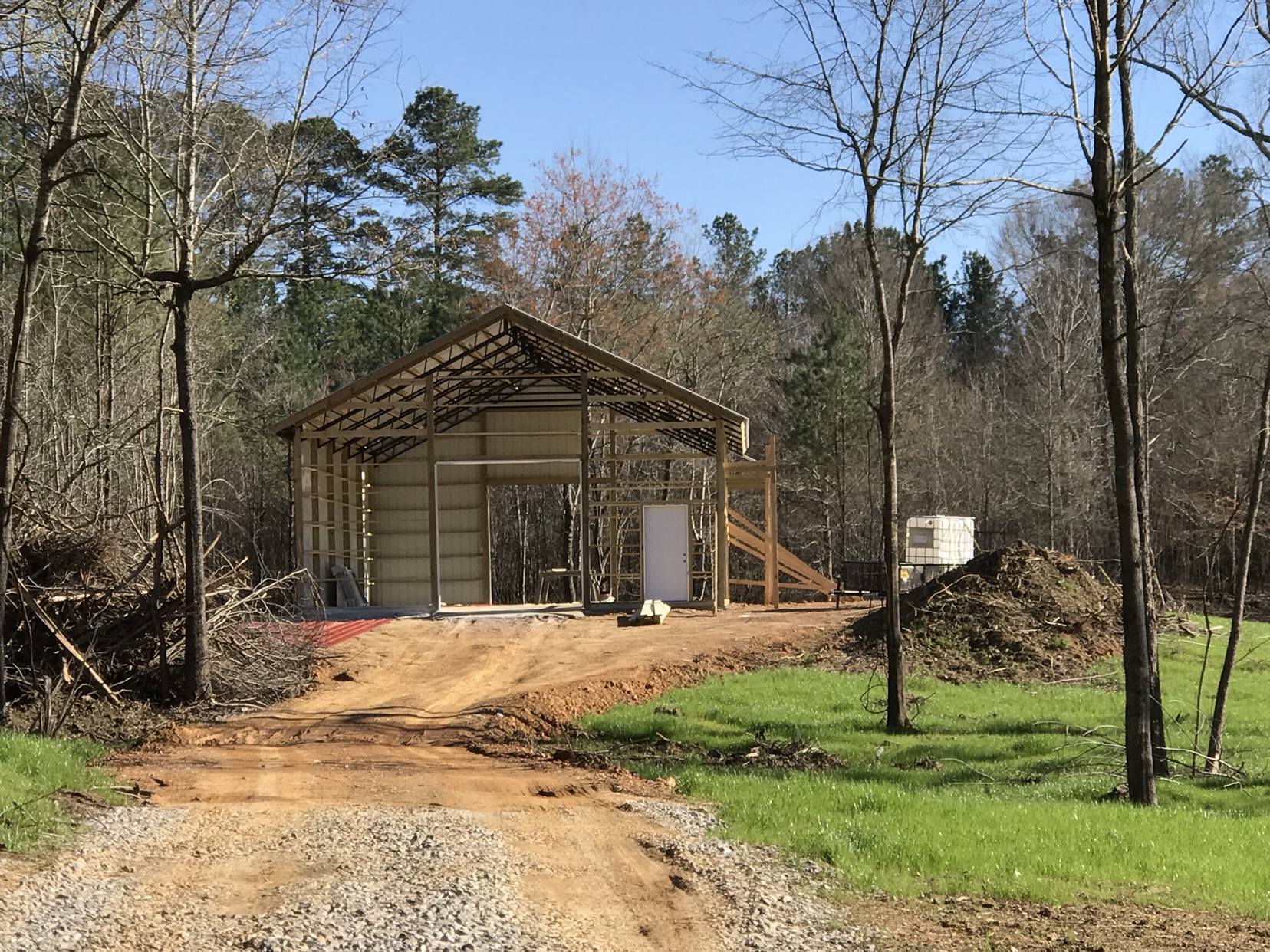

Roof metal about done

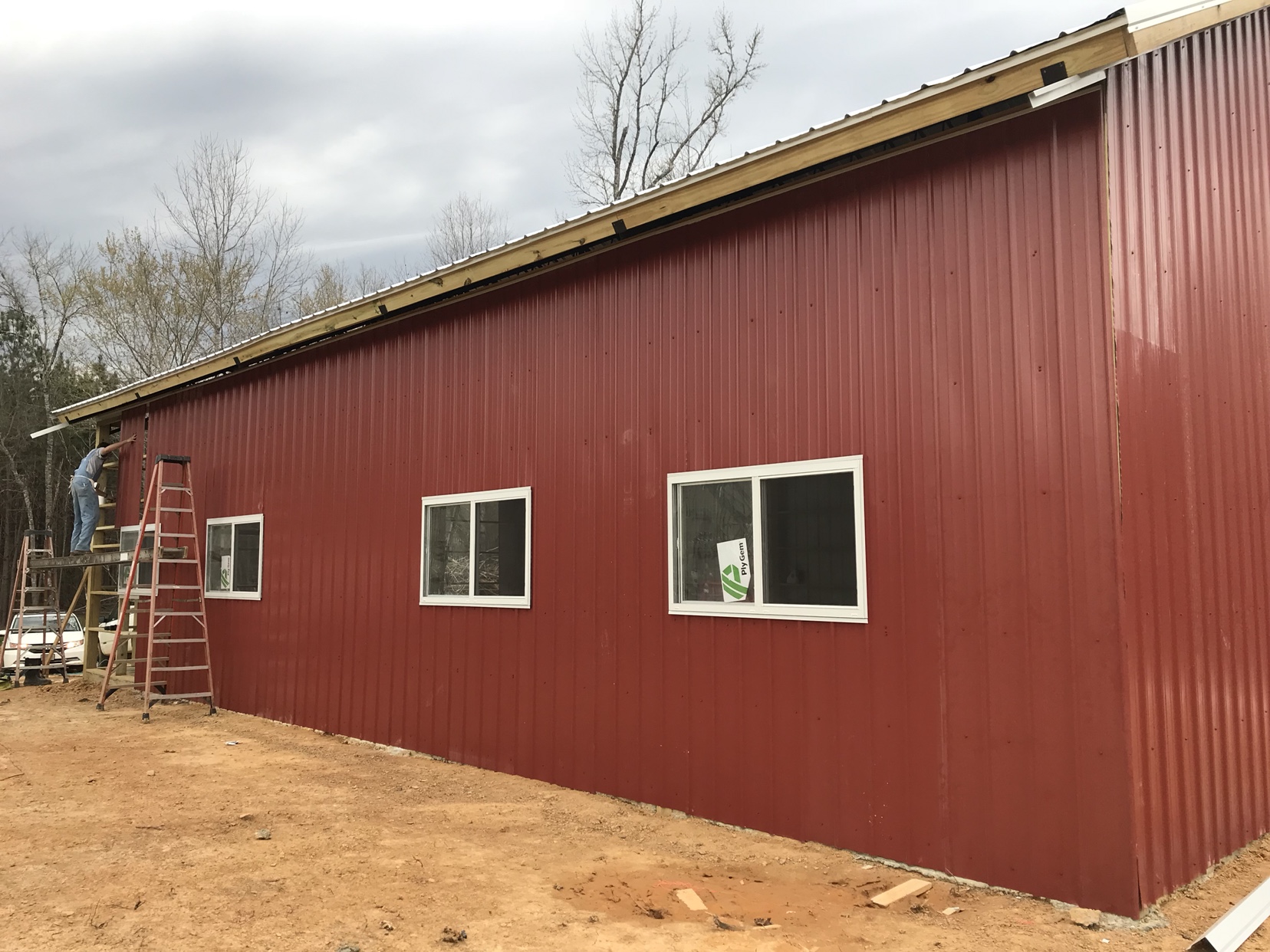

Wall metal is progressing.
Last few pieces of wall metal.

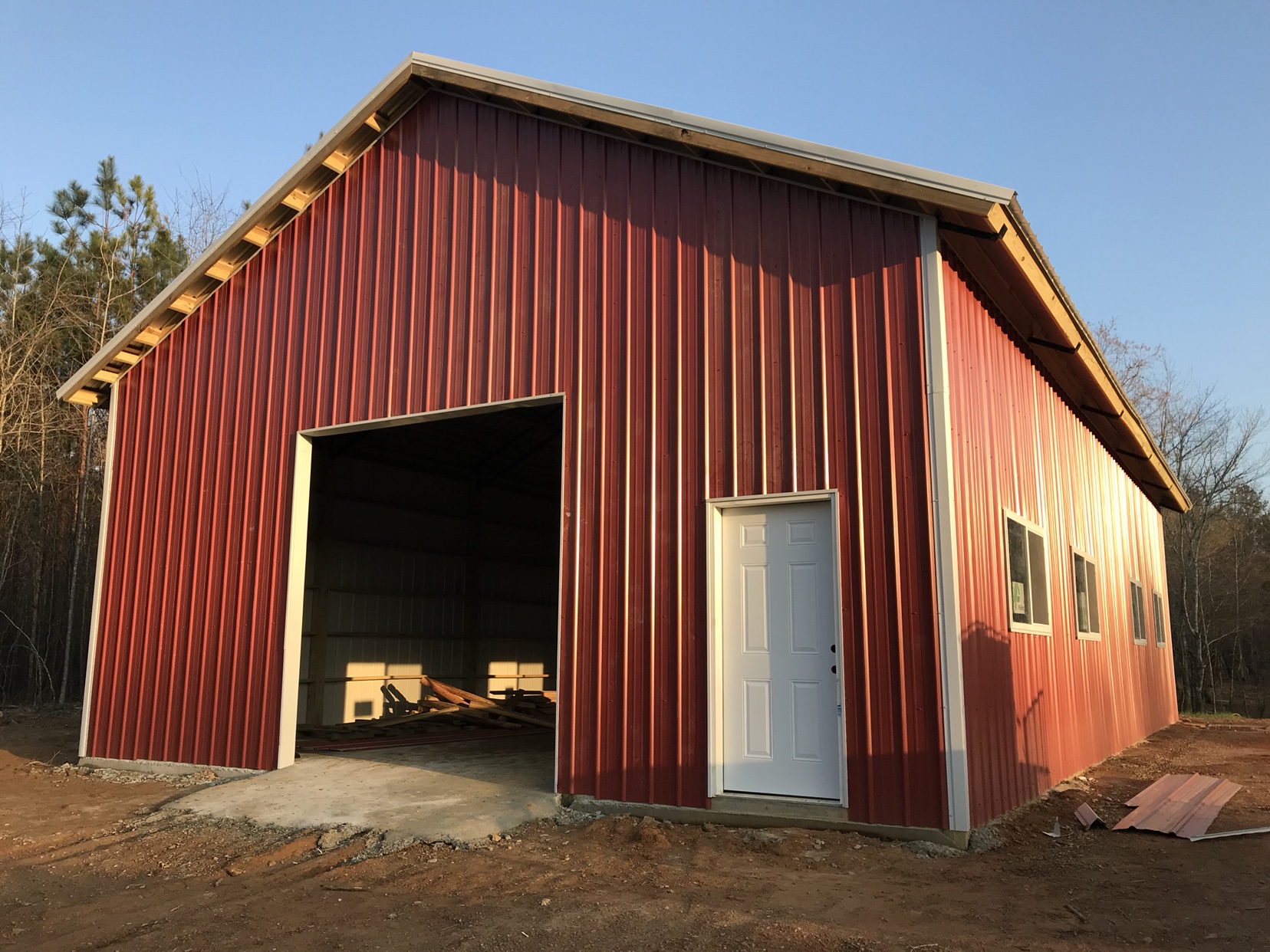

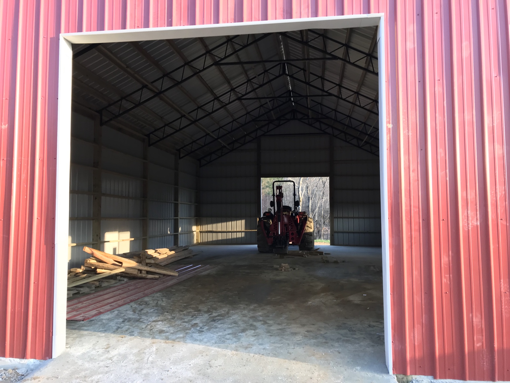

Finished!
Tractor finally has it's home.

We'd planned on 21 yards but it took 31.

Congrats on your barn. I've gone back and forth on getting those trusses, but the added cost and travel time means I probably wont.
Why did you go with wire instead of rebar in your slab? Did they pretend to lift it while spreading it at first, or did they just keep it on the dirt the entire pour?

The metal trusses are way better than wood!

31 yards for a 30 x 50 , how thick is your floor?
Well...the barn pad was graded level and marked by our excavator. He marked the 4 corners and leveled the inside. When the guys showed up to start setting posts, they got off those marks. They rotated it around one of the corners by a few degrees. Well it was enough to throw off the grade by some amount. So that accounted for some of the extra concrete.
When they dug the holes for the posts, they had some equipment issues so what started as 12" holes 4 feet deep ended up being probably 18" holes about 4 feet deep. So when they poured the floor, concrete filled in the rest of the holes around the poles. I'd guess an average of 18-24" of concrete in each hole. So there's some of the extra concrete.
And finally, we were playing beat the rain to get it done in the first place, so we had a few days between rain showers. What started out as a nice hard dirt barn pad that was cut from a small hill turned into good bit of mud when you drive full cement trucks on it. So as one truck would leave, they would shovel out the ruts, making the floor thicker in the process. So there's the rest of it.
So as far as thickness...the front half of the building the floor is 6-8". The rear half is 4-6".
I went with wire based on recommendations from other professionals in the area. And the wire was much cheaper than the rebar.
They pulled it up as they went. I spent the whole day watching them prep, pour, and finish the floor.

Sorry to hear this. As a contractor, one of the biggest red flags that I encounter is a concrete guy saying that they can pull up the wire, or rebar as they go. As you can see in your pics, it doesn't happen. Wire is 100% impossible to pull up and then walk on and keep inside the concrete. Rebar has a chance, but in every slab that I have cut open, it's laying on the dirt or plastic, not doing anything.
Wire is OK for walkways where you can keep it in the middle of the concrete and not walk on it. Rebar on chairs is the only way to do a big pad.
What's done is done. Cracking is mostly from too much water and the rebar, or wire is mostly there to hold the cracks together so you don't see them. When it's in the middle of the pad, it does a great job. When it's at the bottom, it doesn't accomplish this. If your pad was poured with as little water as possible, you shouldn't have any issues. You will know for sure in about a month. If there isn't any cracking by then, you're fine.
While I'm sure it's not perfect they did get some of it pulled up.
The floor was poured on Feb 5th and there's been no cracking so far.

Truss tails are supporting eve overhangs? Sealing the floor with a high solids product pays dividends. Not a fan of silicone or water based sealers, High VOC's, solvent based will always be superior in performance. Could not tell if you cut control joints in slab?

The truss tails are the eve overhangs. I'll look into the floor coating. Only having my tractor in there right now I can already see that keeping the dirt out is going to be an issue until I get water run to the barn.
