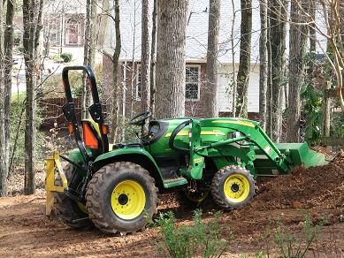

I'm liking this 3120 more and more. The more I use it the better I like it. Hopefully by backhoe will be here soon.

I was origionally looking at a 4115 but the dealer said for the price difference I could get the 3120 so I did. all the talk about the 3120 being weak is not true. 2 to 5 HP difference in the other models does nothing for me, its nothing you can feel. an upgrade to me is going from the 30 HP class to the 40 or 50 HP class. the 3120 is a tank, unstoppable. you dont get a real upgrade unless you go to the 3720.

I'm looking at the 448 Hoe with an 18 inch bucket. another thing I really like about this tractor is that you can switch the tires for a wider stance which I havent done yet. The FEL plows hard clay fine but this tractor needs ballast, its a little danderous on slopes with a full bucket and no rear ballast (which I guess is true with any unballasted tractor). sometimes it breaks traction due to no ballast. but I dont have real aggressive tires on it either (just R-4's).
I'm also looking at a grapple bucket as well. It pulls a middle buster great thru hard clay. I must say this tractor is impressive. that load match feature is very impressive. hope I've answered all questions. One recommendation would be wheel weights if no rear implement will be installed immediately.

yes sir, filling the tires or wheel weights or a ballast box, some of my breakout force is translated into a rear wheel lifting off the ground. I almost rolled it down a hill one time but I dropped the bucket and stopped that. The seat is still pinched up. /forums/images/graemlins/shocked.gif
I do recommend careful consideration of some form of basllast with this tractor to get the most from it depending on what you use it for. But truely, I have only good thing's to say about it at this point. I am pleased /forums/images/graemlins/grin.gif
